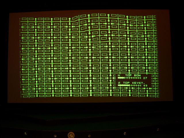

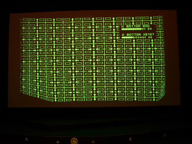

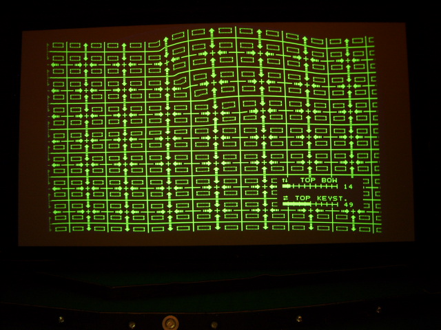

Hello, recently able to set the geometry especially on my 909 N / S here is a small area and distorts the pattern
look at the picture
thank you

Posted: Thu Oct 11, 2012 12:37 pm    Post subject:
Most likely a bad system board. I've seen that before. try a very low resoilution, like 640 X 480 and see if the problem still happens. If not, and if it only does it at about 1080i and above resolution, or if it does it at all resolutions, the system board is bad. Impossible to find, and $3500 from barco.
I did just buy 3 909s here, and I may be parting one of them out when I get home in a week. Not sure yet though.

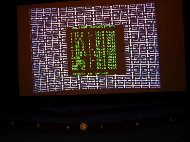

Posted: Fri Oct 12, 2012 12:28 pm    Post subject:

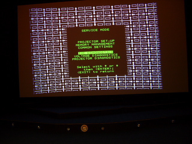

If the controller would be dead you would not have a chance to start the Barco.
Do you have access to all the menues? Please post a shot of the voltage section.
ElTopo

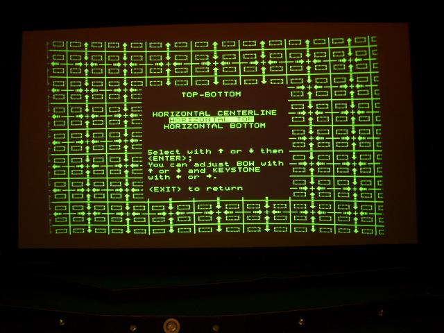

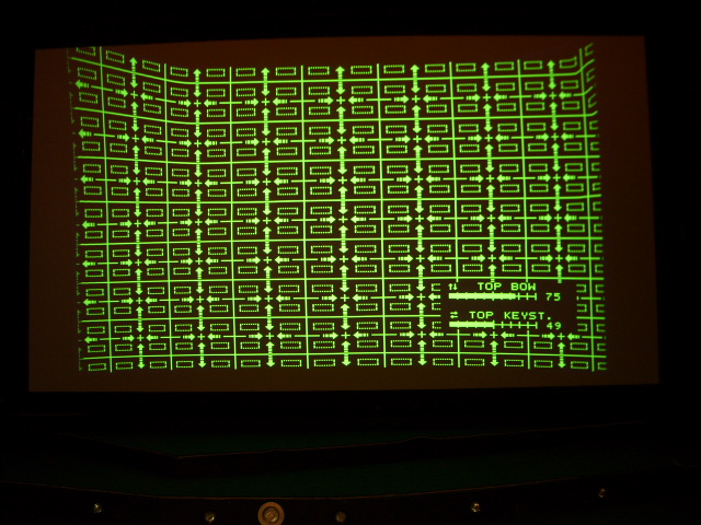

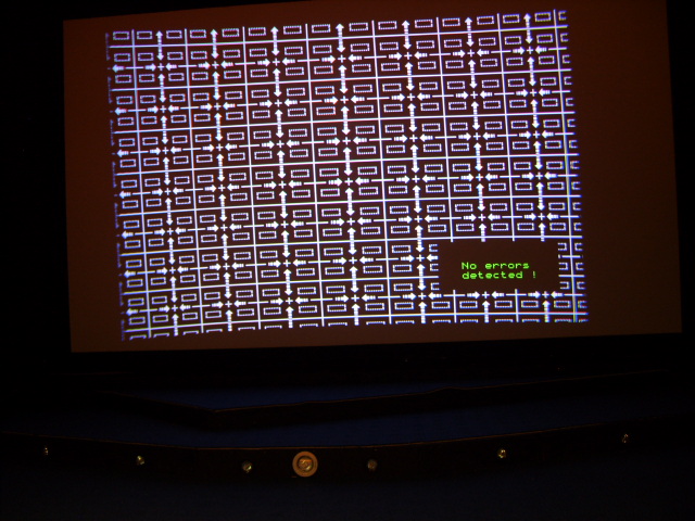

Posted: Fri Oct 12, 2012 2:34 pm    Post subject: 909
Hello, yes I acced all menu
here are my results:
right side bow, no problems
right side Keyston no problems
Left side bow, not impossible
Left side Keyston, not impossible
Bow and Keyston not impossible up and down like the photos.
Focus digital settings can not

Posted: Fri Oct 12, 2012 3:06 pm    Post subject:
To me it seems +9V is out of specs, not sure if is it critical -probably not.
