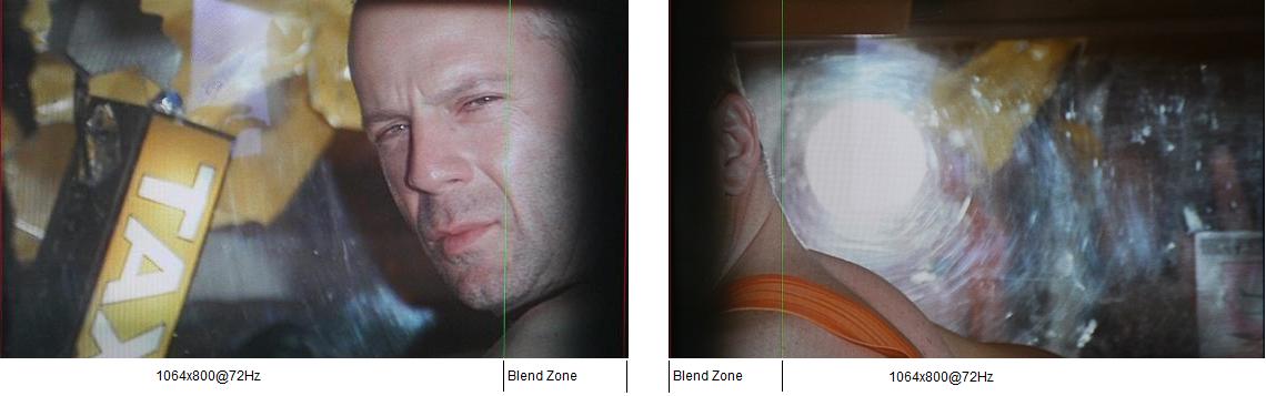

First try with the TV one's into my CRT monitor from Sony with two vga inputs.
Left and right have to be converged in realtiy of course
ElTopo Thumbs Up

Posted: Wed Jan 30, 2013 3:22 pm    Post subject:
Nice!!!!
Looks like you'll have no problem when you use the PJ's.
Except for matching them Wink
ElTopo
Joined: 07 Nov 2006
Posts: 1640
Posted: Wed Jan 30, 2013 3:31 pm    Post subject:
Thanks Mr. Green
That was my intention. Prepare them for use with the projectors plug'n play.
cheers

ElTopo
Joined: 07 Nov 2006
Posts: 1640
Posted: Wed Jan 30, 2013 3:34 pm    Post subject:
Where is the biggest prob ?
Converging the two ? or the blend zone ?
Barco Cine 9 the one and only
Posted: Wed Jan 30, 2013 3:55 pm    Post subject:
Blend zone. Gamma and grey scale have to be perfect on Both PJ's especially on the edges of the tubes that are in the center of the screen.
