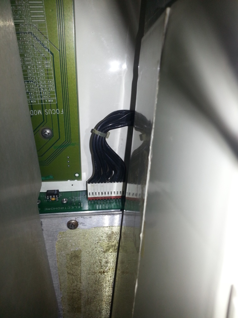

2 weeks ago, I had a big headached as to why my Vision 1 was unable to fire up. I had changed almost every boards from my 2nd set of Vision 1 including the motherboard but still couldn't fire up my projector. Embarassed
The only board that was not change is the backplane. Just before I decided to teardown everything apart to replace my spare backplane, I check every cable connectors to ensure no loose cable but still unsuccessful. Crying or Very sad
However, my vision 1 start firing immediately after I start to push up the HVPS cable connector that connect to the backplane. When you released, it stop firing. Therefore, I decided to lightly bent the connector downward and again it start to fire and till now, I do not have any issue with my Vision 1. Wink
Maybe you could try this method and hopefully, your Marquee had the same problem as mine.
GOOD LUCK!!! Laughing Laughing Laughing
