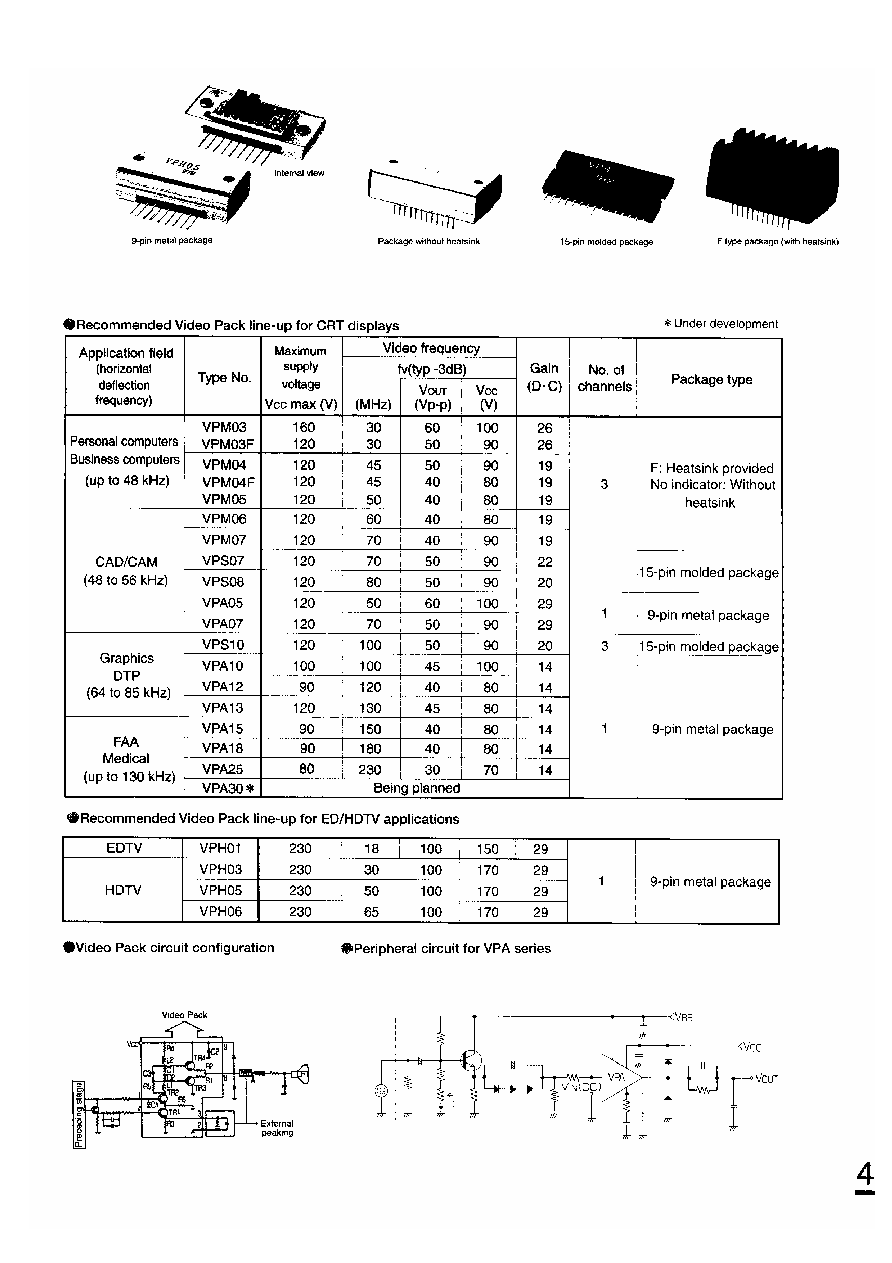

They did a preselection in the factory: the better performers got higher rates, the worse ones speced at lower rates, .
Are you saying.... that you think these are all the same manufactured part and they are assigned different part number based on their individual performance tests?
Are you serious? I think most of them are the same, of course some of them are differently constructed. referring to your post if a 65MHz speced ic could do 100MHz then why not selling it as a 100MHz part what you could sell for more money. But if a specific IC can do of say 75MHz they can not sell that as 80Mhz, so they sell as 65MHz. The test what they did in the factory (if they did at all) were either not precise enough or they must have produced a certain number of every type per day, so it could easily happend that higher quality chip was speced at lower rate. The 160MHz as maximal bandwidth maybe was the absoulte maximum that they could reach with that specific design.
If you look at the attached videochip overview you can see that there are groups with exactly the same specs except for the bandwidth, for me it's a sign, of course I could be wrong.
But whatever is the truth we can only say that the chips in PG plain, and PG plus are specified at 65MHz typ; we have no certain information how they performing in reality. The only thing what was majorly redesigned (regard of the RGB line) between the transition to PG xtra was the Video output driver stage, and the neck board in the PG xtra performs noticeably better. Also the chips are in the PG plain and plus could be any good, but the chips in the PG xtra are much better without doubt.

Posted: Mon Nov 12, 2012 5:59 pm    Post subject:
WOW...I mean wow. You actually believe that all these chips are manufactured the same and as they come off the assembly line they are "each" tested and then given a part number based on their tested performance? No internal modifications or differences in manufacturing process or materials? WOW.... I mean wow.
First you guys are saying the advertised speed is it's maximum speed and when I show you other wise you change it to something else. And that is they are all the same.... WOW..... Shocked
Posted: Mon Nov 12, 2012 6:15 pm    Post subject:
Mac, have you already disassembled any Sanyo video amps? They were manufactured with some sort of thick film technology, with this every, I mean EVERY part is trimmed individually, during trimming it isn't hard to perform a fast quality test.
Note the circuit configuration is the same for all.
Posted: Mon Nov 12, 2012 6:36 pm    Post subject:
Mac, please note that this is my thread, and I wasn't saying anything on your comment on 'that 65MHz is more or less?' until today, so I did not change my mind Wink
I said 65MHz for the VPH06s, and calculated with that, because that is the only thing what is SURE about them. Mac, do you have any evidence about how good performing VPH06s were used in NECs? Because I don't, that is why I referred to it with it's advertised specs, did I make a mistake?

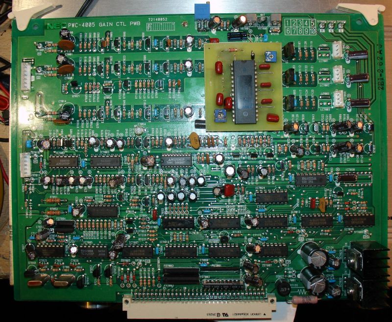

Posted: Sun Jan 27, 2013 4:40 pm    Post subject:
Slight update, the new experimental CTL board is ready, hopefully I can adjust in the next few days or so.

Ok, the work has been done. The board and the concept works in general, I made to fit the CXA1779 in place of the CXA1209, without the need of recalibrating the whole machine. However, I'd lie if would say the new board looks better, but it's not worse either (at least), they do look exactly the same to me.
Also as usually an unforseen side effect occurred in the new board: somehow it doesn't like if any portion of the horizontal back porch is blanked out, otherwise it will streak badly and shifts the color balance, which I may try to eliminate later or may not.
Of course these are only first impressions, I'll throw the board in normal use, and further testing will come.
Posted: Thu Jan 31, 2013 2:52 am    Post subject:
