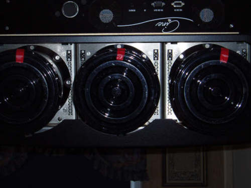

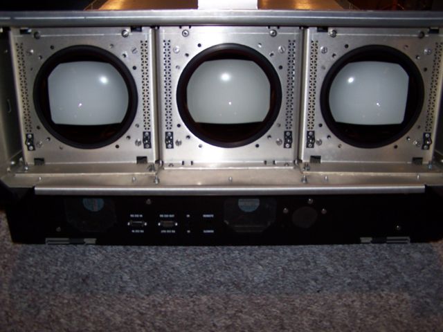

I have a friend who has 2 cine9, the fans are mounted as in the photo ElTopo
they are reversed on the two projectors
I wonder if this is not mon909 they are fitted incorrectly?
Other 909 owner can watch their projectors?

Since the Cine 9 is MUCH quieter than the 909 the cooling system has to be very different in the 2 projectors.

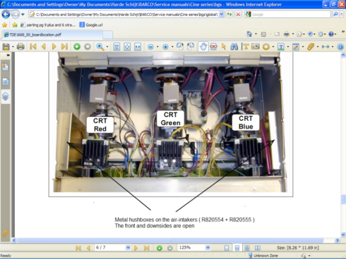

BR909 owners are always trying to make their machines less loud. And you can, without doubt. Till they became dead silent. Serial or parallel resistors, super silent PC fans, Cine 9 software flash and so on.
As Mike Parker said several times, the fan circuit in those projectors are too complicated to mess with. The clever controller in those beasts keeps an eye on the temperature of the electronics and speed of the fans. It is not easy to slow down the fans without increasing the temperature. I think we have few options:
1. Learn to live with the noise an 909 produce.
2. Use a vented hushbox.
3. Reproduce the fan circuit of Cine 9.

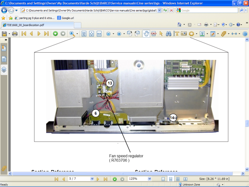

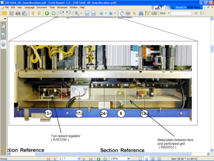

Third option is the best if you ask me, but involves more than a software upgrade. While Cine 9 use the same fans as 909, three major modifications were done to make it silent ( 32dbA @ 1 meter distance ):
1. Software limitation of upper scanning frequencies ( 132KHz horizontal instead of 180 on BR909 and 210Hz vertical instead of 240 ).
2. Two fan speed regulators R763706, one for the fans in the convergence tray and one for left and right back fans. The middle-back fan remains temperature controlled by the SMPS.
3. Metal baffles were mounted on the back ( between the fans and the perforated grille ) and sides to reduce air turbulence.

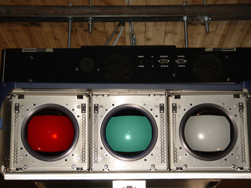

As for why the front fans on some 909 and Cine 9 are inverted, is still a mystery for me. I saw projectors with the left one being turned around, some with the right one and i've got my 909 with both as intakers. If we take a look at the technical drawing, it is clear that they should blow hot air away. Maybe Curt or Mike can shine a light on this ?
 Filesize:  447.17 KB
 Viewed:  11171 Time(s)
 Filesize:  388.9 KB
 Filesize:  443.38 KB

Posted: Sun Oct 21, 2012 7:20 pm    Post subject:

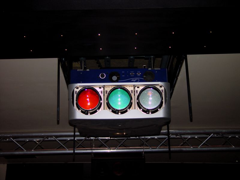

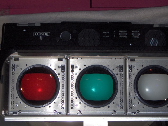

Look at those. Confusing as hell...
Wrong cooling will end sooner or later with coked boards.

Hello, thank you for these images, but ultimately must be posed how the fans to cool the card better not to mention the noise?
