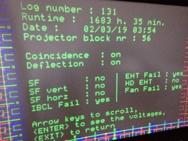

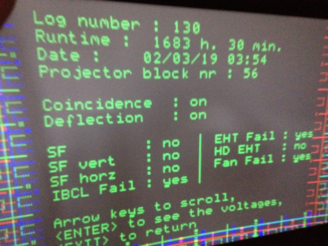

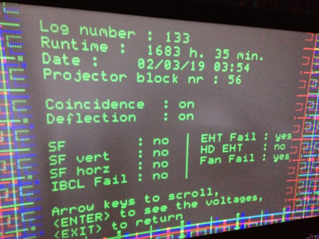

Posted: Thu Sep 20, 2012 5:15 pm    Post subject:

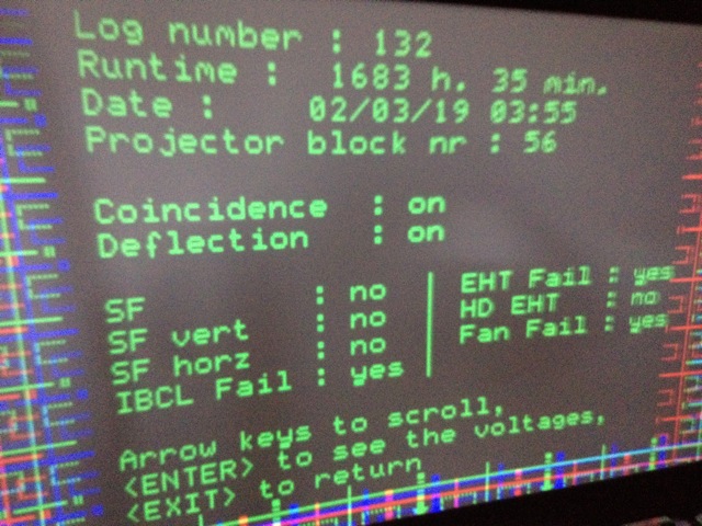

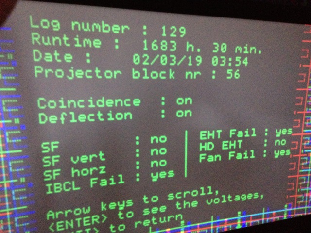

Here are the error messages i get when putting the tray with the controller into my BR909.
It looks like the EHT has issues ?
ElTopo

Posted: Fri Sep 21, 2012 1:17 pm    Post subject:
No, that just means at some point in time, the EHT had failed. THose errors remain there until cleared out, they don't reset once the problem is repaired. Same with the fan fail message.

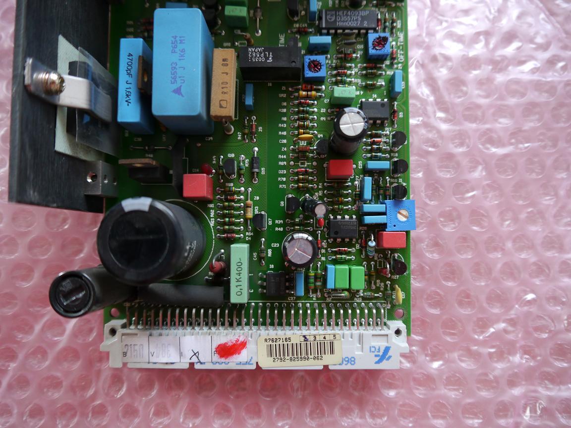

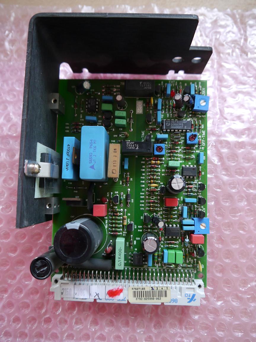

Posted: Sat Oct 13, 2012 9:50 am    Post subject:
Please find attached pics of the EHT board
cheers
