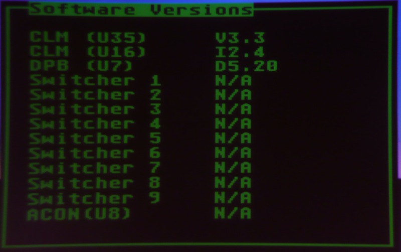

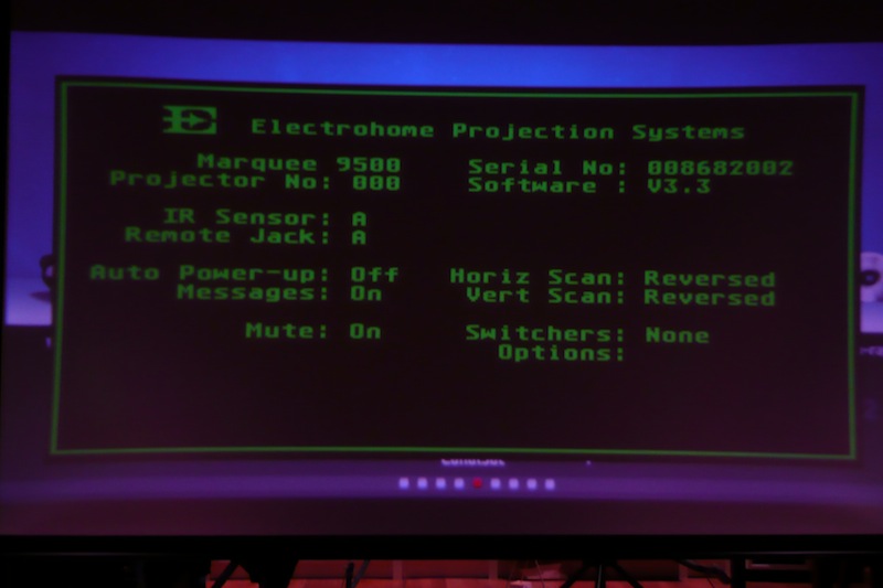

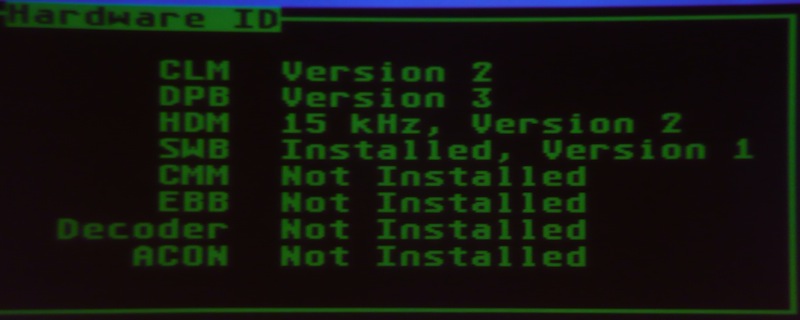

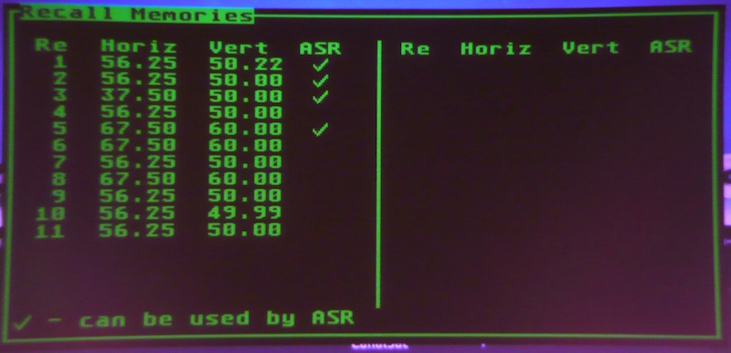

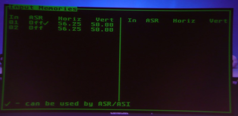

Posted: Fri Oct 05, 2012 12:08 pm    Post subject:
Hi Again,
I tried several times but impossible to reproduce the fault.
Anyway I've attached screenshots of the status and my settings.
The projector is from december 1995 and has about 1200 hours on the tubes
That's it for the moment
Regards,
Ron.

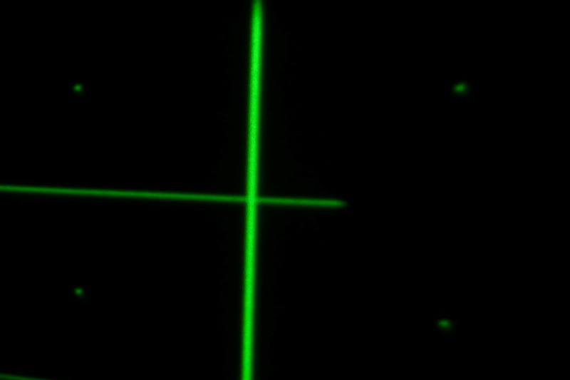

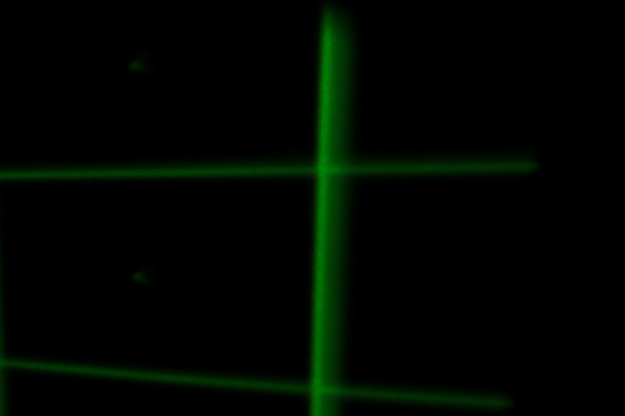

Posted: Fri Oct 05, 2012 12:43 pm    Post subject:
Hello
The blurred grid suggests a stig snap problem; try replacing CLM R35 with 3K3 per http://www.curtpalme.com/docs/ElectrohomeMarqueeTechnicalBulletin_TB97-04.pdf

This resistor R35 was already changed by me long time ago. And the symptoms were a little bit different. If the focus on green was off then I had to go into the menu: RGB focus then select green and then when I changed the setting with one push on the arrow buttons it snapped back in focus. The resistor change solved this issue.
The last two pictures (right edge focus) and (center focus) have nothing to do with the focus problem that I had when ramping the contrast up and down. This problem never came back and the projector switches on all the time and center focus is as shown in the center focus screenschot. However I still have a problem with the focus on the edges of the image and that you see in the right edge focus screenshot. It's taken on the right edge of the horizontal center line. I tried some scheimpflug adjustment but don't really manage to get rid of it.
When I had my projector on a table perpendicular to the screen I could get all the edges sharp.
I've exchanged the glycol in the green and blue tubes with a mixture of 25% Glycerine and 75% propylene glycol as mentioned in this forum and i thought that that's the reason but the red tube has the original techspray fluid and it has the same problem.

Posted: Wed Oct 17, 2012 10:54 pm    Post subject:
Ron take a pic of the dot pattern only if you can. Does the focus still snap into focus when adjusting contrast? And does it do this on all colors or just green?

Ok, good thing you got rid of it. When my green goes out of focus, it looks exactly the same all over with really thick grids, not like yours but figure it might be the same problem anyway. I probably could solder it myself, but what I really meant was some electronics store in town to do it. Fast and easy, but honestly I’ll probably lose my 30W soldering pen and buy a soldering station and do it myself. I will buy the caps off ebay.co.uk as I just looked it up. I also bought an IC puller the other day from there and await some more money to buy the rest of the stuff needed to clean the CLM, which might clear up some other glitches now and then.
But did redo everything, inc. geometry and scheimpflug, and that solved the overall focus problem I had before at the ends. Now it looks universal across and a set off HD10f is no longer top of priority.
Btw, I to have my pj on a table perpendicular to the screen, and maybe that helped me a little getting my edges finally sharp as well. The table isn’t high enough so the angle is off by some few degrees only, but good thing you told me about that. I’m planning on having it up in chains, that I bought last month, and raise it without turning it over, to correct and get an almost 90 degree angle, and doing so I can slide a 3 seat sofa just under it. The seat at the end will be taken up by the pj hovering above it. But can’t do it now because the table is in way.. Smile
