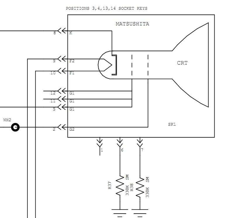

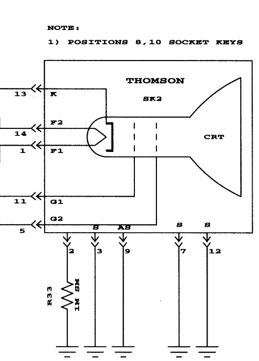

Posted: Wed Jul 18, 2012 11:36 am    Post subject:
I think your new tubes don't have the thomson pinout, what you posted is a guide to convert a thomson neckboard for your new tube (the first column is the original thomson tube pinout, the second is your new tube's pinout)
I modded the table corresponding to the 8500's neckboard pinout
pin -- 8500 -- new tubes
1 -- BL -- F
2 -- G2 -- G1
3 -- BL -- G1
4 -- BL -- BL
5 -- G1 -- BL
6 -- BL -- BL
7 -- BL -- G2
8 -- K -- BL
9 -- F -- BL
10 -- F -- G1
11 -- G1 -- G2
12 -- G1 -- BL
13 -- BL -- K
14 -- BL -- F
15 -- BL -- F
where BL stands for blank, F for Filament (aka. heater), K for Cathode, G1 for first grid, G2 for second grid.
Unfortunately this mod need to completely rewire the 8500's neckboard, but for a trained service personel it 's not a problem

What type are these tubes actually? Because the original thomson tubes not just differed in pinout from the later Panasonic tubes, but they required a (special) 40kV HVPS, but the modern tubes needed only 34.9kV, so if you still have the older type power supply in your 9000 chassis then your new tubes are greatly endangered.
As for the neckboard conversion: the 8500 neck board should fit physically to the new tubes, they just needed to be rewired according to the pictures (and not the tables)

But they need to be rewired for Thomson pin-out also.
