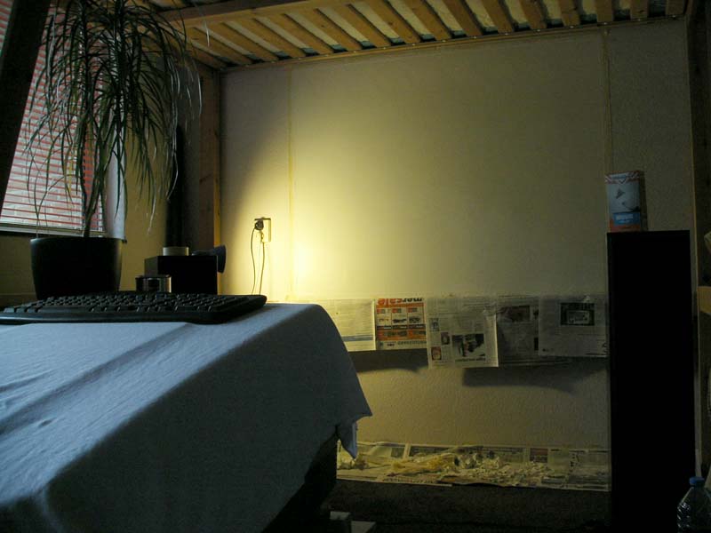

My screen is finished Very Happy
I started out by cutting out the wallpaper and making the surface flat with diluted wall hole filler paste.
Then I painted that, with multiple layers of pure white concrete paint that was on sale.
It covered the wall okay, but it was too reflective.
I couldn't try to sand it either, as it has a 'rubbery' surface.
Then I got an idea: I mixed the wallfiller with the concrete paint in 2:3 ratio, and lots of water.
So now I have a pretty bright area that doesn't reflect, sanded with a fine grain.
It's about 65" diagonal and it's good enough for me.

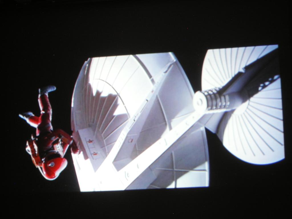

Posted: Mon Jul 23, 2012 1:40 pm    Post subject:
Yes, you are right. 65" isn't very large, but I'm restricted because I can't really move the PJ further back without hanging it.
At this point, I'm not comfortable with the idea of sitting right under a PJ. I know it can be done and I'm sure that a proper installation can handle 10 times the weight, but I'm not yet ready for it Wink

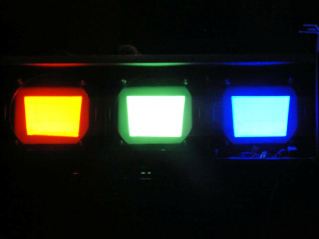

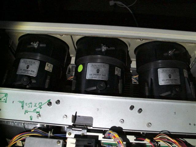

Here's some pictures of tube usage and lens settings. Do you think it's about right ?
As far a tube face usage goes, I've understood that the 9PG is not designed to use the full tube face.

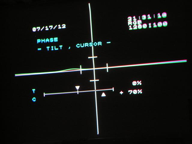

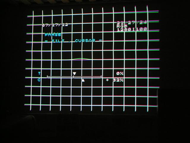

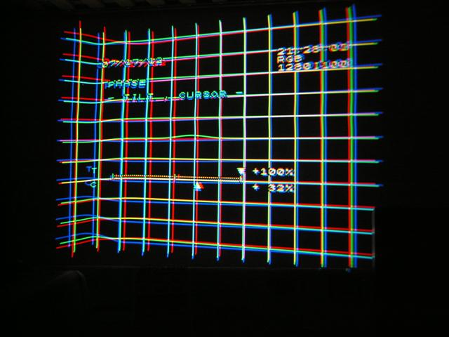

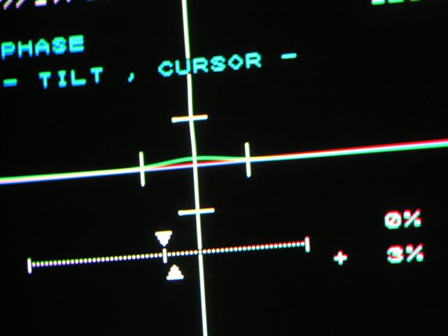

Now something else: How should I set "PHASE" ?
The menu entry isn't listed or described in the service manual at all, so I think I've got a service manual from an early model that did not (yet) feature digital Phase adjustment.
Should I set H-Phase to something that "looks good"? Or should I set it to have e.g. the straightest crosshatch?
And should I set the V-Phase to 'hit' the blip? or get it as far out as possible?
I couldn't (yet) find a post on the forum that discusses this, maybe because it probably appeared in later versions of the Service Manual anyway Wink

Posted: Tue Jul 24, 2012 10:32 am    Post subject:
Your tube usage seems just about right to me.
The two adjustments in the phase menu affects the test generator, and the whole convergence system for your input signal.
You should set tilt to as straight as you can, and with cursor set the cross hatch to the center of your screen
Posted: Wed Jul 25, 2012 6:56 am    Post subject:
Yes the tube usage is good, you dont want to go any bigger than that.
And yes again on the PHASE description above.
Set the BOW and TILT/SKEW first, then go to PHASE, get that cross hair as close to the dead center of your screen as you can. The little hump is the center of the convergence system in relation to the displayed test pattern, so you want that hump to be as close to the center of the screen as you can. When you adjust POINT, youll notice that the distance from the dead center of the cross hair to the center of the hump is the same amount as the POINT box will be from the actual point of adjustment. Its not a big deal, and youll quite likely figure that out pretty quickly, and youll know what i am talking about.
The other setting is the one that you set using cross coarse, and just get the line distortion out of the test pattern as best you can. On the later NECs there is a setting for line distortion separately, but on your PG Plain it is done in the PHASE menu. The way i do it is i set the phase til both sides are pretty much distortion free, then i exit that menu and look again with cross hair to see that the line is as flat as it can be. Again youll figure it all out.
When i have PHASE set, what i have done in the past on the PG Plain is put BOW and TILT/SKEW back to 0 again, then i get the green cross hair perfect as possible mechanically, then i start on electronic alignment.
Make sure the green cross hair is in the dead center of the tube face when it is on the dead center of your screen, and that your projector is dead square to the screen. If not, doesnt matter that you have the rasters perfectly centered, cause its the image that MUST be.
When you set the mechanical tube swing for red and blue, you MUST be sure you put the image back into the center of those 2 tubes after convergence, youll see exactly what i mean if you watch the red or blue tube and adjust the LINEARITY on either one. You will see that on red and blue, the center of the image is NOT the center of the tube face, and this is cause these 2 tubes shoot on an angle, so the picture doesnt have perfect linearity on them. Another thing youll figure out along the way Wink
Be sure STATIC is set to zero on all 3 tubes!!
