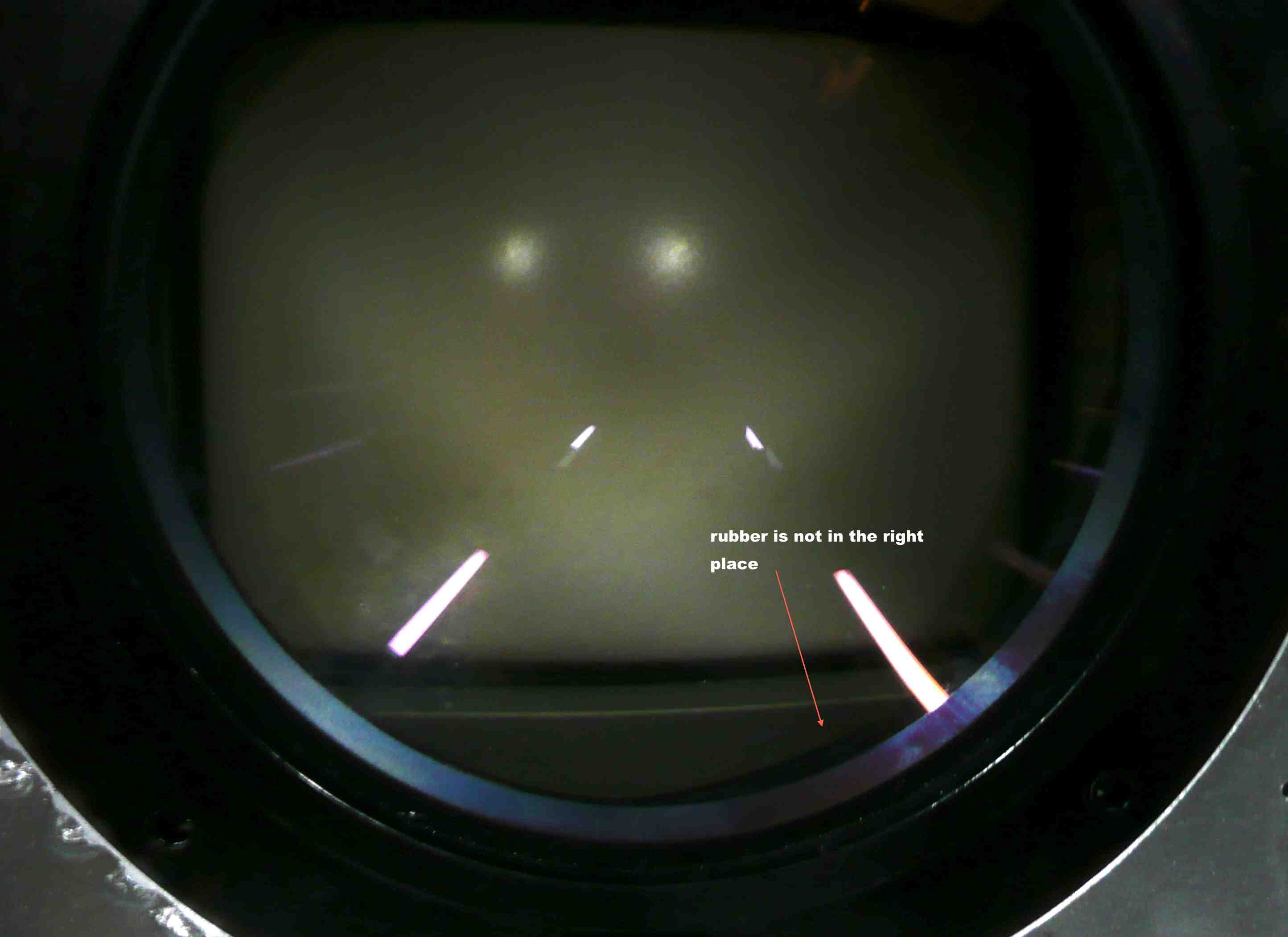

I took my tube assemblies out of the chassis to be able to put my projector on the cealing and therefore i took off the lenses.
The blue tube that had the "snowflakes" was leaking (very little). I'll post a picture tomorrow. I remember that I had to redo the blue tube 3 times and i still didn't get the C element nicely mounted Every time the bellow was pushed out a little on one side (as if the rubber was too small in diameter to stay in place in the housing) when i tried to push in the C element.
Could this leaking let in water or something?
I guess I need a new bellow Nashou?

| Posted: Sat Jun 16, 2012 9:43 pm Post subject: |
Hi again,
As promised a few pictures of the leaking blue tube.

| ronaldus wrote: | | I remember that I had to redo the blue tube 3 times and i still didn't get the C element nicely mounted Every time the bellow was pushed out a little on one side (as if the rubber was too small in diameter to stay in place in the housing) when i tried to push in the C element.Ron. | you need to look at the rubber seal area in the C-element opening. It should be perfectly centered before C-element goes in. If it isn't, and it almost always isn't, loosen the lock screws on the Scheimphlug bolts and turn the adjustment screw until the bellow is centered. Then install the C-element.

| Posted: Tue Jun 19, 2012 9:03 pm Post subject: |
Thanks Draganm,
I'll try to empty the tube tomorrow en try also to recuperate the bellow if possible.
I'll post pictures to see how it looks.
