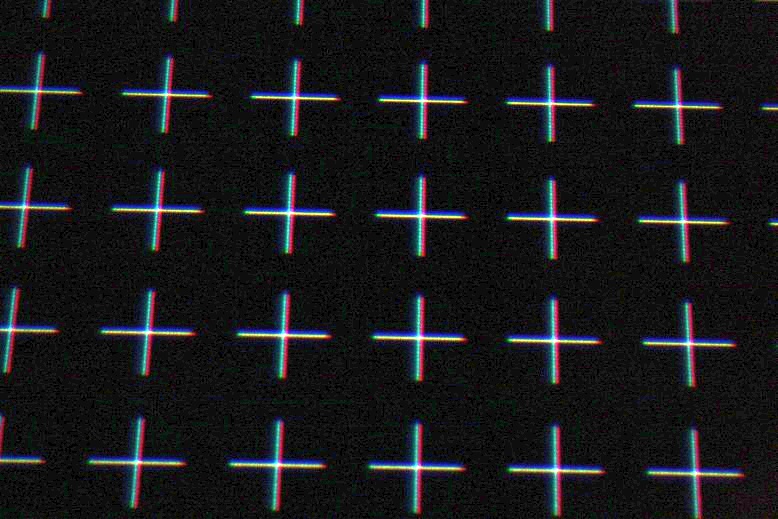

Posted: Sun Jun 17, 2012 8:23 pm    Post subject:
macgyver655 wrote:
I can't really see it that well and I would ask some more questions for a better determination but i guess we are just going to bail on the subject.
Does this help?

Posted: Sun Jun 17, 2012 9:26 pm    Post subject:
Its a convergence issue. and my only problem with it is that JVC don't want to tell me what is acceptable tolerances.
It seriously pisses me off when they ask me to ship it back and they will look at it, and charge me for shipping both ways and time to look at it if they think its inside tolerances. depending on the mood of the technician, or his wife the morning before he went to work.
They could just tell me that 2 pixels off in the sides and ½ pixel in the center is the limit, on a 100" screen or something like that, and i would be pleased knowing that mine is perfectly ok.

Well i'm just looking my own JVC X7 and its like the geometry is a bit off between the panels, and its spot on in the center..
Gets worse the closer you get to the corners. So look like i should bend the panels to get it right.
Can you describe just how the grid is off on these outer edges or post a pic?
2 top corners and center
Is blue really that far off on the corners, or is that just CA induced by your camera lens? If it's actually what I'm seeing in the pictures - blue being off by more than one pixel - that's unacceptable. Anyone who tells you otherwise is not being honest with you. How long have you had this? I would highly recommend telling your dealer that he or she needs to make this right and get you another unit. Going direct to JVC should really be your last line of defense, as your dealer should be the one making this right. Mine always has.
Its off with more than one pixel in the right corner, The problem is that its bought on Ebay in UK and he got it from USA, and he wont tell the name of the US dealer, and there is no clear answers regarding convergence, and i'm not going to ship my unit around the world, just to receive it back with no changes, except a lot of trowing around.
So i think it would be nice if some potential buyers asked the same question, or some of you guys already having JVC projectors asked and see if anyone got an clear answer. Mine is US model, so it would have to go back to US to get fixed / changed.
But i'm not really sure if its not over 1 year old now, JVC have been extremely slow, like i got the impression they are staling this until the time run out.

Posted: Mon Jun 18, 2012 8:50 am    Post subject:
I bought a NEW X7 from UNIVERSAL ELECTRONIX UK And they parallel imported it from US. Didn't know before i started asking questions, so he just call the US dealer.
I have been in direct contact with JVC europe/ UK and they have contacted JVC Japan, and never got any answer.
Actually just got answer today that they tried, and they couldn't get any answers from JVC Japan so i should try true JVC USA again. Been waiting over 3 months for that one, and i mailed them from time to time asking how went.
I now asked if they would supply an answer if i get someone with a danish sold unit to ask it.. I'm just so annoying.. Twisted Evil
After i got my 9500LC i'm not using my X7 anymore, not that its a bad projector, but the 9500 is just so much better that it hurts my eyes looking the JVC.
So ill think about shipping it back, like i never use it anyway, just to see what they will do, and learn from the experience.
But the point here is that JVC supply sh*tty or no information/ service, and i think others should be aware of it before they buy JVC.Not that they make bad projectors, actually i'm sure it some of the best black from new projectors, but they are far from perfect.

The problem with the convergence is not really a big problem on the image.. its only visible on rare occasions in the sides, and has nothing to do with the reason i prefer my CRT projector.
But thats another matter, and i might think we should take this convergence matter to another thread to. Like i'm not sure how much it really interest anyone in this one.
Posted: Mon Jun 18, 2012 10:39 am    Post subject:
For the love of macro photography can anyone borrow an appropriate lens and document like I did years ago. You are trying to provide captures of an off pixel and then showing a picture with hundreds of pixels and asking people to discern for proper analysis.
