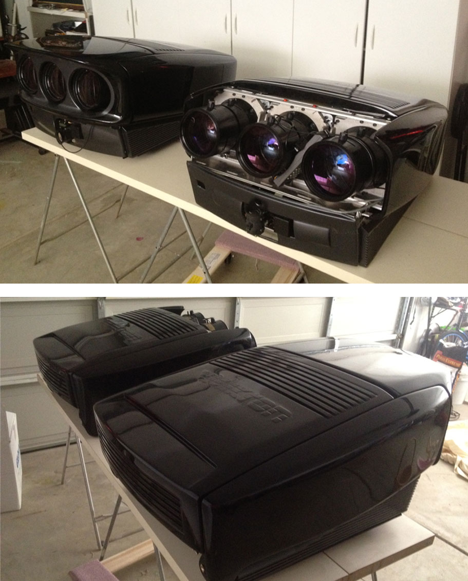

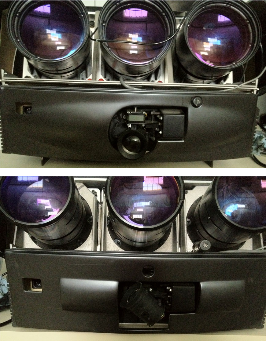

I finally got some muscle to get these set up on a proper work area. Thought you guys might want to see the two together. I tell you they look bad ass as a duo. I didn't realize the two cases are not the same make though. I know one is an Marquee 8500. Still trying to find what the other model is. The front bottom panels vary where the mic hole is and the pj I'm trying to get working again, the case looks like they had to mofify the screw holes a bit to make it work right. Still looks great though.

oh God, there's like close to 400 pounds on that hobby table. I bet they wouldn't look very "bad-ass" after they crash to the ground and implode the tubes Wink
The broken one is a Vision 1 , AKA 9500LC. The best projector Electrohome ever made.
