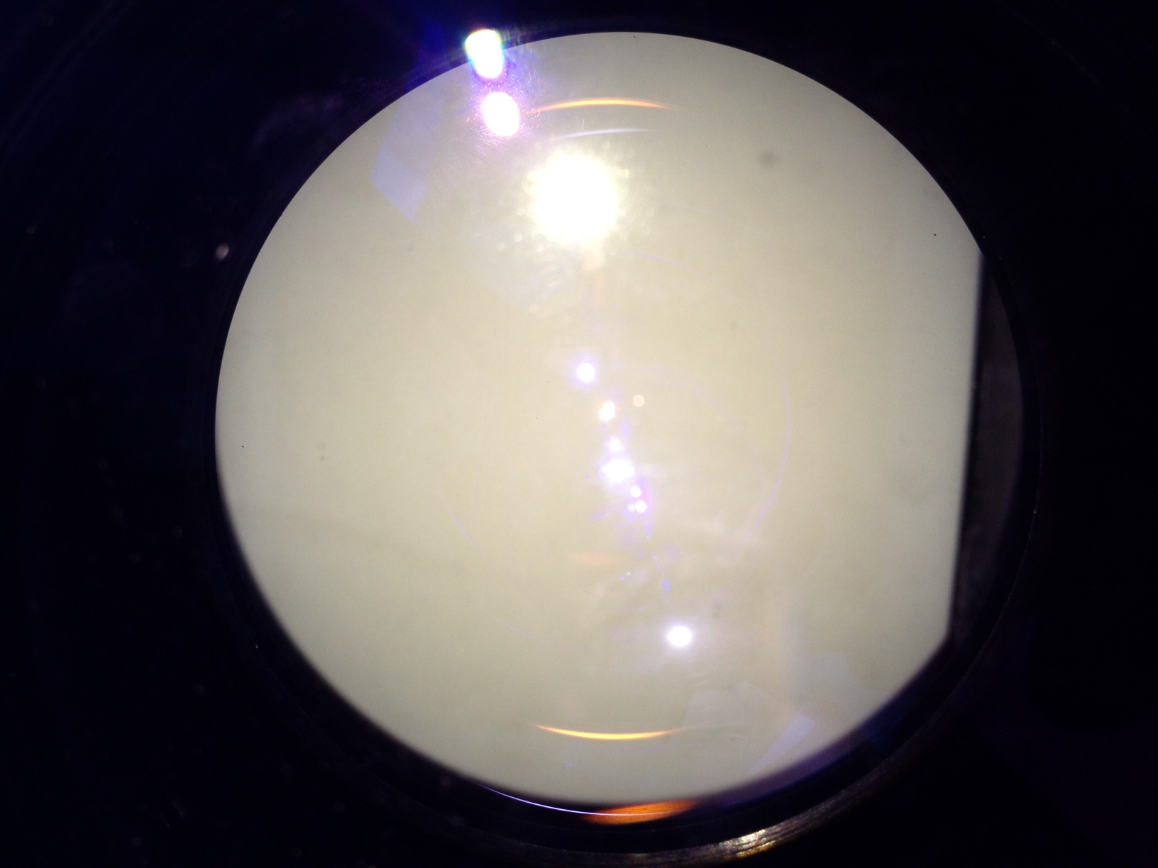

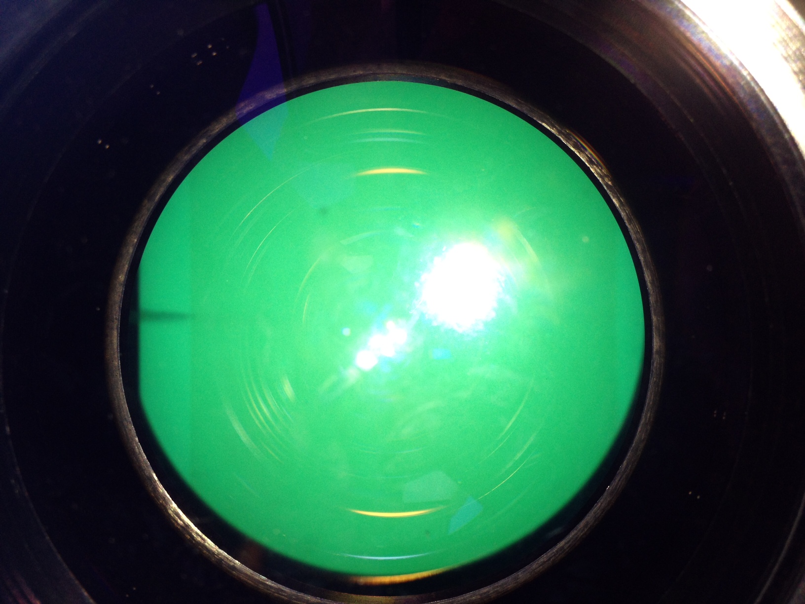

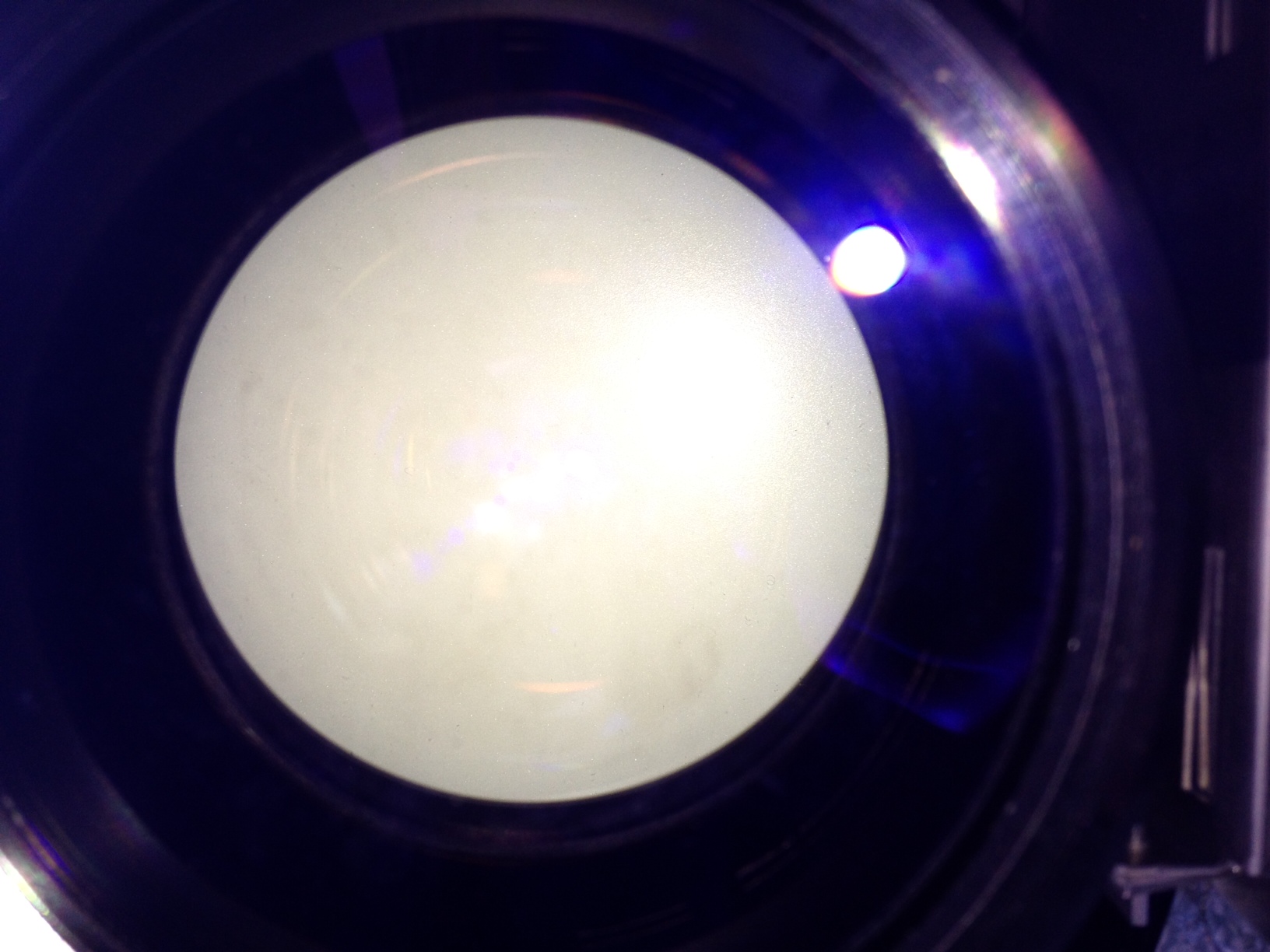

Posted: Sun Apr 22, 2012 11:38 pm    Post subject: I retreived the 2nd projector!
You're right, Electrohome/MArquee made the chassis, all Vidikron did is make the case. You might want to go back and get the other set. If it's got larger lenses, then it's the Vision 1, which is a better set than the Vision 2 that you have.
If you want, I've got a top of the line Runco/NEC quadrupler that will do 1024p. Yours for a whopping $25 plus shipping. It's the IPS4000Q, a great unit.
I took everyone's scolding for returning the 2nd projector and ran back to the store today and grabbed it. If I can't get it to light up I will sell the case and lenses.
There is a Quadscan being offered to me from Curt (Thanks Curt) along with your NEC quadrupler. Since there both around the same prices and nobody is getting rich off my decision what is the best choice?
So the lenses on the 2nd projectors are Delta HD-10's should I do the swap? Also I looked into the lenses with a flashlight as suggested and I see no burn or browning on the inside. Does that mean they should still light up? It fires up when I turn the poweron just the the 1st one that lights up but nothing... I'm wondering is there is a wire loose.

Posted: Sun Apr 22, 2012 11:41 pm    Post subject: I retreived the 2nd projector!
I took everyone's scolding for returning the 2nd projector and ran back to the store today and grabbed it. When I opened the top I was surprised to see how immaculate it was inside. Hardly any dust or signs of aging. If I can't get it to light up I will sell the case and lenses.
