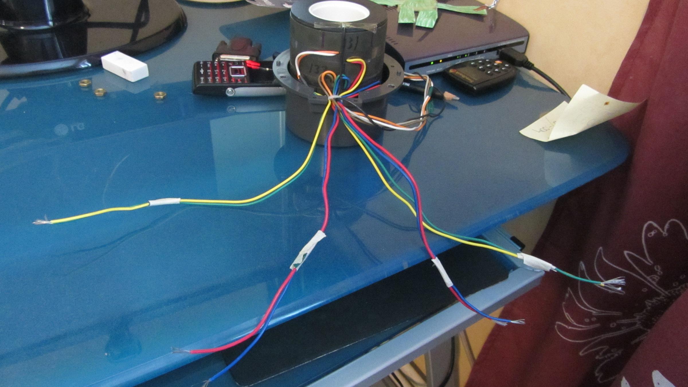

god morning! i have opened the housings and picked out the pairs. The color change is from orange/white to yellow/green. Acording to the scedual in the thread from mr steve that would be the static focus wires. Can i conect these to the static focus marquee wires and then do the same for the dynamic focus and so on. Do i even need to mesure the ohms? what i will do is to leave the 6pol wiring anone because the marquee doe not have them.
 Filename:  IMG_0265.JPG

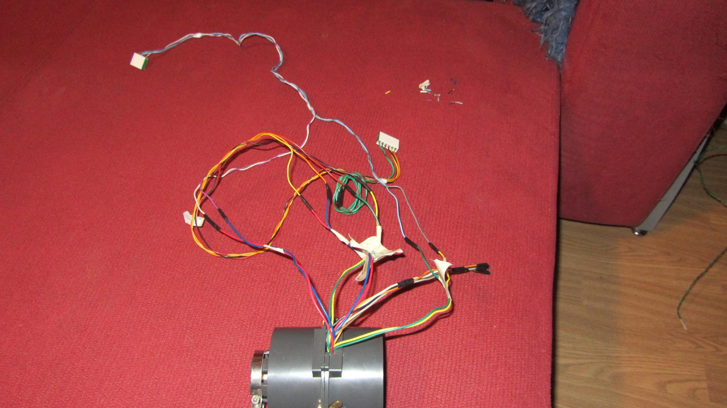

this must be it then. The ones that coming out of the coil in pairs are nor actually the right pairs then acording to your picture? the static focus must be the white/orange that turns to green/yellow. then there are opne more pair of green/yellow. Then there are two pairs of blue/red that is to be used as well. can i conect them and try if it works and then change if the wiribg is wrong? or would that destroy the PJ?
thanks again
 Filename:  IMG_0267.JPG
 Filesize:  371.68 KB
 Downloaded:  456 Time(s)

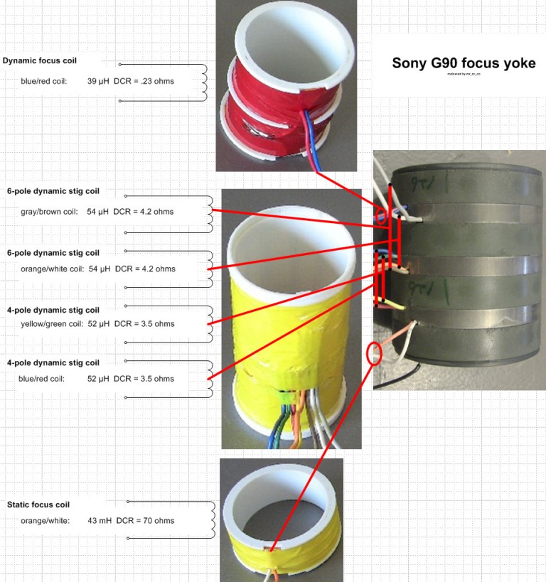

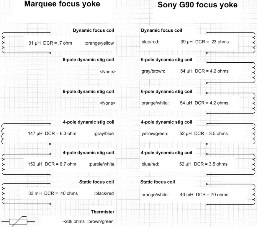

Andreas,
That's what I said before. The inner bobbin is tricky because the wire pair groupings are not the actual pairs going to each of the four coils on that bobbin. Two of the coils on that inner yoke go unused.
These two drawings are from the Frankeyokes thread. Wink Wink Study them closely. One shows the exact wire identification to each coil in the yoke. The other shows the coil equivalence to the Marquee yoke. All of the information you are seeking is in these drawings. All your other questions must be answered by your experimentation.
If you want to be absolutely sure your pairs are correct, get a mulitmeter and measure their DCR and ensure it matches my drawing.
Per Scott, you may need to experiment with polarity of the dynamic and static coil connections. You will know this if the image is badly out of wack. The actual wiring of this needs to be identified and documented. The stig coil connections are not dependent on polarity.
You may need to rotate the yoke about the tube neck to get the image centered. This is unknown.
You may also need to reverse the orientation of the entire yoke. This is also unknown.
Unless you make a wiring error that shorts something out, the Marquee electronics should have no problem driving these yokes and there should be no risk of damaging the tubes.
Best,
Steve

mike mentioned once some components on the fgm needed another value for these yokes to work properly.
this won`t be necessary if you wind the yokes to get the same inductance as the marquee coils though i`m not 100% sure.

thanks again for the good picture. The red lines are great i can see what is what now. A friend will come later with a multimeter so i can messure that the conections are the right ones. I just bind them together and start to hook all up now.

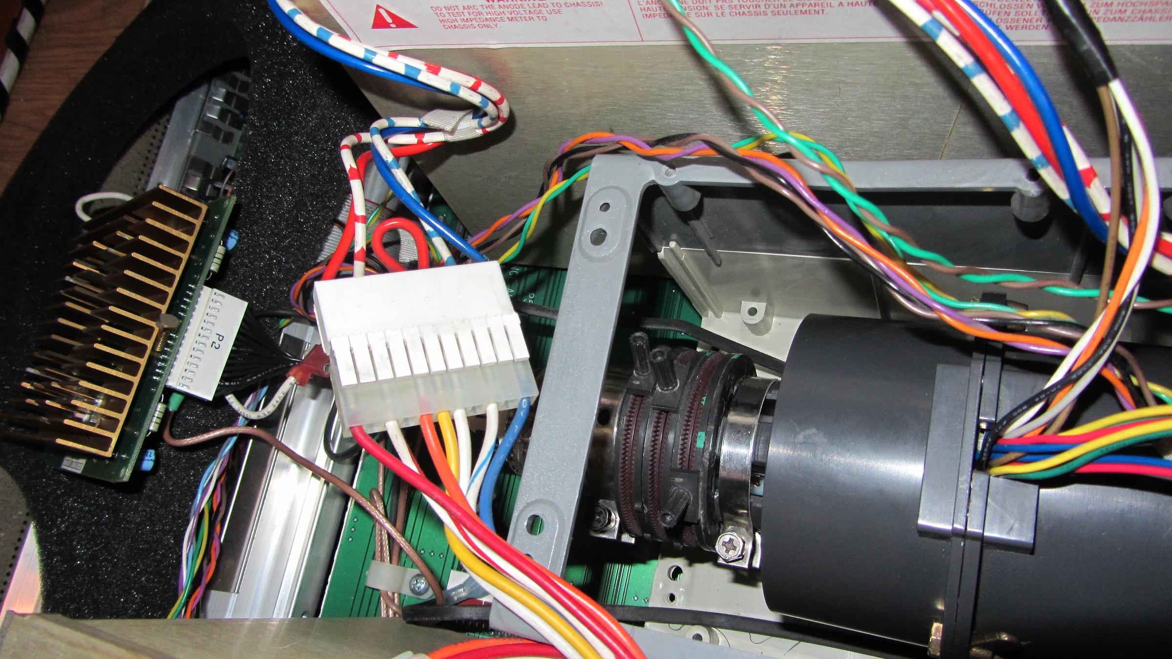

oh, the cpc magnets sits realy far back! should i cut of some of the plastic on the g-90 yoke to get the magnets more far upwards?? Confused
 Filename:  IMG_0269.JPG
 Filesize:  467.6 KB
 Downloaded:  446 Time(s)
Posted: Thu Apr 05, 2012 6:27 pm    Post subject:
What would be ideal would be to find a way to use some Variable control voltage that the Sony's CPC magnets use. I believe the CPC magnets are built into the sony Focus Coil. In the G90 there are no manual adjustments for focus, it is all done via remote.
I Was thinking of some how using the un used portions of the marquee that have a variable remote function for the CPC but there are not enough of them to use, for example, tint,detail, volume etc. Unless a separate amp board with the correct voltages and some sort of remote code could be built to utilize the G90 CPC magnets in the focus coil assembly. Too costly and too much time to do i would think.
you could remove the plastic housing and wrap the magnet structure in Rubber tape. I did that for a barco coil set while i was making changes in the windings. it freed up space for the CPC's.
