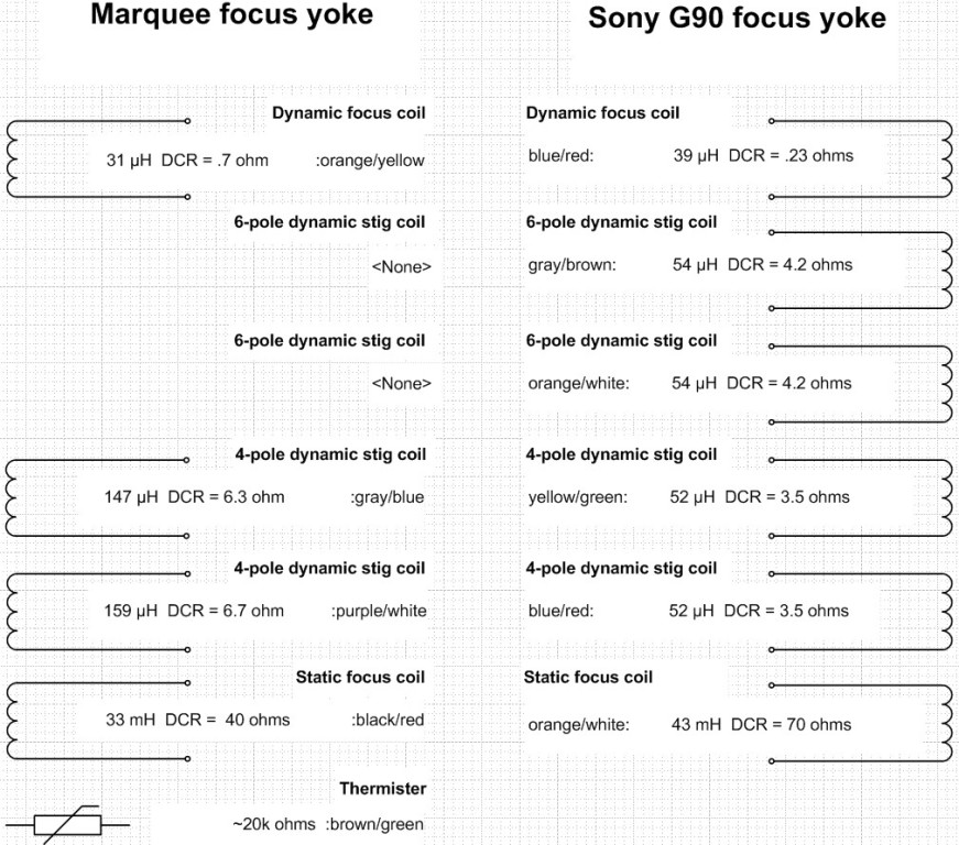

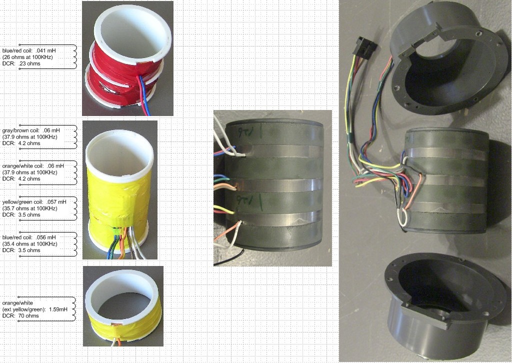

Disclaimer: I have not yet installed these because the project got derailed for other reasons, but was poised to install them. They do need to be flipped or rotated 90 degrees, can't remember (it's in an email somewhere).
I took these yokes apart, pinned out all the coils, measured their impedance and sorted the connection schedule (verified by Scott, a VDC technician) out here (bottom of page):
https://www.curtpalme.com/forum_archived/viewtopic.php@t=2498.html

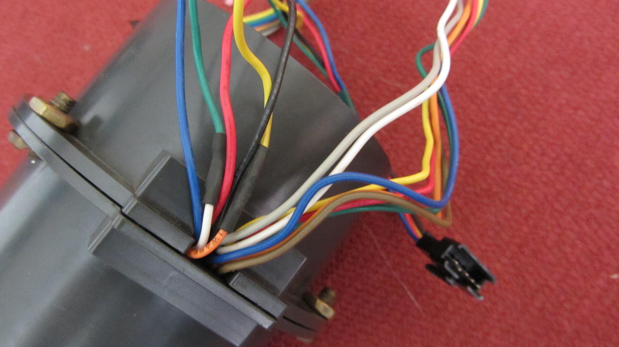

Hello everyone! i just got them Very Happy One of the yokes has been opened and the wires seems changed in someway. i dont know what that meens.. i will post a picture to explaine:

There is a wire color change from the G90 yoke connectors, where a green/blue pair connects to a white/orange (the static focus coil). My schematic is for the actual wiring colors that connect to the coils in the yoke. If you have any confusion over this, drill out the rivets that hold the plastic shell of the G90 yoke together so that you can see exactly how the wires go into the yoke. Cut off the Sony connectors, and separate out all the color pairs per my diagram. The confusing part is how the wires go into the inner bobbin for the (2) 6 pole and (2) 4 pole stig coils. But between my photo, diagram and a multimeter, you can measure DCR and should be able to figure it out.
Also, Scott emphasized the following:
The polarity of the dynamic and static windings are important. If the sides are way out or the top is way out of focus try reversing the polarity of the dynamic (sides) or static (top and bottom). Stigs really don't matter as they can adjust in both directions.
And:
It is good to ground one end of unused windings as they will pick up a static charge when HV goes up or down and can arc to important stuff, like you.
zGman also recommended using the grounding the unused coils.

mr_ro_co
Joined: 08 May 2006
Posts: 1643
Location: Santa Fe NM
Posted: Wed Apr 04, 2012 4:06 pm    Post subject:
Interesting - it looks like your static focus coil is reconnected to a blue/yellow pair instead of mine with is connected to a blue/green pair.

yep seems strange and scary.I hope it works like the othet two yokes. The connectors has the same collors. That yoke has already been picked apart and there is skrews that i can open and check if it looks like your pictures inside, hope it does...

Please refer to my diagram for the connection schedule. It does not identify polarity, however, but it identify the the coils and their functions between the Marquee and Sony yokes and the wire color pairs for those coils. You will have to choose your own connection method between the Marquee wiring and the G90 yokes. I am not aware of anyone having documented a specific connection schedule from the G90 yoke connectors to the Marquee's wiring.

Andreas,
I dug out my G90 yokes just for you! Smile

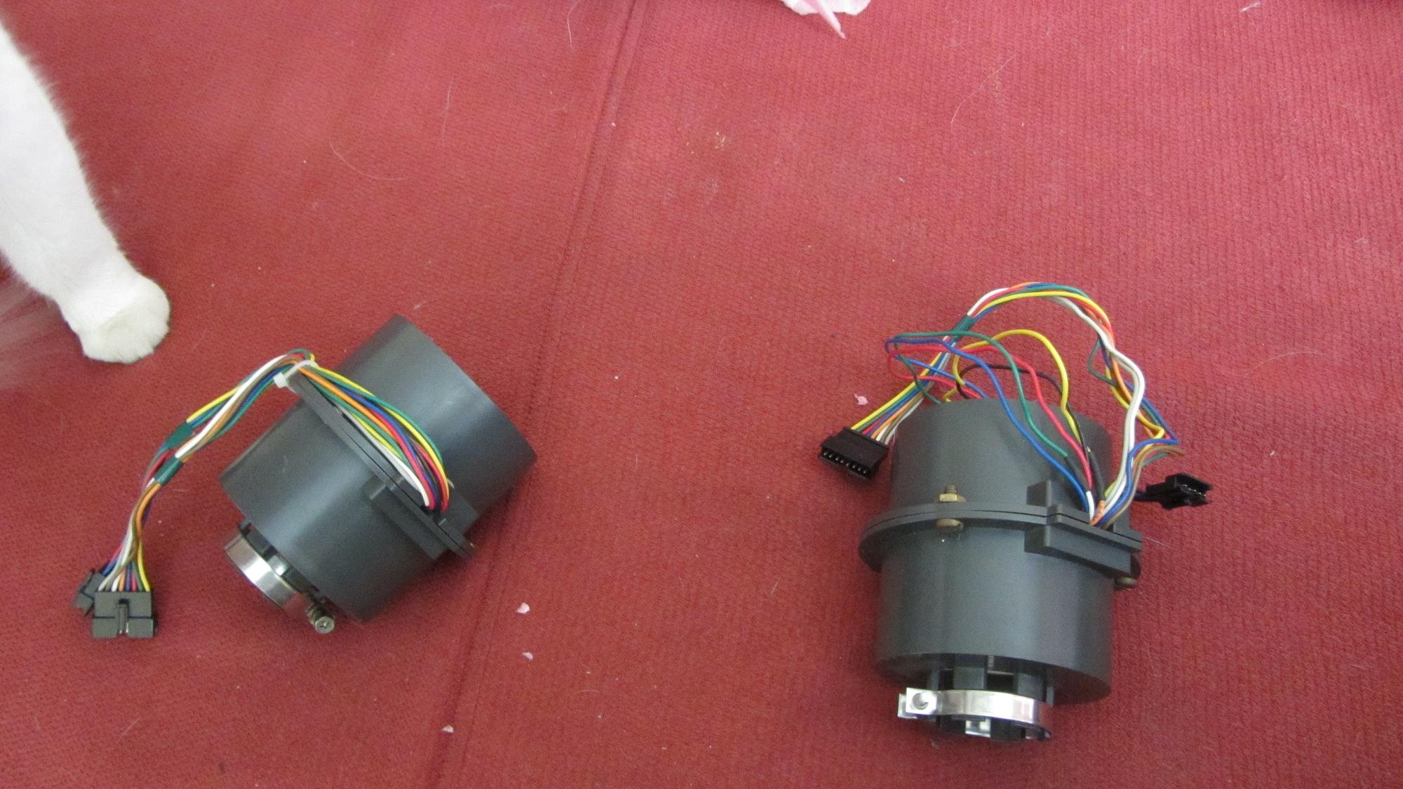

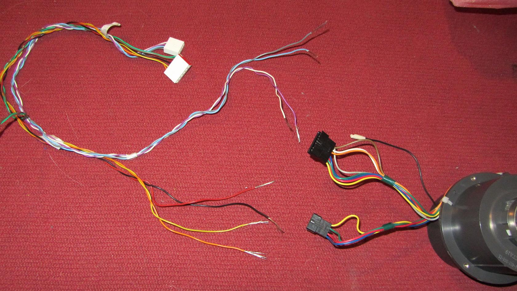

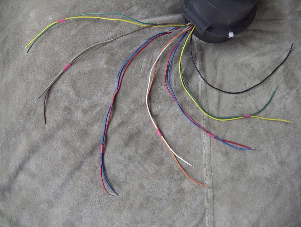

Here is what I did. I took all three apart to identify the coils and wire pairs to them. Then I grouped them together. My approach was to make the connection between the Marquee wiring and the G90 yokes with individual pin-and-sleeve connections, each heat shrinked to insulate from each other. This would allow for a good connection and the ability to reverse polarity easily as needed.
Like I said, I never did get around to this because I got side tracked with another problem on the projector I was going to test these on. Now that my working projector is on a table, maybe I'll get these installed this weekend.
Best,
Steve

this is great steve! I guess i will have to open them up to identify the pairs as you did since thre are several wires with the same color. Post some pictures of your work if you do install them this week!
