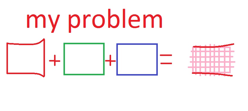

Posted: Mon Feb 20, 2012 7:09 pm    Post subject:
Post a pix of the test grid please.
I don't have a cam, but now I can show my amaizing paint skills!
So when I look inside the crt when doing the full set up the corners on the red tube goes like in the picture and when I try to convergence the tubes to match, I can't move the lines all the way down.
Hope this helps you guys to figure out whats happening.

Posted: Tue Feb 21, 2012 6:52 am    Post subject:
The yoke is loose or not centered properly on your red id say. Then adjust the pin abit, followed by the sideshot keystone. If youve got those, i dont know what settings youve got to adjust...

Posted: Wed Feb 22, 2012 1:27 pm    Post subject:
Didn't help, yes the yoke was loose, but moving it didn't help. I even changed the crt and I still had the same problem.
I have tried everything, don't have a clue why it is bigger from the other side.
