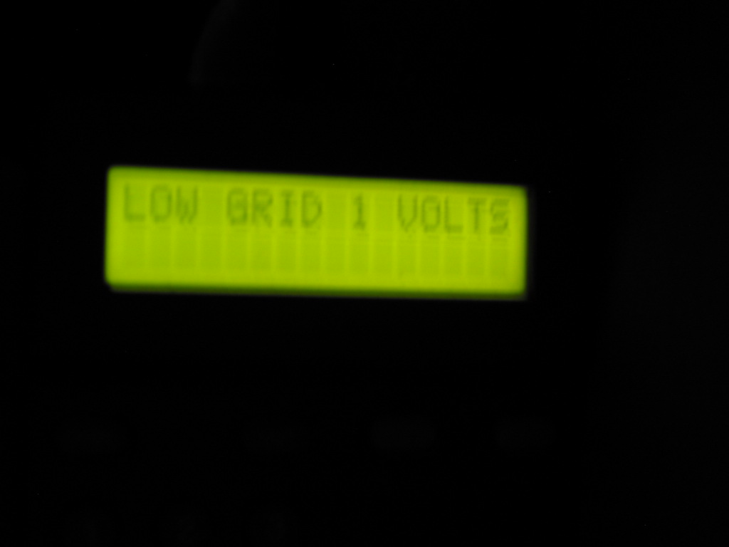

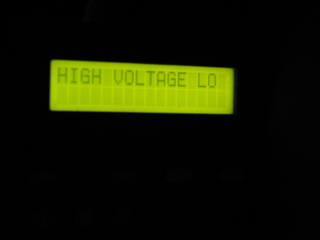

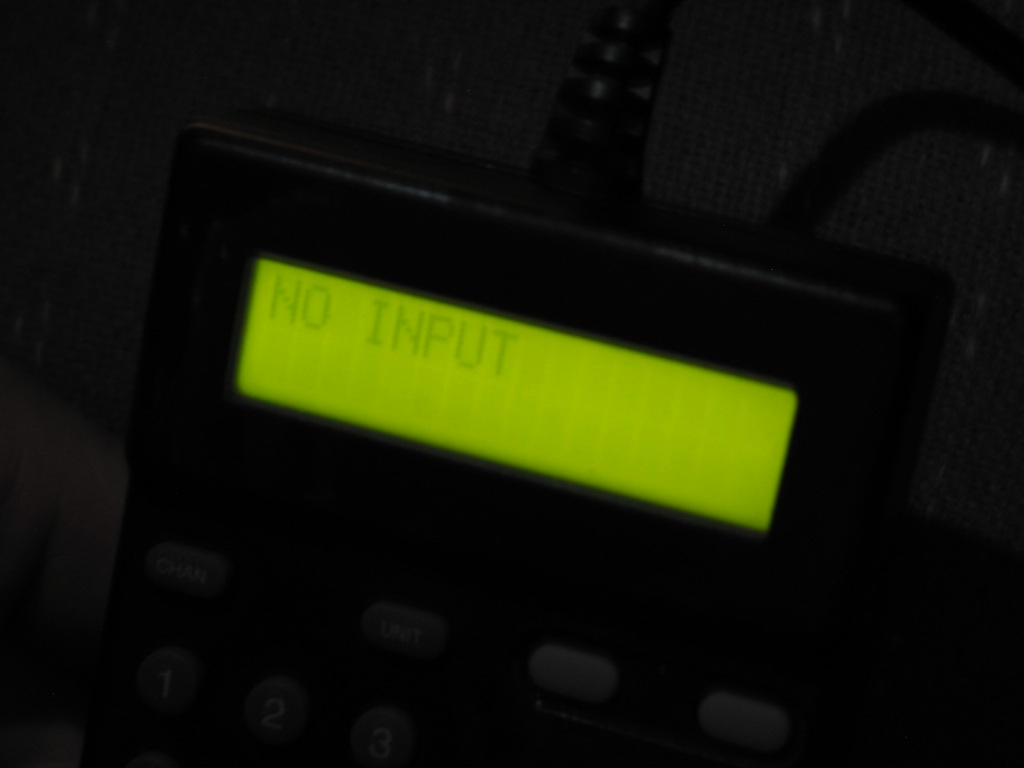

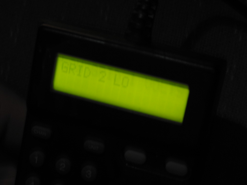

I got to do the 30 code and here's what I got:
Keep in mind the neck cards are disconected from the HV, G2, interface so the only conector that's still on there is the coaxial cable for RGB and the ground's.
Would you like me to re-connect the neck boards and try again?

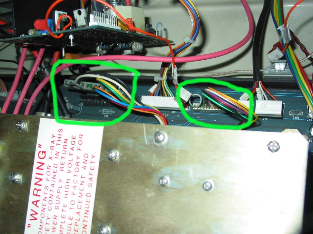

Oh any by the way, just so we're on the same page....my HVPS doens't have the 2 wire connector. It has these:

Well it looks like the high beam current is being triggered within the HVPS however without the high voltage, which may mean its a problem with a component that maynot be in the potted section. Unfortunately without the proper schematics for the HVPS its difficult to give you more suggestions. I do have a schematic for an Ampro HVPS but I'm not sure its the same for yours so any info maynot be accurate. I did notice in the 2000 manual and other manuals I've been looking at that the last plug you disconnected to eliminate the high beam also supplies +20 and -20 volts to the HVPS. I would check those voltages to see if they are way off or not. To bad you dont have another HVPS just to verify it is that because you still cant rule out the CPU board because it samples the beam current, but by disconnecting that last plug may confirm its not the CPU. OH hum,

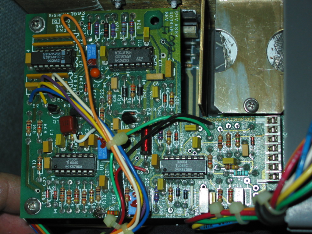

Okay, I had some time tongiht to remove the 3000 screws from the spellman, plus the 4 screws to get it out of the projector. Here's a picture of the control board. Which op amp should I replace?

I sent the power supply out to be tested. All is well with it. I installed a few minutes ago and all I get is....nothing. No HV at all. If I do a code 30 I get the same messages as above:
"High Voltage Low"
"Low Grid 1 Volts"
"No High Voltage"
"Kill me now, please"
Whaddayathink?
