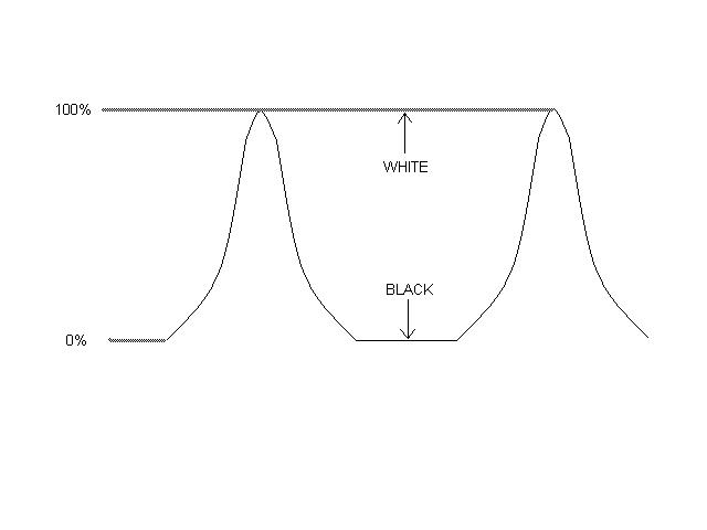

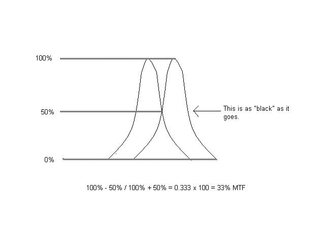

Ok MTF, from the famous TSE post on AVS back in 2006;
http://archive2.avsforum.com/avs-vb/showthread.php?t=633597
MTF. Modulation transfer function.
It's a way to put a number on resolution. It looks good. I can barely see it. It is real sharp. Any of these statements can mean different things to different people.
Imagine a light meter that only looks a small slit a few thousands of an inch tall (or a tenth of a mm). If you put up an alternating line on line off pattern at 320 x 240 resolution you would see a bunch of horizontal lines. Now take your light meter and measure the light between the lines and the light at the peaks of the lines. You would measure something like what is shown in 100%.bmp drawing attachment. Because the light between displayed lines would be "0" (or something near zero) your MTF reading would be 100%.
Now increase your resolution to 1600 x 1200. The lines are much closer together now. In fact they are overlapping to the point where there is no longer "black" in between the lines. If the "black" you measure is now one half what you measure at the peaks your MTF is 33%. If you now go to 1536 lines you can imagine the "black" is even a higher light level and your MTF might only be 15%.
10-15% MTF is obvious. When you get down to 3-5% MTF it is getting hard to see with your eye.
100% MTF
33% MTF
