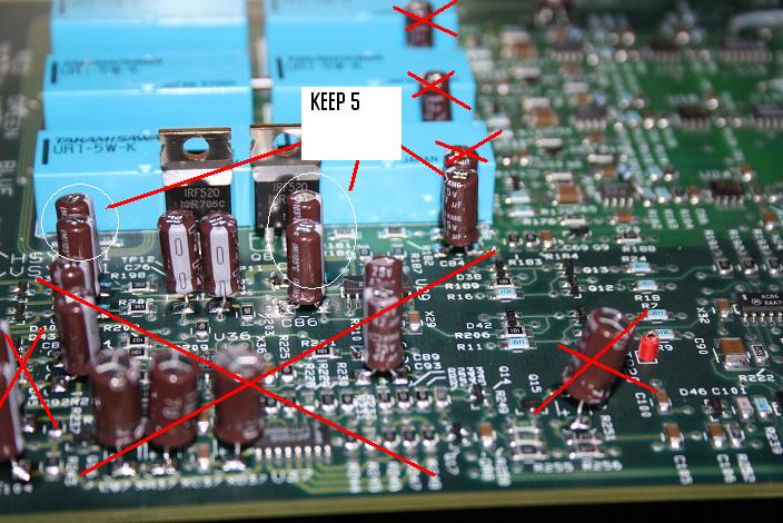

Here is my boards with new caps. Maybe ill try others in the future, but not while i just have 1 set of boards.

Posted: Sun May 13, 2012 9:57 pm    Post subject:
stridsvognen wrote:
Here is my boards with new caps..
SWEET, you re-capped the entire audio section. I bet your audio never sounded so good! Laughing
Try this
 Filesize:  93.76 KB
 Viewed:  9320 Time(s)

draganm wrote:
Try this
Well i was aware that there would be some caps for audio around there, but no idea which ones. And like i don't use the audio, i couldn't see any harm in changing them.. It takes 15 min and cost around 3$ in caps, for all the VIM. So its not going to make me loos my sleep for many nights that they are sitting there doing nothing.. Wink
