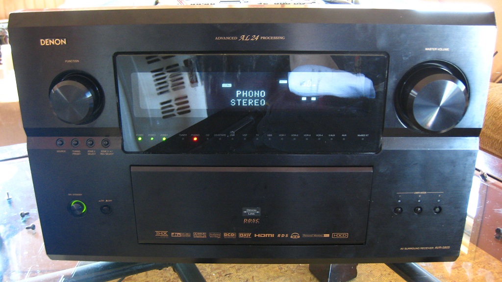

Well... This is certainly good news!! After taking the outer casing off the new AVR, I found a few things, the display PCB was cracked over a few lines in the PCM so I resoldered those together, fixed the knobs, fixed the pushed in buttons, tightened some loose screws, oh... and did I mention one of the inner PCBs wasn't even half plugged in??
This is the result of my efforts Mr. Green :

Now all you have to do is try this main board in the other one and see if it turns on.
