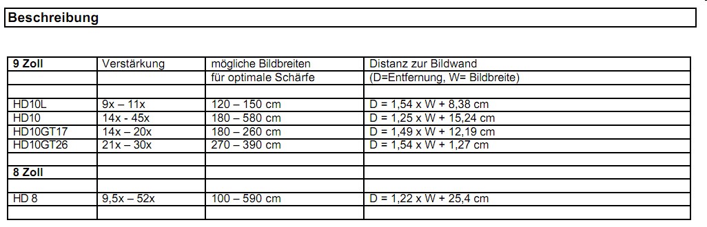

Posted: Thu Oct 20, 2011 5:27 pm    Post subject:
look at this:
 Filesize:  62.4 KB
 Viewed:  5659 Time(s)

zGman
Joined: 22 May 2006
Posts: 599
Posted: Thu Oct 20, 2011 10:58 pm    Post subject:
The magnification for all HD10 series lenses that I have ever used or heard of is the same.
The only difference is the screen width for which they are optimized. The reason the 8500LC
has a longer "throw distance" is that it uses 8" tubes , which is the same as using a small
raster area on a 9" tube. The optics are the same in either case.
Point being - whatever lenses you mount on that machine, it will still have a long throw distance.
G

Question is which Ratio is now correct???
1,52:1 ???
And am i correct that GT17 or HD17F would give me better corner Focus / image Quality
Cheers
