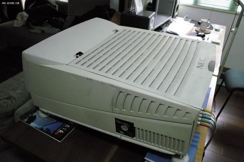

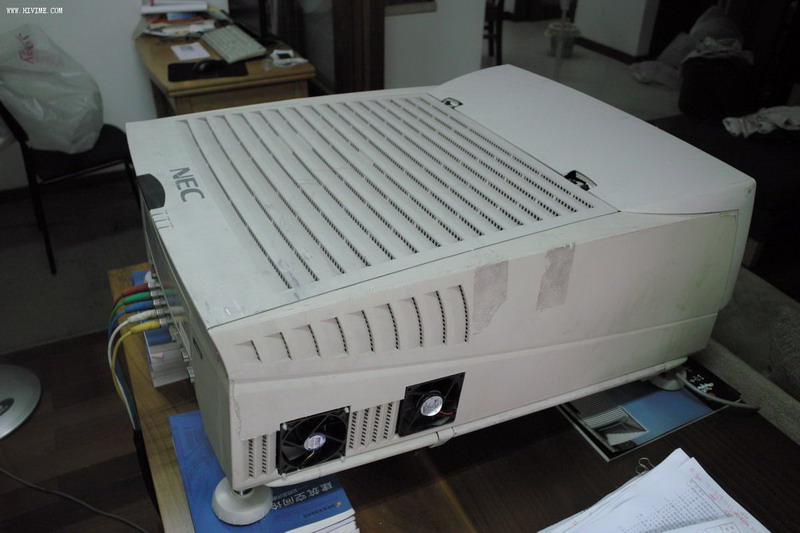

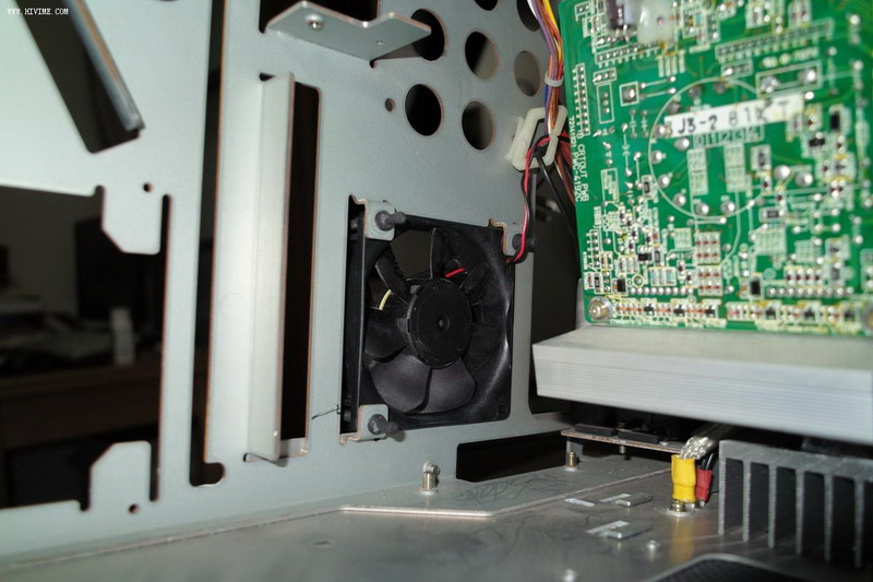

my XG110LC fan mod, very quiet!

@GeorgeSong
Thanx for the Photouploads !
Could you tell me which Fans exactly did you u use or swap out?
Cause i am still calculating which CRT to buy.
And if i can make the XG110LC more quiet safely.. i would take that one.
Cheers
Ronald
Posted: Thu Oct 13, 2011 7:10 pm    Post subject:
GeorgeSong: Have you measured before & after heat sink temperatures to see how well the new fans work? Just curious!
Posted: Fri Oct 14, 2011 12:35 am    Post subject:
Those rubber mounting plugs go a long way to quite fans.

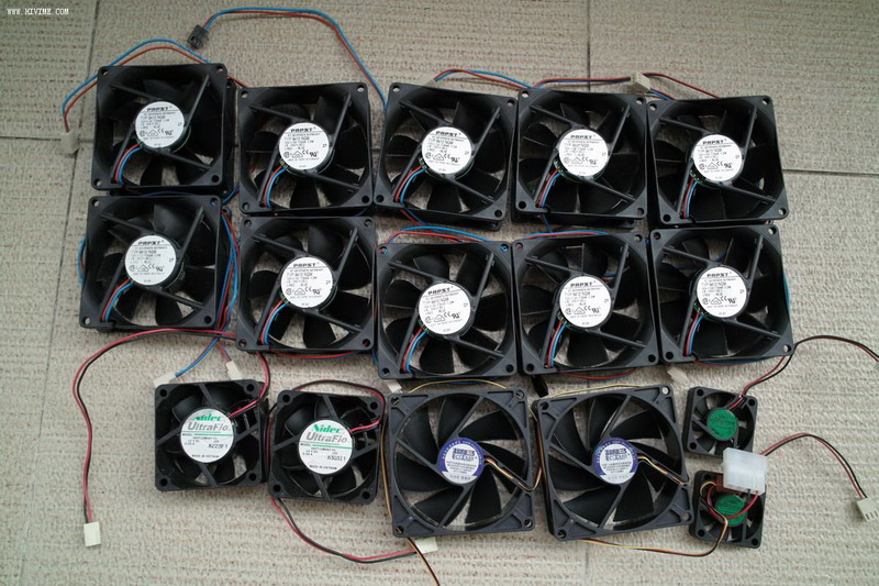

GeorgeSong
Joined: 31 Oct 2008
Posts: 74
Location: Canton,China
Posted: Fri Oct 14, 2011 6:45 am    Post subject:

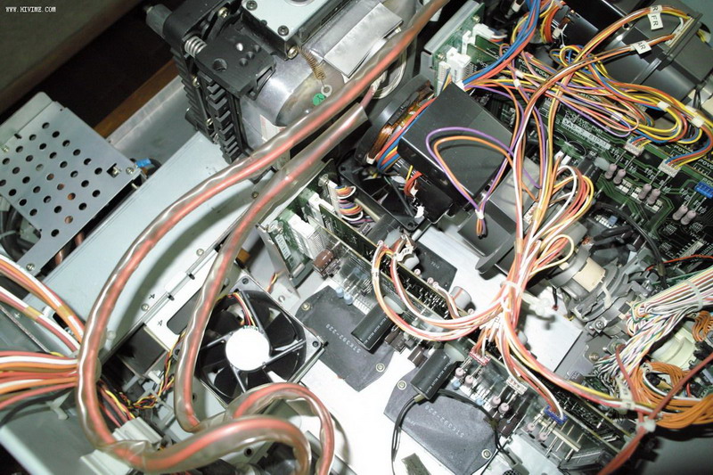

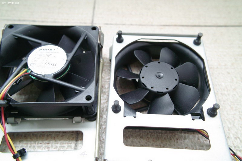

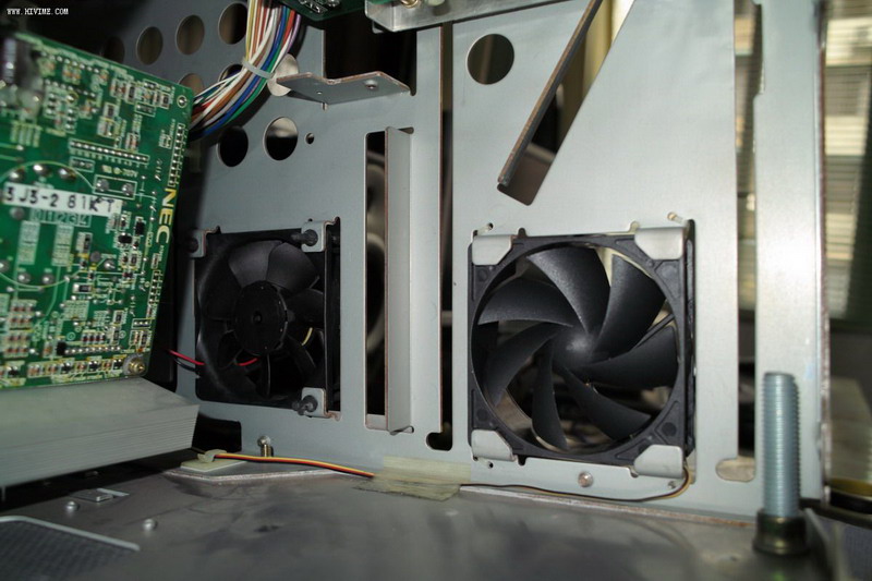

MOD BEFORE, 5 fans: Panaflo FBA08T12H 33.5CFM 34dB 3100RPM
MOD AFTER, 5 fans: ebm papst 8412NGM 34.1CFM 26DB 2600RPM
before, 1 fan: Panaflo FBA08T12L 21.9CFM 23dB 2000RPM
after, 1 fan: chinese brand 8025 12v0.06a 24CFM 11dB 1400RPM
before,1 fan: Mitsubishi mmf-06d12dm 14.12cfm 25dB 3350RPM
after,1 fan: Nidec U60T12MHA7-51 15cfm 22.5db 3200RPM
before, 1 fan: Copal F412R-12LA-16 3.88CFM 16dB 4200RPM
after, 1 fan: ADDA ad0412lx-g70 4.7CFM 14dBA 4200RPM
2 14CM fans outside the base, are not need.

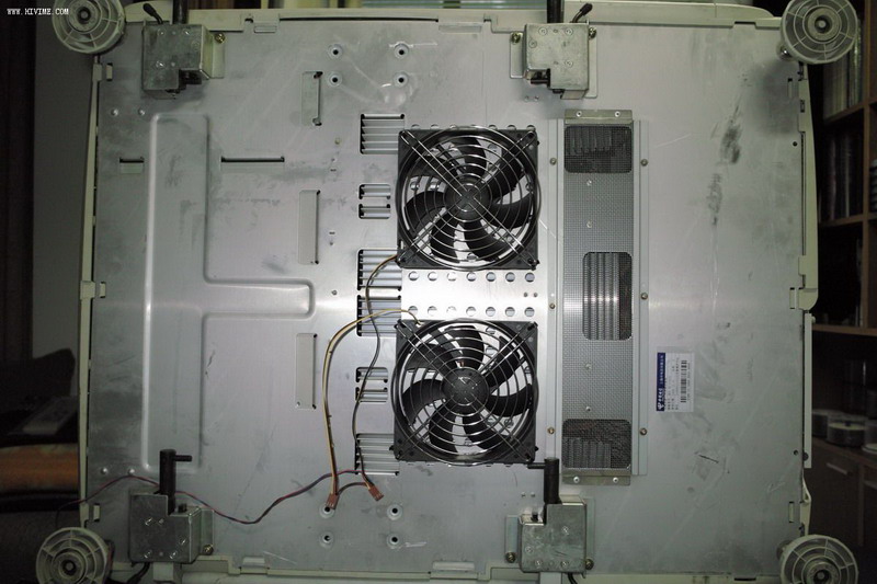

If you put a hush box on it , find a way to draw cool air the hot air will cook the boards. a fan under the mount drawing air into the adick will do fine.

Are the "after" CFM ratings provided by the manufacturer or actual measurements ?
Did you verify temperatures before and after, or are you just relying on the honesty of the ratings of the fan makers in whose best interest it is to appear to have great ratings ?
I ask this because everyone else who's attempted fan mods pretty much always discovers the replacement fans are actually deficient in some way, usually the CFM ratings given at a particular sound level are at 0 pressure levels whereas the stock fans are capable of overcoming much more static pressure at the given CFM. Without any static pressure power, it doesn't matter if the fan is capable of moving as much air, it actually won't and your temperatures will go up....Here's a good little discussion which clearly explains what I'm talking about:
http://forums.anandtech.com/showthread.php?t=2037695
So did you measure temps before and after ?

Posted: Sun Oct 16, 2011 5:11 pm    Post subject:
the"after"cfm is by the manufacturer .
i think the noise from the Panaflo, because the size is 8015, the fan blades is too thin so the speed is too high.
i MOD these fans and replace PAPST, the size is 8025 , almost the same CFM but lower speed, so lower noise.
I mod my XG110LC fans was in JUNE , i turn on my XG average 2 hours every day and 5 month later, especially pass through the hot summer, my PJ was still work in a good condition.

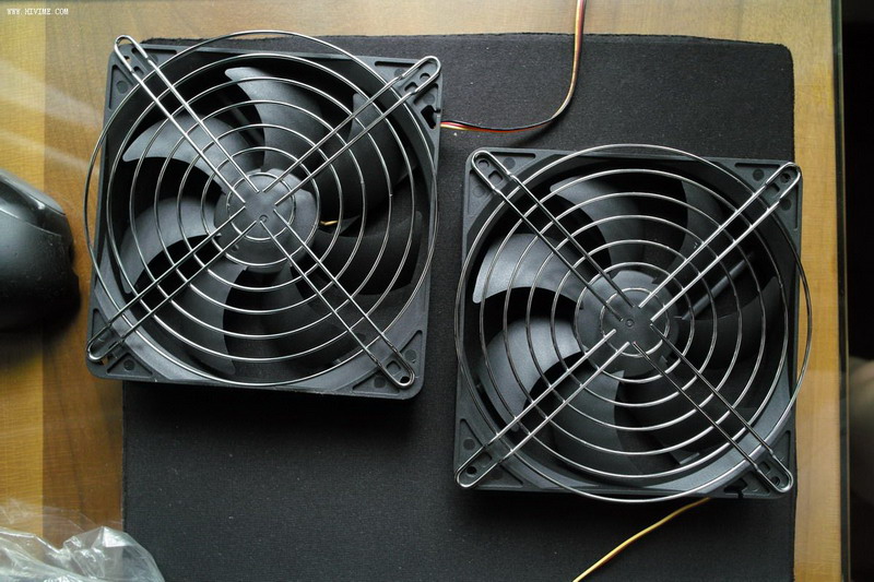

so I added two 14025 size fans under the base additional........

Posted: Sun Oct 16, 2011 5:56 pm    Post subject:

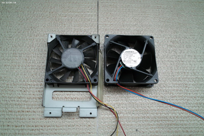

the manufacturer of FAN:
Panaflo FBA08T12H 80x80x15 0.95m3/min=33.5CFM 34dB 3100RPM Pressure 31.4pa=3.20 mmH2O 12v 0.26a
ebm papst 8412NGM 80x80x25 12v0.11a 2600RPM 34.1CFM 25.8Pa=2.6 mmH2O 26DB
the pic you can watch the difference of these two fan's size
