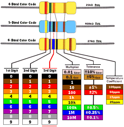

7 = Violet in the resistor colour code.

Thanks for the precise clarification guys, thats one minor panic resolved! Just could not figure that one out for the life of me. Glad to know I don't have to go out and buy a new set of contact lenses! Thats some whacked out camera though, no chance it could make be better looking rather than simply changing the colors I suppose??!! Very Happy
