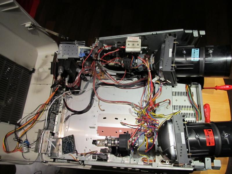

The slaughter has begun.
AARRGGghh, what a mess

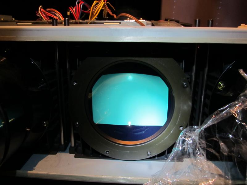

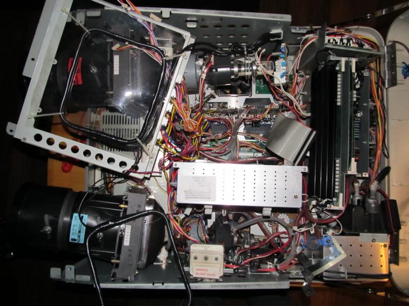

Okay, did it and didn't kill it.
Changed deflection, focus, convergence HV boards and cages for video and system boards, added the PGplus degauss board and shielding coils to the 10PG, the 10PG point convergence board went into the PGplus system cage. Some of the 6PG wires were too short for the bigger chassis, eg two cable from video to blue CRT neckboard and system - focus board connection.
As the tubes were all out I also replaced the original fans for quiter ones.
After first light up the picture was really big. Will have to reduce Amplitude with the v height pot. All menues look to be working correctly - what a relief.
