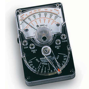

Posted: Thu Jul 28, 2011 3:49 pm    Post subject:
I'll get started on those diodes. One question i have is if this meter will help me at all?
 Filesize:  95.93 KB
 Viewed:  39 Time(s)
Posted: Thu Jul 28, 2011 4:31 pm    Post subject:
Sure, nothing wrong with an analog meter. Almost appropriate, fixing an analog set with an analog meter. Try and find a tech under 25 years of age that can read it though. Razz

Posted: Thu Jul 28, 2011 4:37 pm    Post subject:
Back in the day you couldn't beat the classic Simpson 260.
