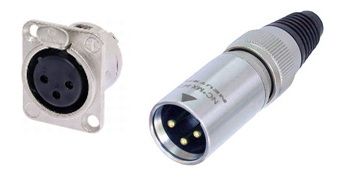

Hello Nash,
I would replace the output jacks.
First reason: The isolation requirement. If the outputs are all connected to the same potential (chassis ground) and the inputs and/or outputs of the powered devices carry ground potential too, You easily could run into a ground loop problem.
Second reason: The currents running across them. You've used quite small jacks and most of those are rated for 2-3A only. You wouldn't like to see what happens if over time they produce contact resistance and start burning up.
I therefore would recommend using XLR connectors (see pictures). They are available with contacts supporting 7.5, 10 or even 16A. They are secured against accidentially being pulled out, the contacts are isolated against the chassis and they are easy to solder the wires on.
Mouser part numbers are 568-NC3FP-1 for the sockets and 568-NC3FXX for the plugs (or equivalents of those).
I know, they are designed for stage/studio audio applications and You should put some warning labels near the sockets, but this is what I would be using. Especially if I already had put so much work into this project. You know: The marathon runner shouldn't try to run the last 100 feet on one leg only...

+1
I love using Neutrik XLR plugs for PS purpose, and if you have different voltage outputs, you can order with different amount of pins, so you cant connect the unit to a wrong supply voltage. you can get them with 3-4-6 pin.
