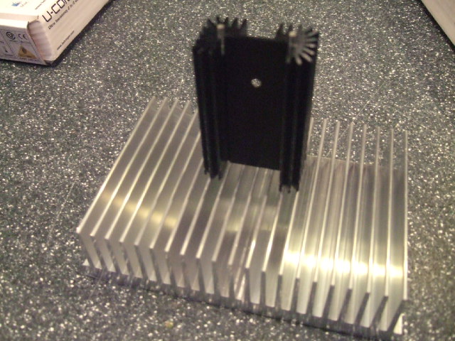

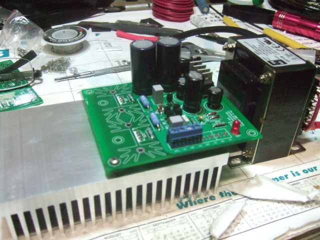

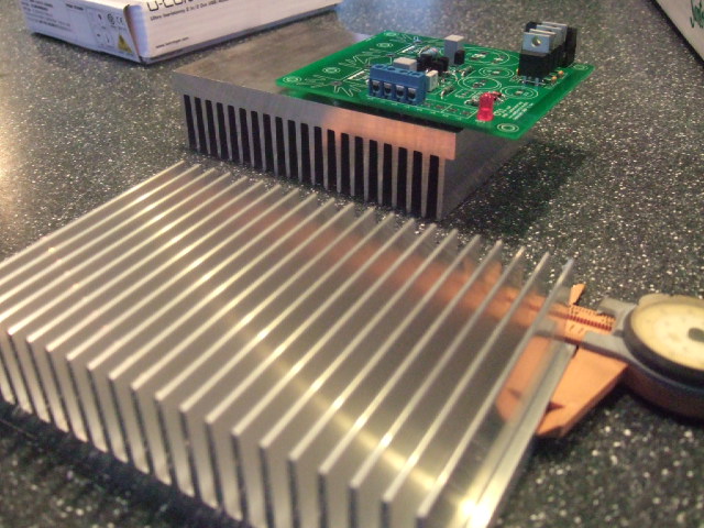

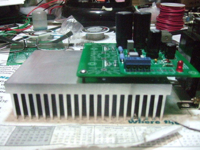

Got my Two Heat sinks in today. I have partial Board made up and think I'll place it on the heat sink
as so.
The Fins will face up and the Component side of the PCB will be upside down in the chassis.
I could put the board perpendicular on the heat sink but then I'll loose space in the chassis
for the two other boards. Perpendicular would dissipate the heat more evenly over the Heat sink,
but Again I'll loose chassis space.
I might actually have to cut the top away where the heat sink fins come out over the top
of the Chassis. Which I think I'd prefer. The logistics for fixing them to the chassis will come later.
If this chassis wont work I will get another and save this for another Project.

Posted: Mon Feb 04, 2013 10:36 pm    Post subject:
Nash,
Those look a lot beefier then the other ones you had that is for sure.

Posted: Mon Feb 04, 2013 10:41 pm    Post subject:
CxTurbo wrote:
Nash,
I need to finish up with all this Marquee business before I get going on mine.
James
Oh Yeah they are about three to four times heavier too!!!
I'll use the other PS shown previously for the Moome MUX.
And build two new PS's for the big heat sinks,
Comparison.

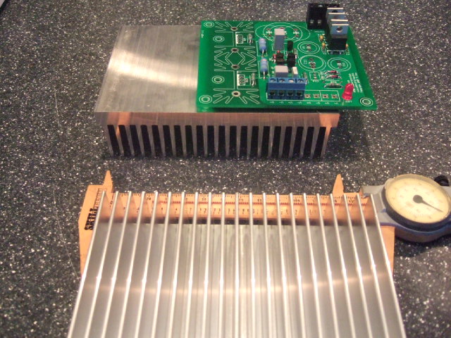

Posted: Mon Feb 04, 2013 10:50 pm    Post subject:
The price wasn't bad either compared to AVID directly. These were 2.35 per inch.

Posted: Tue Feb 05, 2013 8:49 pm    Post subject:
HK-Steve wrote:
Nashou,
I thought you were going to keep the heatsinks seperate from each other, not one large one?
I could split the Heat sink down the middle. it was cheaper to order a whole sink.
And Since the C/W is so much better and the surface area is over 4x the on board ones I used I figured
it wouldn't matter. Plus If it just fits better this way on the heat sink. It should be fine.
When I did the calculation for the original heat sink I thought it would be fine and it wasn't.

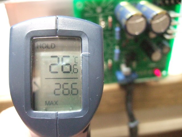

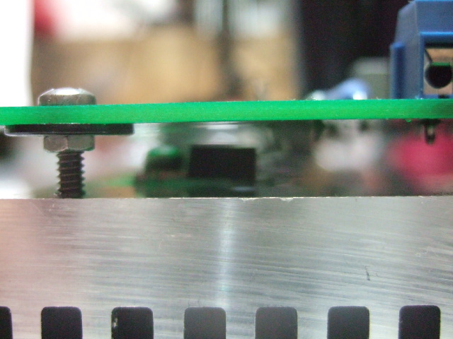

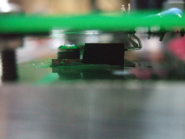

Posted: Sun Feb 10, 2013 12:59 am    Post subject:
Well I got it on the heat sink. Taped the holes and two holes for the stand off. I'll have to figure out what to do for the other
half where the stand offs are off the heat sink.
But I have a problem where I am suppose to get a reading off two resistors near the Mosfet . They read under 1 volt and should read near 7, but this is whats weird if i swap the lead of my multimeter so I put the ground to positive I get a over 5 volt reading.
the Output is at 5.8 volts and measures the correct phase of positive then negative if I swap leads.
I posted on the AMG forum so we'll see what they say.

Posted: Tue Feb 19, 2013 12:45 am    Post subject:
You wont believe what it was. Partsconnexion sent me the wrong resistors for R4 and R5. they are suppose to be 100 Ohm's
they sent me 100 Kohms and I never noticed till I started to build my third board. I put in some Vishay 1% 100 Ohm resistors I had fro some board onthe marquee and used those. i now get the correct range of voltages.
Arrggg So now I am going to replace them on my first build with the on board heat sinks and see how it runs. maybe cooler but I doubt it.

Posted: Tue Feb 19, 2013 6:48 pm    Post subject:
the heatsink fins should be in a vertical positition.
try to let the regulators to regulate as less as possible, this reduces pd.
Posted: Tue Feb 19, 2013 7:03 pm    Post subject:
Oh I know Dennis. I just have it like that in the pictures. I will have the entire assembly facing up In the chassis. Unless I buy another chassis that is taller and put the fins vertical instead if horizontal and facing up. I still can't believe I didn't notice the restores were the wrong ones!!! Dooohhh!!!!!!
Also the Transformer was suppose to have a 10 volt out parallel 20 volt out in series. But i'm getting 11.54 VAC in center tap set up.

Posted: Thu Feb 21, 2013 12:05 am    Post subject:
Well its much cooler but still gets warm. it went from 70c with those On board heat sinks to 26.6c with the large off board one. I should have went an inch wider!!! Wink
The next test will be to hook up one of the radiances and watch a movie. This was only about a 20 minute run.
