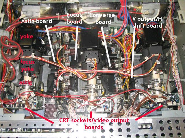

Posted: Wed Apr 20, 2011 3:15 pm    Post subject:
If it were me I would want to verify the focus board. I would swap the focus wires between the green and red, as circled in the pic below.

rungabic
Joined: 17 Apr 2011
Posts: 17
Posted: Wed Apr 20, 2011 5:46 pm    Post subject:
Hi Macgyver,
I'm still waiting on Curt to hear what repairing the board will cost -- I have no idea whether it's a relatively small expense or a big one...
But in any event, are you suggesting that if I swap those wires, and then it's my red tube that's defocused and jittery, then that confirms that it's the focus board, as opposed to something else?
I'm also quite curious what this would have to do with one input shutting down with the F9 code, whereas the other input remains on, but just looks crappy. And the input that shuts down (HTPC) does so even in the initial VGA-type resolutions it cycles through at boot up, so it's not the case that it's simply a matter of the higher-res input shutting down. It's encouraging (though still I don't understand) that someone else apparently had the same exact issue.
Anyway, besides the cost of the repair, I'm also concerned about how easy it will be for me to pull that board (or even just be able to do your swap-wire test). Curt said it can be done while ceiling-mounted, but it's a big PITA. If he's referring to it being a PITA for him, then it might be impossible for me (?) And as always, I'm concerned about whether I'm also going into dangerous shock territory getting inside there (?)
Thanks again for your help!
Brent

Posted: Fri Apr 22, 2011 12:07 pm    Post subject:
Hey macgyver -- wanted to let you know that Curt also suggested the focus wire swap test, simultaneous with your suggestion. I did that last night, and the blurry, jittery green became a blurry, jittery red, so apparently it's confirmed as a focus board problem. Still a bit of mystery why only one of my two inputs shuts down with the F9 code (especially since it's not just a resolution/timing issue, since that input shuts down at different resolutions, ranging from VGA on the HTPC bootup, all the way up to HD resolutions...not sure whether this can be explained, but I certainly hope that just goes away, along with the focus/jitter issue, once the board is fixed.
I'm now waiting for more specific instructions from Curt about each exact step necessary to pull the focus board -- I don't want to mess anything up now in the process. If you have any guides, feel free to let me know!
