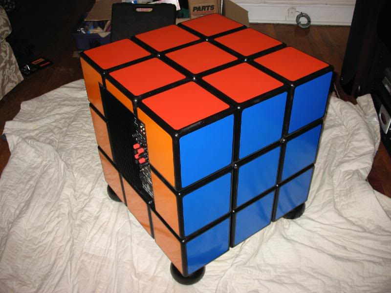

Posted: Fri Mar 18, 2011 4:44 pm    Post subject:
I like this one:
http://www.avsforum.com/avs-vb/showthread.php?p=11887670#post11887670

Posted: Fri Mar 18, 2011 4:48 pm    Post subject:
Yeah, that one's friggin' awesome if you have the right space for it. Another guy used the same design and did one with a different color scheme that was also pretty kick-ass.
Posted: Fri Mar 18, 2011 4:52 pm    Post subject:
Oh and in case anybody is wondering how big these really are, my daughter Kaylee is a little over 48" (122cm) tall.
