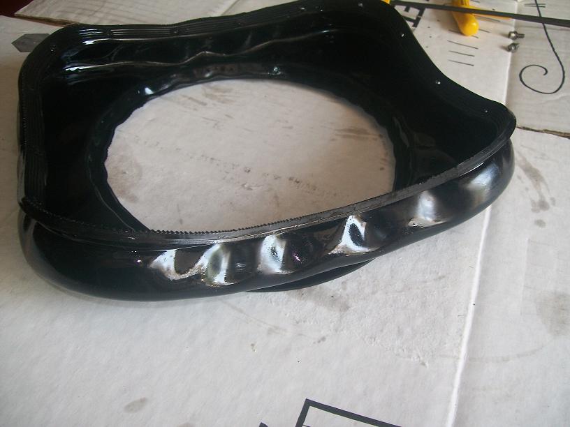

Soooooo I put my minty tubes and my minty new c-elements and my minty new bellows together, a few months ago and added the Cargille index matching fluid stuff. Also did the power suppy mod at this time. Put everything back together plugged it in, turned it on and............................thats when i finally understood what you guys mean by low emmissions. ugg.
So I let it sit in the garage while looking for some used tubes I could afford..........yesterday. I noticed the puddle. Looks like the bellows almost melted? severely stretched? The first one that I took apart had no rips or tears- just looks deformed.

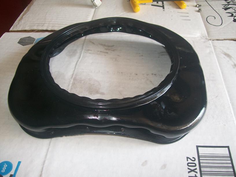

Posted: Sat Apr 14, 2012 8:07 pm    Post subject:
pic

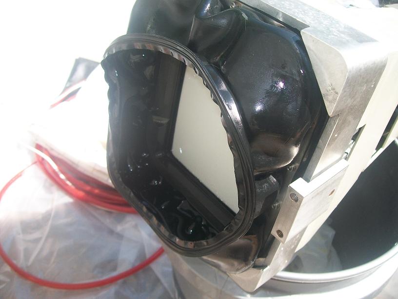

Posted: Sat Apr 14, 2012 8:08 pm    Post subject:
pic

Posted: Sun Apr 15, 2012 1:38 am    Post subject:
WOW, Can you send me a sample of the Fluid you used and one of the bellows back and I'll send you a replacement set.
I want to give the fluid to Apple Rubber for testing. they said this material should hold up to most liquids.
Also pull out the any boards that might have got that Cargil stuff on them!! Damn no one else use that stuff!!!
PM me your address, I'll send out the new bellows on Monday.
Posted: Sun Apr 15, 2012 1:47 am    Post subject:
Just looked more closely at the PDF file it says not compatible Silicon Rubber, this material is a mixture of that from looking at past emails between apple rubber and I. It is better than the original bellows but not made for that Cargil stuff it seems. It be interesting to see what Dale will say. First set that failed from over 200 bellows sold!!
