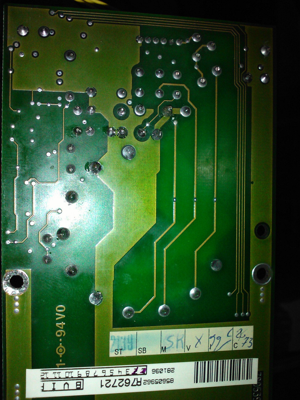

Here are two neck cards of two 9" Sony tubes. If you look very closely at the SD146a neck card you can see it is labeled and has pin 9 connected to g1 (pin 4 is lower right and pin 5 is labeled g2). If you look at BG808s neck card you can see pin 9 is not connected. Sorry I cannot put label on picture at the moment.

Posted: Sat Jul 02, 2011 12:56 pm    Post subject:
Perhaps there's a connect to other side of pcb (BG808s) because pin 9 inside tube is surely G1 (see my pictures), unfortunately my pictures not show pin n.13, sorry.
Pinout appear the same in your pictures both in two necks with only one difference.
In SD146a pin 9 and 13 (G1) appear jumpered, not same thing in BG808s neck
Perhaps in BG808s G1 is connect only pin n.9 instead in 09MEX2 G1 connect both 9 and 13, I don't know.
You can try to add jumper from 13 to 9 in BG808s neck like SD146a.
But in your own risk.
Domenico (Barco fan!)

Unfortunately I have only picture of back PCB BG808s

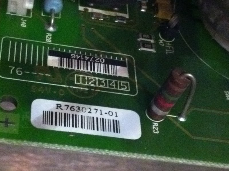

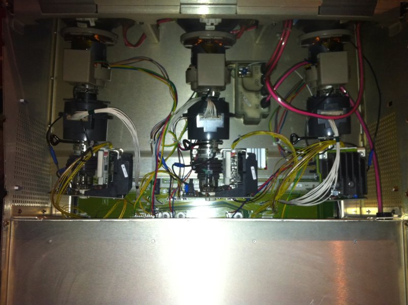

Posted: Thu Apr 05, 2012 2:57 pm    Post subject:
More about pinouts.
Here is an oddity.
Look the red and green neckboards, they are rotated 90 clockwise respect the regular blue.
The PCB is different of course. Part number is R7630271-01
I shoot these photos some days ago, the projector is a Barco Reality 909, tubes are P19LPB's.
 Filesize:  91.47 KB
 Viewed:  12718 Time(s)
 Filesize:  86.83 KB
