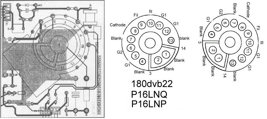

Are you sure?
I have service sheets of the 1209s (R762839 Lug's compatible) and 808 (R762508) sockets and both numeration is ever counterclockwise like my picture.
I think that this is standard.
I would to modify Sony 8" neckboard for use it in 9" panasonic tube, so I would to be sure.
Can you show picture of your sheet?
R762508
R762839
Domenico (Barco fan!)

Decibel wrote:
...and both numeration is ever counterclockwise like my picture.
The numbering will always appear mirrored!
If you look at the pinout sheets of the tubes they always show the pinout when looking onto the socket pins of the tube (that's when you hold the tube in the way that it's screen surface is oriented away from you). When you look at the socket on the neck board's component side, the numbers must be mirrored because now -if a tube was plugged into it- you would be looking at it's screen surface (180 degree turn)...
Regards,
barclay66

Posted: Wed Jun 29, 2011 7:31 am    Post subject:
Even I had thought of this.
But it is impossible to fail, because if you look the service manual that I have shown, you will realize that if you show the socket in back side it will appear in an different position (see pin 1 and 2).
So what you see in the service manual is surely the position seen from the socket side.
So I think that sheet with the pinouts of the CRT 9" is wrong.

Posted: Wed Jun 29, 2011 9:07 am    Post subject:
If you compare the socket of the 180DVB22 with the Neck board R762508 from a BD/BG 808 you will see the following:
- The service manual shows the Neck boards component side
- The tube pinout is mirrored because if you plug the neck board onto the tube you will then see the boards solder side and therefore will experience a 180 degree flip
The picture below shows what I'm thinking of. To the left you have the neck board (originally component side, so I flipped it 180 degrees -> solder side). In the middle we have the socket pinout. Now you just need a 90 degree turn and you have a match (right picture). So all you have to do is to compare the neck boards with each other and the tubes with each other...
Regards,
barclay66

Decibel
Joined: 31 May 2007
Posts: 904
Location: Roma - Italia
Posted: Wed Jun 29, 2011 10:38 am    Post subject:
I regret not being able to express in proper language what I mean.
The drawings, plans, sheets are written to understand the concepts without subjecting them to different interpretations.
We are interpreting what is written on that sheet.
That sheet does not say if we must to see the pinout from the socket or directly to the tube.
Conventionally, I think that we should consider the tube placed horizontally on a table.
That design would suggest that we should look the pinout from the socket (or from tube face).
Why?
Because otherwise the 9" schematic it should appear mirrored (with the pin 1 and two placed high at right).
In the sheet position, if we look directly to the tube, it placed vertically!
The only thing certain and correct is the sequence of the pinout, that is the same in both clockwise and counterclockwise.

Posted: Wed Jun 29, 2011 11:08 am    Post subject:
seems to me too that we're not getting far with this. In this case I recommend using km987654's approach:
- Ignore all pin numberings either visible or not
- Plug the Neck board onto the tube
- Visually inspect which pin inside the tube is connected and where it is going
- The filament pins are easy to identify
- The pin that connects to a point nearest to the filament is the cathode
- The next part connected to one or more pins is the G1 grid. It is next to the cathode but farer away from the filament
- Next to it and even farer away than G1 you will find the G2 grid which will be connected to at least one pin
- After identifying the pins compare their location with the CRT socket on the neck board and the schematics
I hope this helps...

L'unica cosa certa e corretta è la sequenza della disposizione dei pin, che è lo stesso in senso orario e antiorario.
This is very confusing because the tube pin numbers are 1 to 12 yet schematics of the neck card show 1,2 then 4 to 13 there is no pin 3. This is why I have suggested using a visual inspection of the tube.

Posted: Thu Jun 30, 2011 8:09 am    Post subject:
It seems that Panasonic have numbered also those totally missing pins 3 and 14, those that aren't there because 1-2 pins enclosure reserve those places. Very Happy
Sony numbering skip those missing pins.
http://img862.imageshack.us/img862/2829/pinoutcrt9.jpg
