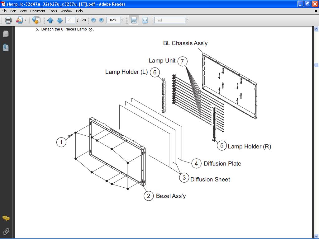

Posted: Sat Jan 15, 2011 11:06 pm    Post subject:
Here's an image.
 Filesize:  78.5 KB
 Viewed:  80 Time(s)

Posted: Sun Jan 16, 2011 4:22 am    Post subject:
Ok Got the front panel off. One lamp is out, but they do not look cracked or burnt. I caught this pic just when the lamps were turning off.
And then i took a pic of the LCD panel of the snow while it was frozen as the unit shut down. I was under the panel looking up as my shop light shown down. No reason just thought it looked cool.
So not sure if the lamp is dead or the power for that single lamp.
but while it was powered up i saw the ANT and Channel 3 on the LCD panel.
Si it definitely is the PS or Inverter not keeping the lamps on.

Thanks Guy's, Mac, I think they are socketed individually . Those 10 black "boxes" on the right side of the inverter go to each lamp in the assembly. From memory I did not see any wires to each lamp, not sure how they are fed power. But I may have just overlooked it.
you can seethere are 5 transformers so i think you might be right about one driving two lamps. I'll check if they are in series.
Curt I hope its not a lamp as it looks like a real pain to get them out on the socket ends. I think I'd have to remove the entire assembly.
Still at work, so I'll check back later.
Posted: Sun Jan 16, 2011 9:59 pm    Post subject:
Ok they are in series. On the ends I thought it was one complete assembly but I looked closer and the end covers come off and expose each socket. they are like the sockets used for fuses and just snap in.
the right side of the assembly is where the PC board that connect two lamps in series.
I could remove the bad lamp and swap it into another location just to be sure. those things are delicate and I have some thing else to go to now, so I'll do this later and report back.
