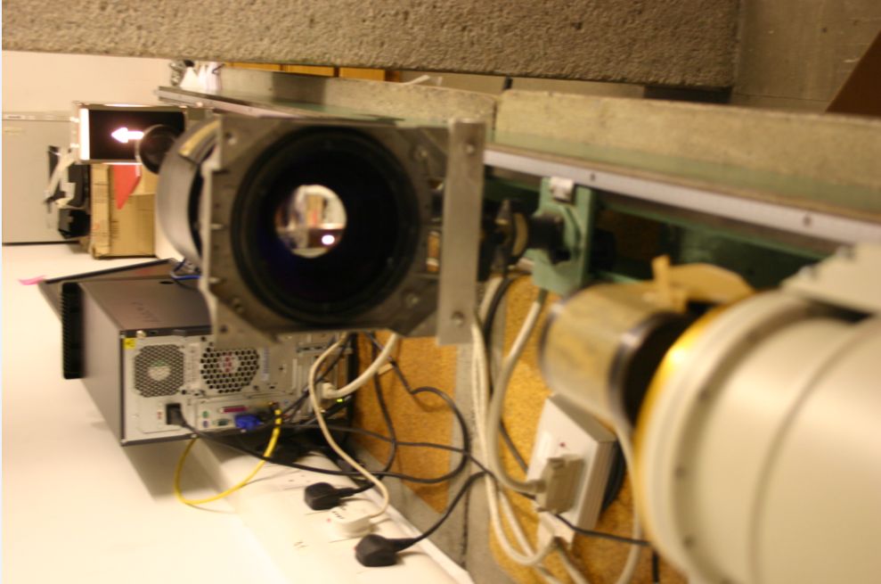

Posted: Mon Jul 04, 2011 10:51 pm    Post subject:
Guger if you pm me, I'll send you a copy of my thesis, so you can see some of the issues I had and the methods I resolved some of them.
But in brief, the project was somewhat of a success. I had a working setup, but I only had time to do lab testing, no field-testing, so there were errors on my measurements due to the approximations on infinity in a lab setup. And there was no full quantification of aberrations with the system.
My setup was designed to be used for detection of a specific astronomical event, so for an amateur astronomer, my setup and the data I collected may be of little use.
I calculated an angular resolution of 400 arcseconds, and my field of view, with the extra glass added, was reduced from the 52 degrees of the CRT lens by itself to 16 degrees.
Now these were acceptable values for the intended application, but they may not suitable for yours. And whether you could even replicate these values is another thing entirely. I had professors specialising in optics and astronomy helping me, along with technicians, and expensive pieces of equipment.
The reason the CRT lens was used, was that my advisor wanted to get a student to design a wide-angled lens system on the cheap. So the setup was designed to keep that field angle of the delta lens as wide as it could be. Several roadblocks were in the way of this objective, the most problematic being the issue with the image plane.
When the object your are imaging is at infinity, which it would be for astronomical purposes, the image plane was inside the lens. There was 2 solutions, either place glass in front of the lens, so the object would appear to be at a finite distance, bringing the image outside of the lens; or using glass to the rear of the lens to take it out. The former was out entirely, would restrict the field of view too much, negating the whole point of using that lens. The latter was the method used, I had a relay lens, taking the image out the CRT lens, focusing it onto the sensor.
I didn't have time to design a relay lens, so I used one that was hanging around the department. This proved the biggest limiter on field of view. I had some time after experimental working ended to start working out the specifications a 2 element relay, and only managed to get the equations for the curvatures according the the raytracing of the axial marginal ray from first principles Sad But this wouldn't have been that useful, even if I had worked out some concrete specifications, as I don't actually know how to correct abberations with design specs yet Sad so the relay lens would have been aberrated to h***. (At least the HD-8 was somewhat aberration-corrected)
Umm, so for tl;dr, unless you want a wide-angled field of view, and have the resources to get the necessary equipment(good relay lens, and good sensors), I would say that you are better off buying a telescope.
If your curious, attached is a somewhat blurry photo(sorry) of my setup in the configurations i used. Note how small the relay lens is, which was of course the biggest limitator of the system.
Imaging_System
