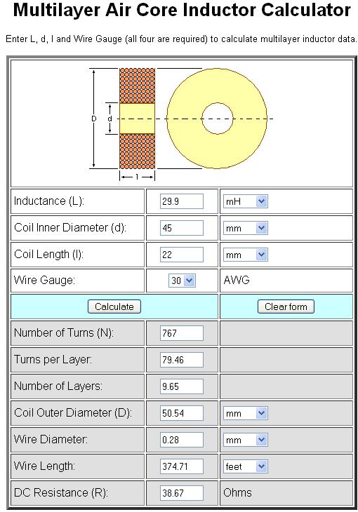

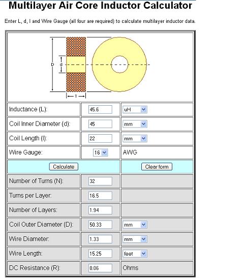

Posted: Fri Feb 05, 2010 3:15 pm    Post subject:
Well I am going to begin once again on this winding of the Barco coils(Barkenstiens).
I am using this winding calculator;
http://www.pronine.ca/multind.htm
Or this one:
http://www.circuits.dk/calculator_multi_layer_aircore.htm
I still have the old winds in them using 32 gauge wire for the Static coil, i do not remember what I used for the dynamic, it might have been 30, not sure but i do recall it did not cover the entire bobbin. I believe this is the reason i am having edge focus problems, i need to go to 100 in the RGB focus menu if I remember
correctly, i know it was at the max of either range. I need to start taking detailed notes Wink
One thing for sure is the Barco 1208 magnets are much stronger than the Sony 1292 coils, they match the stock Marquee coils very closely. Too bad the windings for both are off so much.
To use the calculator you need to know the inductance your shooting for, the bobbin dimensions, length and Inner Diameter and the outer diameter once you press the calculate button, you dont want the coil larger than the bobbin edges.
Measurements
I=22mm
d=45mm
D=50mm
Inside Diameter of the actual magnet core is 53 mm so the outer diameter of the bobbin could be a bit larger than
50mm.
the static value of the Thompson coils
29.9mH
Dynamic value of Thompson Coils
45.6uH
The great thing about this calculator is you can try different wire gauges and slightly lower or higher inductance values
to get the right final Od value of close to 50mm.
I think this would be handy to tune each wind to the strength of the magnet if you can't get them re gaussed.
by putting the focus magnet on the tube with no connection you can get a rough idea if its weaker than the stock
coil. So if its weaker you might try to get more inductance or lower ohms to get more current to flow creating a larger
magnetic field. if its just right then keep the values as stock.
Hopefully CJ will help out in the re-magnetizing of the cores once he gets his rig set up in a few months.
here are some screen captures of the wind calculator with the values I plan to try out.
I think I'll go to 30 gauge for the Static and 16 or 18 gauge for the dynamic, I feel the Dynamic is much more important to find the perfect values. this is where I am getting issue on the edges, more current might fix it hence the 16 guage wire.
I also have to look to see what HVPS i have in this test chassis, it might be a 34KV one i had laying around if so that also could be part of the problem for a 9 inch Thomas tube which requires 34.9KV

Posted: Sun Feb 07, 2010 1:49 am    Post subject:
A couple of thoughts about focus mags.
1. The static and dynamic windings need to be near the nominal value. Especially the dynamic. The amplifiers are designed to drive a specific inductance.
2. Lower resistance in the windings will help the static most. Less doesn't hurt the dynamic winding but there isn't any big advantage to be gained. Use the size wire that fills the bobbin.
3. If the top/bottom and left/right focus settings are best at "0" and need to go more there is a good chance that the winding is wired to the amplifier wrong. Reverse the coil connection to the amp.
