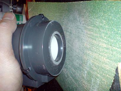

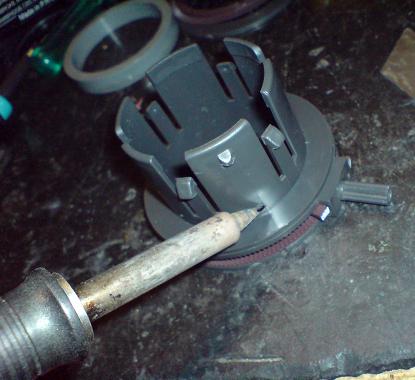

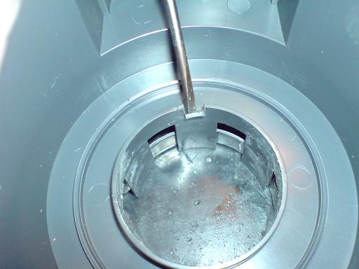

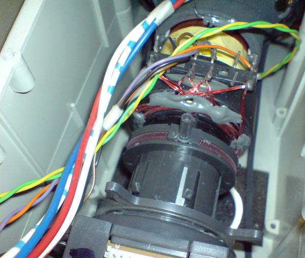

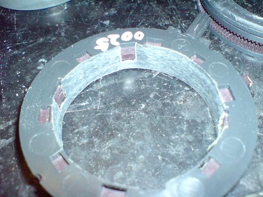

Hello. I had finaly some time to install those 1292 sony yokes to my 9500lc. Yep much more thigter spot and more usable contrast now Thumbs Up
But i miss that magnetical rastercentering that those thomson yokes had Sad
While 1292 yoke shifts raster when turning it, it doesent give good enought results, i had use too much electronic centering (that firts point of convergence..)
So i think what about using one 2-pole set for rastercentering? There might be just enough room for 2-pole magnet is clamp for convergence yoke is removed
I have never understandet what is difference between 2-pole and rastercentering magnets (ok those are at different places at tube neck and therefor do different things). I had some yokes from Es-focus seleco and those had raster centering magnet rings before convergence yoke so i tested if i put 2-pole rings near marquees convergense yoke and see how it works.
It works Thumbs Up But i havent tested that yet in my main machine yet
Experts what do you think can 2-pole ring there (between focus yoke and conv.yoke) still affect to beam shape?
Some pictures...

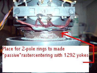

Here is picture where i thinked to put that 2-pole set

Posted: Mon Mar 30, 2009 11:02 am    Post subject:
It could work jarmo, but see the clamp you have there now for holding the convergance magnets. I took that out when testing and reamed out the center edge of the 1292 so it fits over where the clamp is. this puts the 1292 closer and also give even more focus. i used a round edged file to make more larger diameter inside of the 1292 yoke. , My centering wasnt too far off with them either. But your idea is kinda cool.

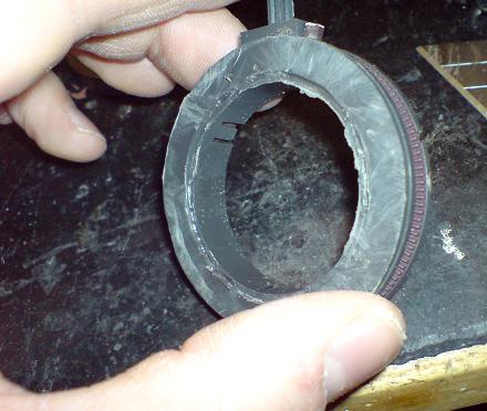

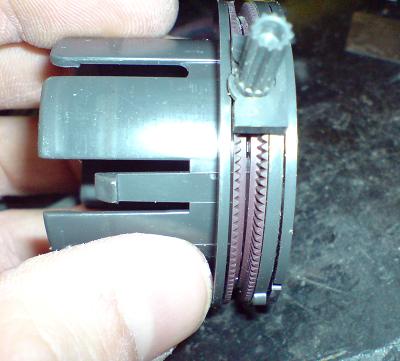

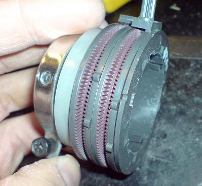

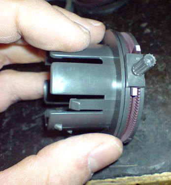

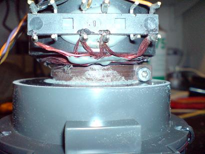

Posted: Mon Mar 30, 2009 11:23 am    Post subject:
I sanded that clamp so its about 2mm thinner now..
Here is some pictures, i tested that quick and that 2-pole seems to work ok for rastercentering (tested with marquees stock focus yoke)

Scott do you know how are those raster centering magnets magnetised? I tested with paper & metal dust and those raster centering magnets looked about same than 2-poles.
Nashou, It is possible that modding 1292 yoke to fit over that convergence yokes clamp area (to get focus yoke more forward) that it doesend shift raster so much. Hmm i have little dilemma now.. If i push yoke more forward then i got better focus range (less electronic adj. needet) but then there is no room for my Diy rastercentering magnets Question
Lets see how it ends Smile

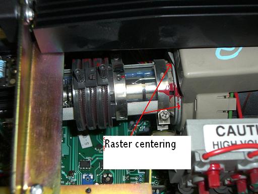

Magnets are from vnb-> 4-/6-/2-pole -> tube front.
I flipped that magnet assembly 180degrees inside sonys housing( thatīs why that http://www.curtpalme.com/forum/files/frankenyoke_casing_mod3_294.jpg picture shows that little noch that i made). That looked best on my testbench, when i tested stock 1292 yoke (magnet assembly as original position) then raster was not horizontal..
I think that raster centering is best to do after focus yoke. Then that centering field (in theory) cannot affect beam shape so much Least all projectors that have passive centering system (rastercentering rings) those are placed before convergence/deflection yokes

Posted: Mon Mar 30, 2009 2:16 pm    Post subject:
Yes, you can flip the yokes but then i am wondering if the static coil vs the dynamic coils are in the wrong possitions. I think it is actually better to rotate the Deflection coil and leave the 1292 yoke as is so its the Static coil>dynamic coil> tube. My theory is that the static coil does the rough focus and the Dynamic
takes that rough focusd and fine tunes it especialy on the edges. what do you think?
So the raster centering is closer to the neck board or tube face , what do you think would work best?

Posted: Mon Mar 30, 2009 3:46 pm    Post subject:
Two pole magnets are used for raster centering when between focus mag and deflection yoke. The same two pole magnets are used for beam centering (flair) when located behind the focus mag. This looks like it is on the right track.

I tested every possible configuration how those 1292 yokes could be installed
1. stock orientation, conv.yoke clamp removed and focus yoke pushed as forward is goes.. Best center focus at 24 ( in service focus adj.) picture focus was at 50 all time. Rasters of about 30 degrees and side focus there seems to be enought range to proper focusing.
2 coils flipped 180degrees inside sonys housing. clamp removed and yoke as forwed as it goes. Rasters horizontal, best focus at 21 and side focus range is ok.
All those had rasters too much off center.
3 Stock orientation, my diy raster centering magnet at place of convergence yokes clamp.. rasters of same 30 degrees.Best focus at 26.
4 coil flipped 180 degree and diy raster centering ring in place of conv.yokes clamp, rasters near horizontal (maybe of by 1-2 degrees) best focus at 19-21
Best part. raster centering is easy as.. well lets say riding bicycle Thumbs Up and it doesend affect flare setting near at all. also very little 2-4 pole adjust is needet. There was still very little raster shifting when ramping focus up/down but all colors moved similar.
So those 1292 yokes when turned around tube neck move raster, but in my case those just made "circle" around point where i wanted raster center to be, with that diy rastercentering ring that was so easy.. I was able to center red/blue over green so good that only 2-4 clickīs electronic adjusment was needet.

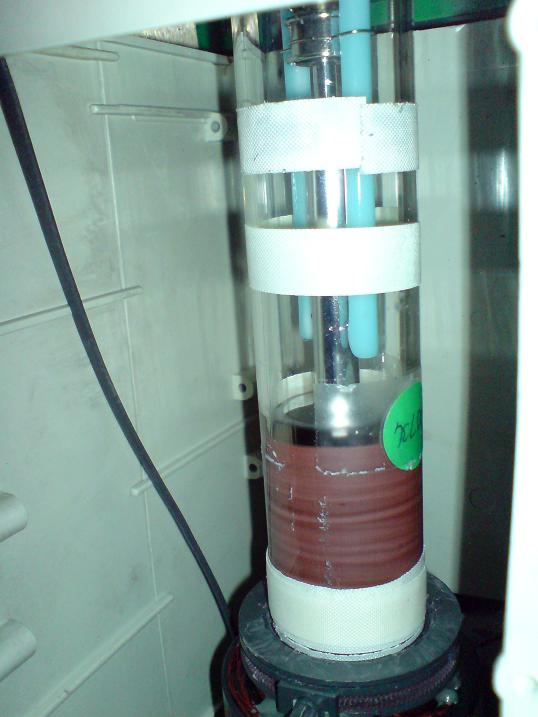

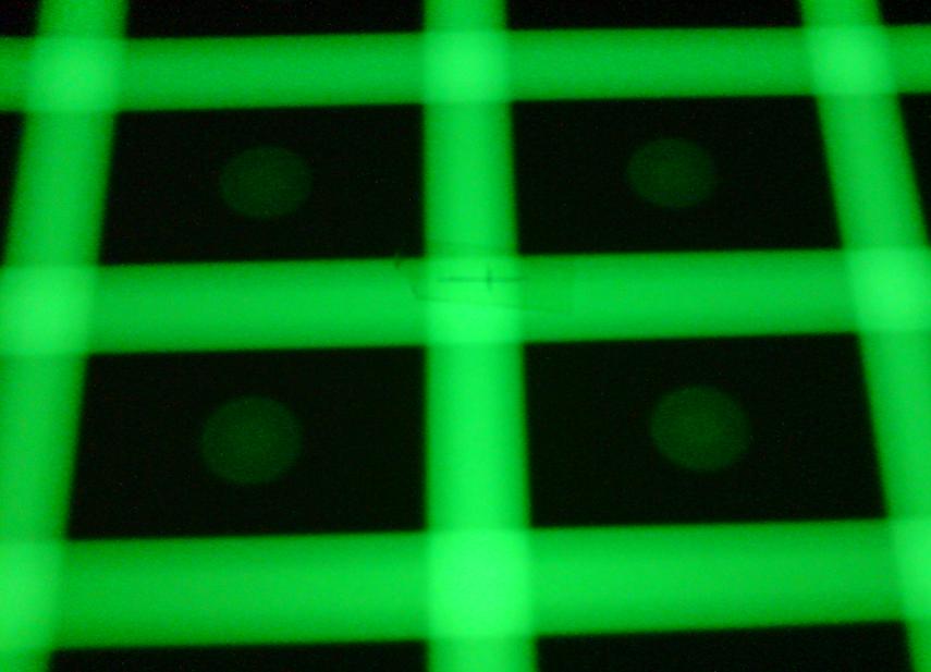

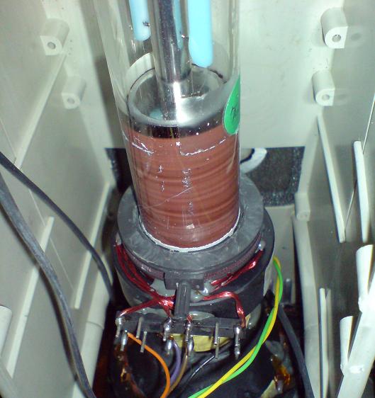

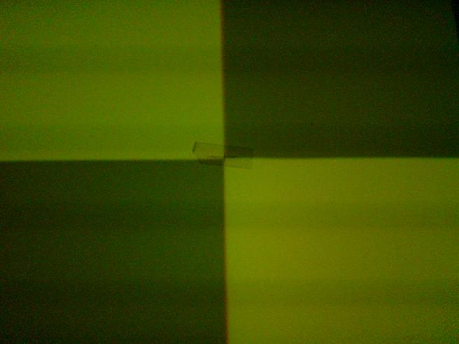

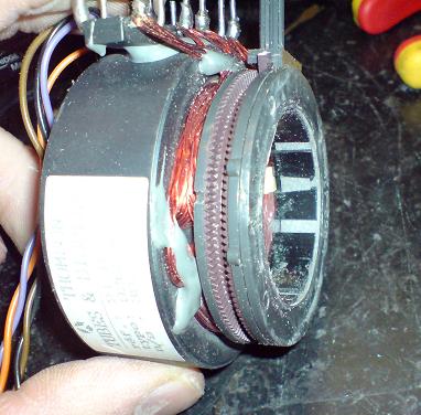

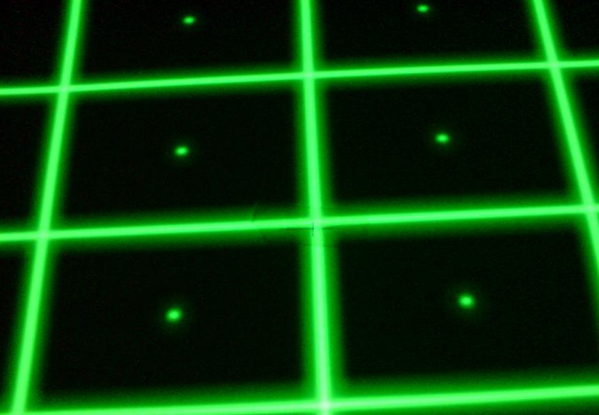

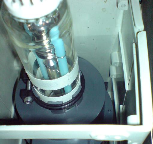

Here is little more project pictures. Only thing that is little worrying is that i have to use max/min values to side focus to get best focusing. Example Green needs to push up to 100 and seems that if that ajust has more range, that could give tad better results. Maybe tweakin values of those "resonant caps" at FCM is what is needet to get more side focus range.
I used glass cloth tape to secure focus yoke in place, so that it fits perfect and connot move at all.

I wonder of you take out centering ring if edge focus improves?
1031
Posts: 657
Location: Finland
Posted: Thu Apr 02, 2009 7:12 am    Post subject:
It has no effect for that, i tested that Sad Biggest difference for edge focus was that, if coils inside housing was as orig. or 180 degrees flipped. And that does not make big difference at all. That side focus thing is not big issue, just last adjustment for fine tuning is missing. Also those old hd-10 lenses doesend help there..
