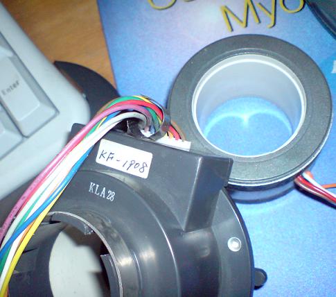

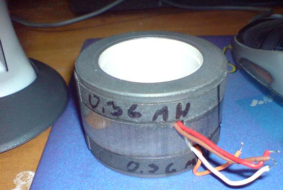

Athanasios, here are pictures from those yokes that we discussed. I havent opened those yet but inductance seems to be too low that those work on marquee. Also that yoke is not so long that KF22-22 is ( no stig windings)

Those look like an ampro Yoke. You can test the magnet stregnth on a tube with no connection tot he coil. if it has some focus like the picture further back of a red grid i posted it can be rewound to work in a marquee with no astig amp and get better results than the stock coil. The Yoke from Nec's and G70's are similar also but have a smaller diameter plastic bobbin. Does anyone have the diameter of those smaller necked coils?

Posted: Tue Dec 02, 2008 1:41 pm    Post subject:
Those came from Ile´s Barco 1200. I test those later..

I just found a set of KF3203's so i am going to make a complete set with both windings to the marquee spec's once they come in. Then If i have time I plan to actually install them into my Theater PJ so I can see on screen how they look, also i will compare them to the stock Thompson yoke and the Sony 1292 Yoke.
Just looking at the tube face of the 8" tube it looks great but you really cant tell till you add lens's and throw an image.
I will also take inductance measurements for them since i never did with the one I have and add them to the
data from the other types listed by Joust and Nuttall_Chris.

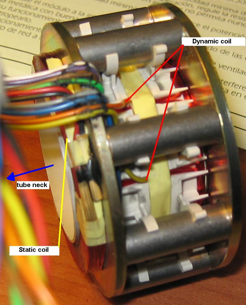

I have a set of Barco yokes that I would like to rewind the static and dynamic coils to convert them to “Barkenstein “ yokes Thumbs Up .
I think you are right regarding the coils orientation.
After reading your post, I checked the original coils orientation in the Barco KF-3203 and in the Thomson yokes and as you said the static coil is first (closer to the neck) and then the dynamic coil.
If you have a set of Frankenyokes and you opened the housing to reverse the complete magnetic/coils, then the orientation of the static/dynamic focus coils is not matching with the Thomson yoke orientation (dynamic coil will be closer to the neck).
Maybe somebody who has a set of Frankenyokes could try to reverse the magnetic rings and then reverse the coils inside the magnetic rings and see if this improves even more the focus. In this case the frankenyoke will have the same magnetic polarity and coils orientation than the Thomson yoke.
I don’t have the KD 22-22 yet, I will receive them soon, but I believe they are identical internally (I mean the coils orientation).

Posted: Wed Dec 10, 2008 8:58 pm    Post subject:
I copied my reply to a PM DPG and am posting it here as it is a response to the above post ,
I still would like a picture of the Grid from an non connected Frankenyoke as i
need it as a confimation to my own testing , I'll let you know why later. Wink
I am glad you checked the Marquees static position as I was just going to go in my work shop and investigate!!
You saved me some time!!
Now On the Barkenstien's two are the same polarity magnetically as the Frankenyoke's
but Barco set the Green(KF-3203G) in opposite polarity for some reason. Maybe they found you can get better focus
with each tube in opposite polarities relative to each other's magnetic field , This may help the Marquees
too but then we'd have to rotate the red and green deflection coils to make it all even.
I swapped the ones around and got a little better focus but I think my test Barkenstien coil
has a weak static filed , but its interesting that my Frankenyoke's have the same strength
as the test Barkenstien. What does this all mean? I wont know till I rewind one of the new Barco coils
and turn it into a Barkenstien coil. But I think even the original frankenyoke's will benefit from a rewind of the static at least, the dynamic is very close already. I have an extra Frankenyoke I pan to rewind as well and flip the coils inside around too so they match the Static/neck Dynamic/tube face orientation.
I have not heard From Scott yet but i don't think i need to, I pretty much figured it out and
was 99% sure about the marquee static/dynamic orientation...it only is common sense if you think about it.

First of all Merry Christmas to everybody.
Finally I received the set of KD 2222 focus yokes, but I have some doubts about how to install them. My options are:
1- Open the focus coil housing and rotate the complete magnetic 180º. Most of the people here did this, but in this case the position of the static coil and the dynamic yokes will be reversed compared to the Thomson coils. (Static closer to the bell and dynamic closer to the VNB).
2- Install them as they are and rotate the deflection and convergence yokes, but this could have side effects because of the reversed magnetic field.
Anyone here installed the yokes in this way? Any side effect?
3- Open the focus coil housing and the open the magnetic rings, swap static and dynamic coils inside the magnetic rings and then place the magnetic rotated 180º (this will have exactly the same coils and magnetic field orientation/position than the Thomson yoke).
Also a friend recommended not to separate the magnetic rings, because they could lose some strength.
Any help will be appreciated.

Merry Christmas to you DGP!!,
The easiest way to keep the static coil in front of the dynamic and have them work better is to put them on as is and rotate the deflection and convergence coils, its less work and wont disturb anything inside the focus yoke.
Taking apart the magnets wont hurt the strength if they are not apart for long, also i take them apart and put them
back together while i am working on the coil windings and found no difference in the static focus.
