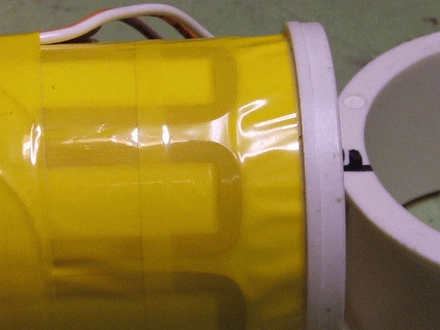

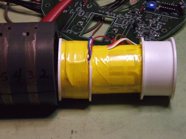

Posted for reference. The 2222 version focus mags have dynamic stig windings. A couple of pics showing the extra bobbin and windings in the 2222. There are two sets of four windings with one set arranged in a "+" fashion with the other set in an "x".
Scott
Scott
hey, why is your dynamic coil bobbin naked?
are you planning on rewinding it?

Joust wrote:
Scott
That focus mag is a relic from the Ampro days. There were always plans to add dynamic stig to Ampro projectors but somehow it never happened.
Scott
