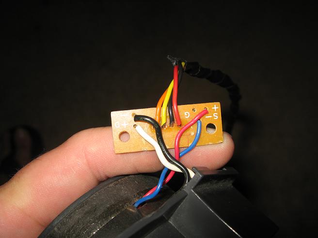

Could be. I remembered that I lost the ground wire that attaches to the magnet. Figured it would not be a big deal for something that was only a test to see if I wanted to go further or not.
This is the connection I made------->

Posted: Sun Jul 22, 2007 5:25 pm    Post subject:
i used the sony harness on mine so that does not look familiar. IIRC the black and red are the higher resistance windings.
simply measure with a ohm meter. that winding should measure much higher resistance than the other.

Posted: Sun Jul 22, 2007 5:37 pm    Post subject:
pin #3-5 red - black Static Focus 14.75mH 56.4ohm
pin# 7-9 Orange - Yellow Dynamic Focus 41uH 0.38ohms

Well, when I set my meter to 200 OHM and at the Marquee connector, I pin between Red & Black, it gives me a 63 reading.
And when I pin between Orange & Yellow, it gives me a .4 to .5 reading.
This is good? Very Happy

Posted: Mon Jul 23, 2007 3:17 am    Post subject:
yep, sounds good
