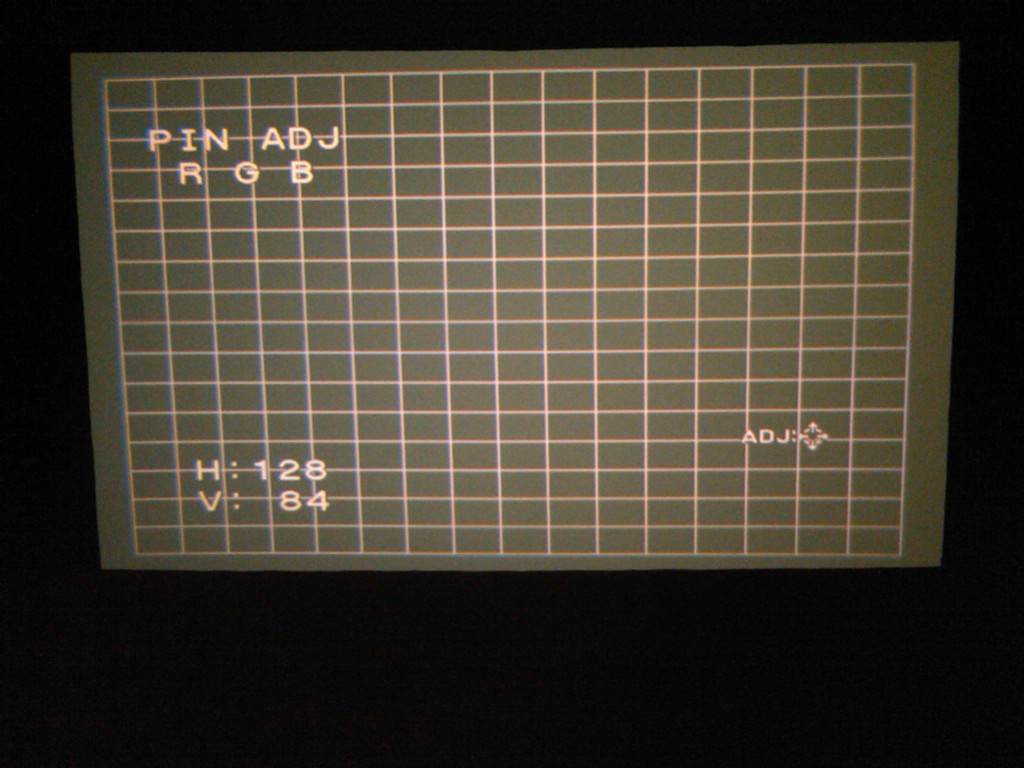

ok here goes
pic
 Filesize:  137.35 KB
 Viewed:  6883 Time(s)
We are ALL job creators !
jeffslife
Joined: 17 Apr 2010
Posts: 4190
Location: ohio usa
Posted: Thu Nov 04, 2010 4:46 pm    Post subject:
I know the pic sucks, I took it with my BB.
I had red and blue outside of both corners
after redoing registration. Following the manual I went on to zone and corrected
most of it. But I know from previous posts how everyone feels about that.
I spent 3 hours trying to adjust it out with key and pin and got it
as good as I could before moving on to zone.

That's actually pretty good. Smile
Looks like the bottom of the pix is pulled in a bit, can't you correct that with the green keystone control left and right?
