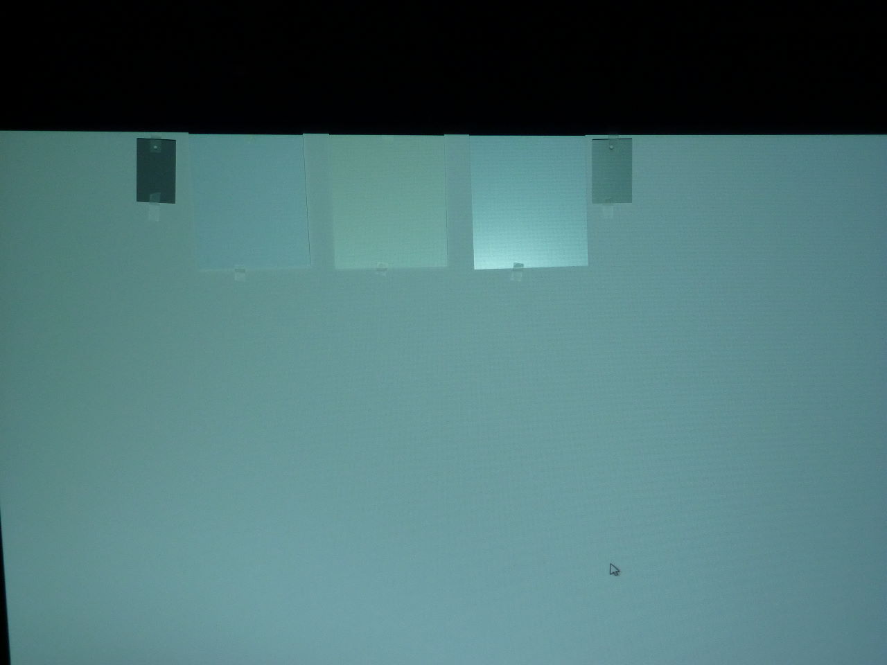

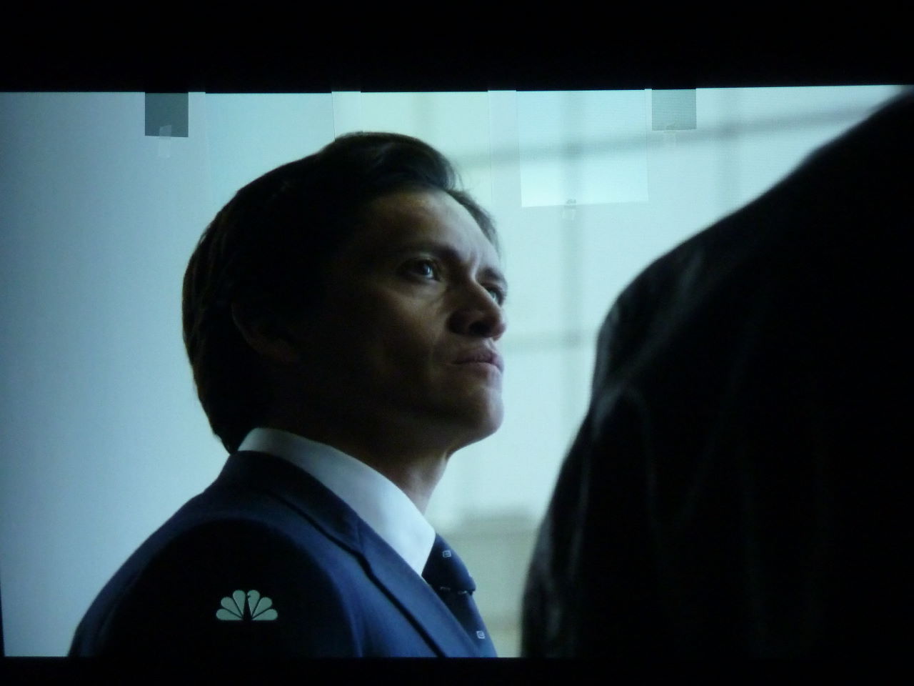

I took some pics and I guess I need some work with this camera. It can give you kind of an idea. The two small grey samples are Sintra and the big samples are from left to right Gatorplast, Sintra, and Dibond.
I didn't think about an envelope, but I don't want them to get damaged in shipping.

Wow! That one sample, Dibond I believe, seems to hot spot pretty badly.
Posted: Fri Oct 29, 2010 6:52 pm    Post subject:
Yeah, it does. If they could make it in matte, then it would be the perfect substrate.

I looked at these some more the other day and every sample except for Dibond showed an image on the back side. The Gatorfoam with a black core also didn't leak, but I am not sure if there is any issue with using the black core. I put each sample about one foot away from the lens for my test.
