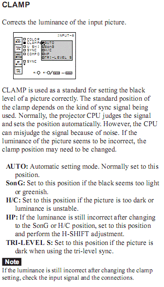

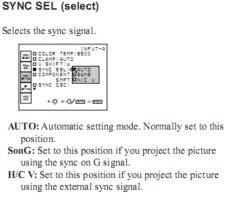

OK, I set the clamp to H/C; we'll see what that does.
I'll check the manual.

After you look at pages 48-49, go into the menu and set everything to HC that can be and HV that can be.

Done - though there wasn't anything I could set to HV. Just clamp to HC.

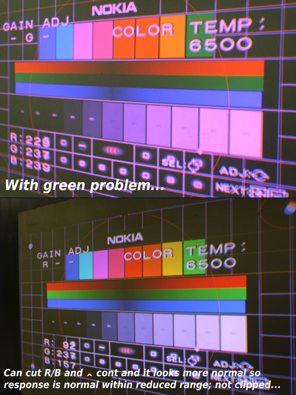

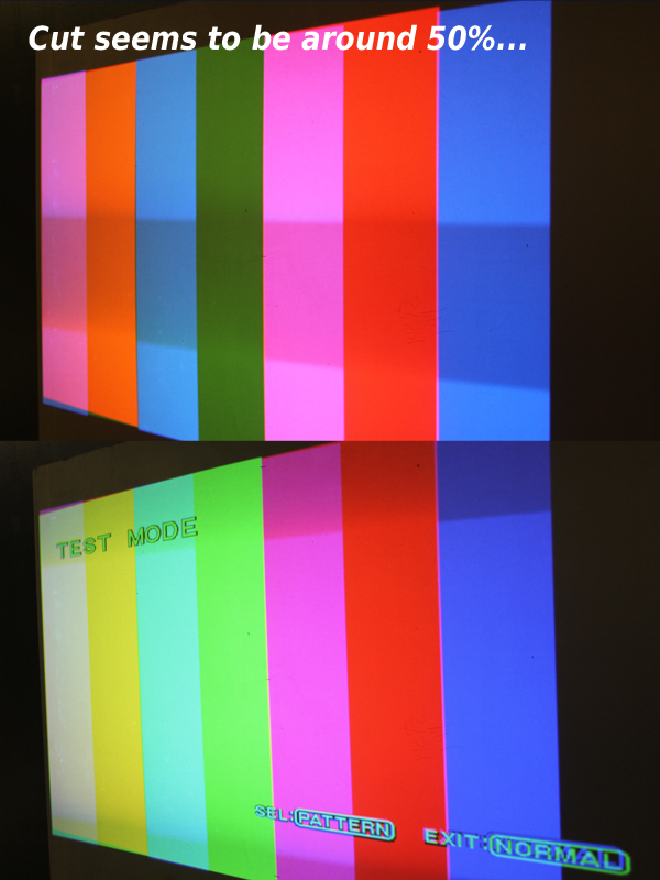

OK, so, I had it run for a while and got it to do "the thing". It took a while, and it did "the thing" for maybe 4 or 5 minutes. I got some pictures.
It was exciting.
Any ideas? It just kinda snaps back to normal like nothing ever happened. I've tried to have it sit there on a test pattern with no input, but it seems to drop back to a screensaver mode, so short of sitting there for an hour poking it every five minutes, I'm not sure how to check more.
Posted: Fri Sep 17, 2010 8:42 pm    Post subject:
OK, update: I had it sitting there with no input and color bars and for some reason it stayed there... it did the same thing. Neutral Dropped green mostly for a few minutes and then came back on its own.
So, seems like it's gotta be an internal problem. Sad Ideas?

Hmm... So, just green is cutting output by 50% or so... I'll have to let Curt or Craig chime in on this one.
You just moved the machine... Have you double-checked and/or reseated all the cards?

Well, my first guesses would be a neck card, bad connection to the neck card (check all wires and reset neck card on tube), tube, or BNC connector between the C and B board.
