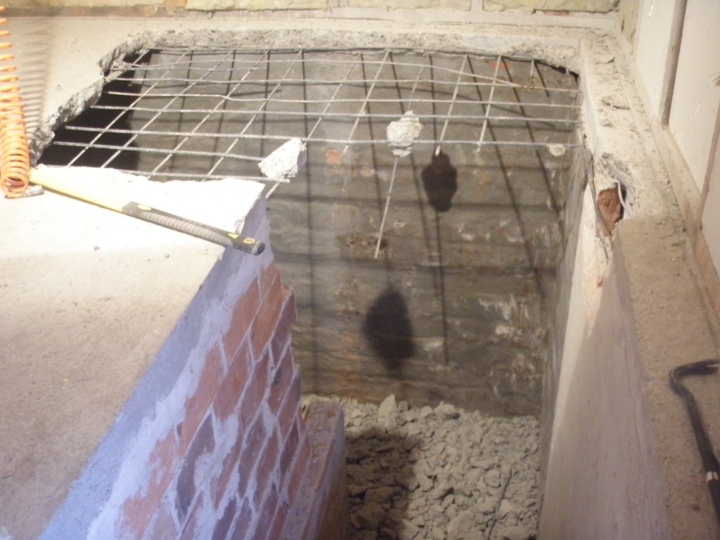

Been busy with snow lately, but have got also something ready at theater room. Installed sheetrocks to ceiling and started to chisel old cellar ceiling. 4" concrete isn't actually so hard to brake just with sledge hammer that I thought. Picture is taken after about one hour beating. Very Happy

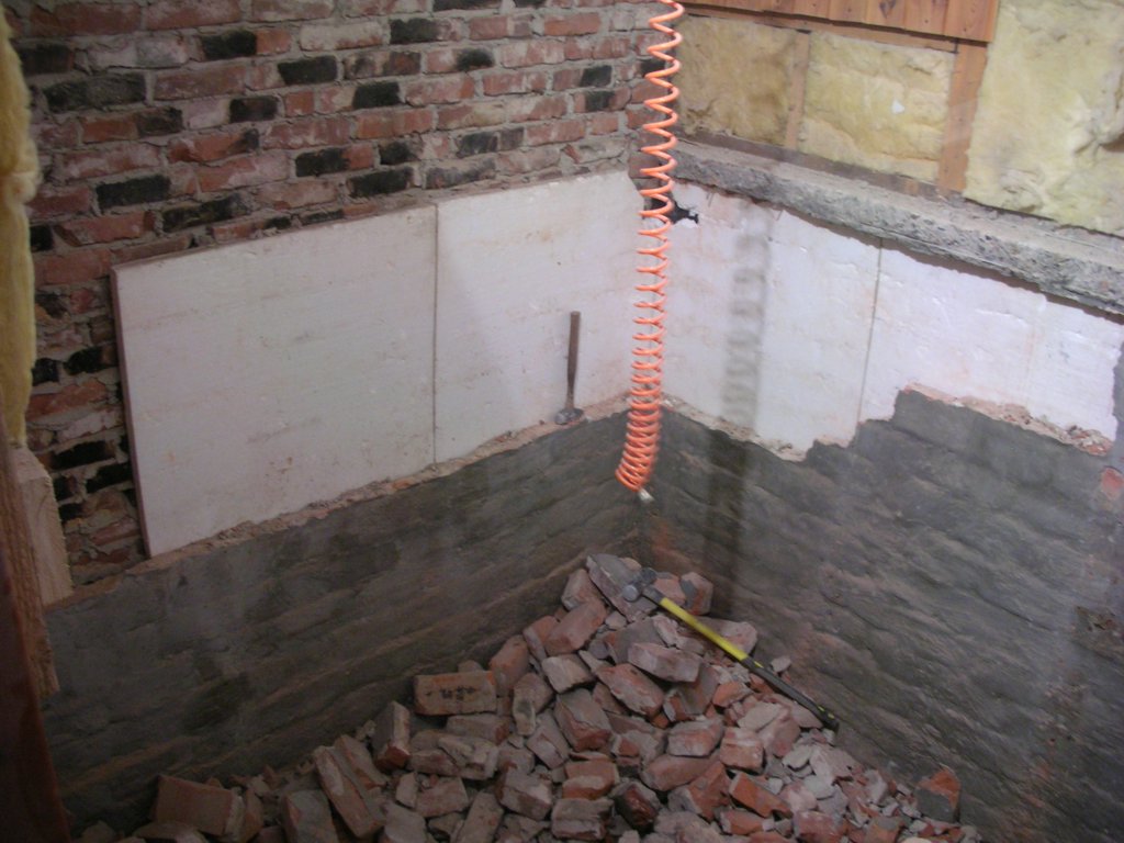

Got cellar ceiling removed and started to lower cellar inner masonry to below new floor level.
Bad news is that two outer walls have also concrete wall between inner masonry and outer masonry. I need to get also that lowered to new floor level, it could be problematic without destroying outer masonry. I guess I need to rent concrete saw for that.

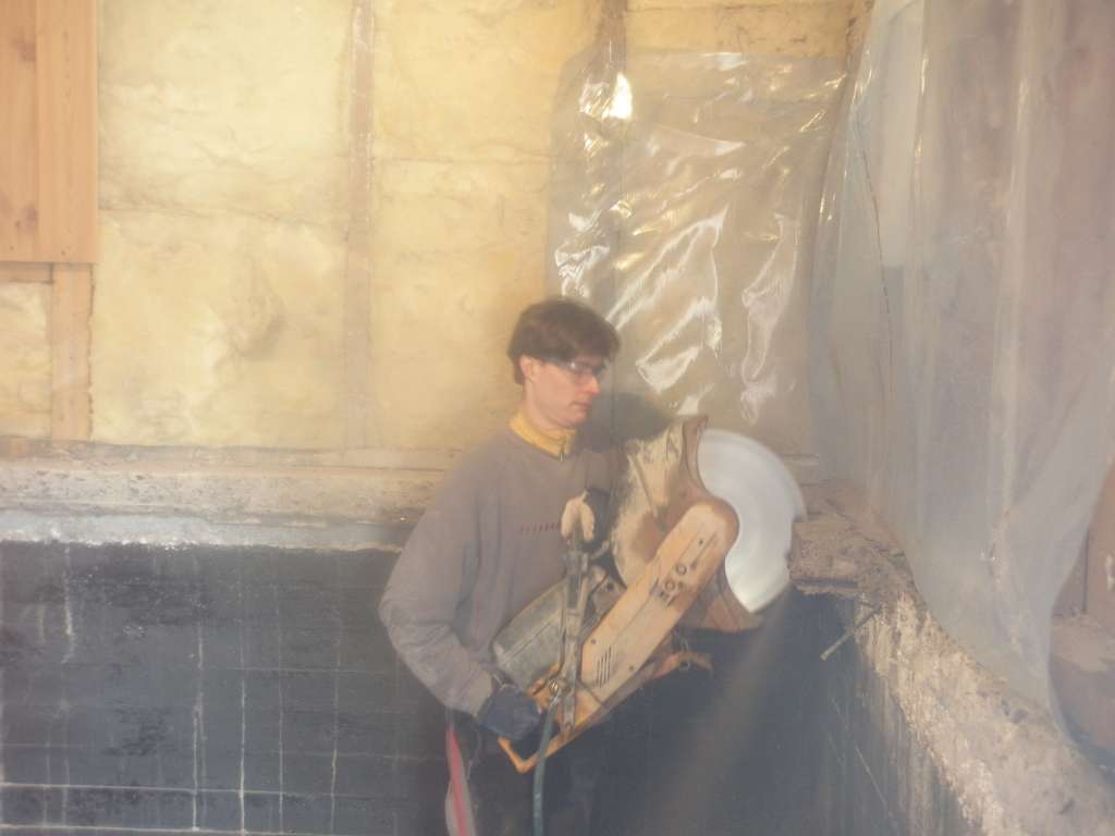

Little cut off sawing today.
That was mother of all power tools, want my own K960 with 16" diamond blade! Laughing

Sweet! Hopefully you had hearing protection in...or you will be only watching movies in the new thater and not listening to them. Laughing

Posted: Sun Mar 06, 2011 11:25 am    Post subject:
Sure, I used earplugs all day.
Also used full-faced fresh air respirator, because of saw exhaust gases. There is that orange spiral hanging from ceiling in some of my previous pictures, that is for breathing air from compressor through filters.
There was no concrete dust because saw have water connection.

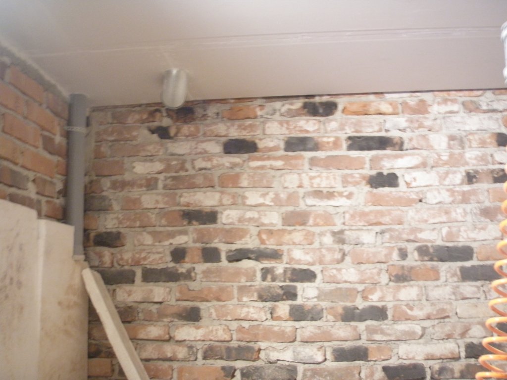

I beat brick wall down between garage and storage room and installed new ventilation pipes for remaining cellar.
Next I should bear all those bricks and concrete blocks from cellar to somewhere. There's few cubic meters of that crap. Thumbs Down
