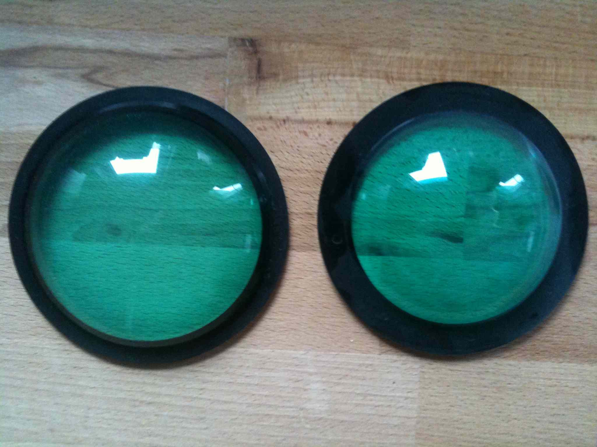

Posted: Thu Oct 07, 2010 8:18 am    Post subject:
This should be the ultra-rare 8 inch green c-element for Barco on the right.
 Filename:  c-elements-green.jpg
 Filesize:  141.24 KB
 Downloaded:  476 Time(s)

Posted: Thu Oct 07, 2010 8:22 am    Post subject:
difference 8 inch green G70 vs. Barco
 Filename:  difference_8inch_green.jpg
 Filesize:  209.27 KB
 Downloaded:  484 Time(s)

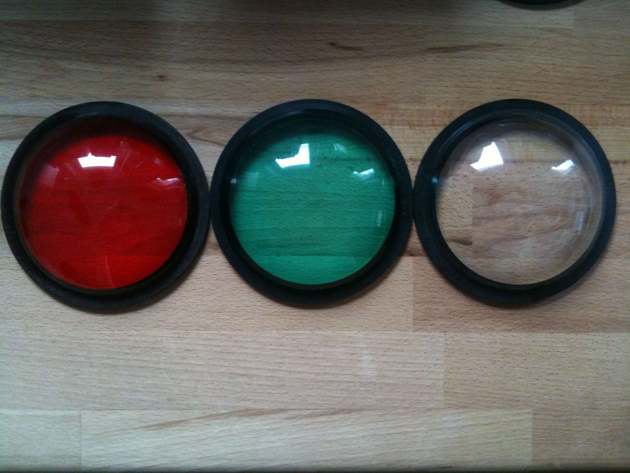

Posted: Thu Oct 07, 2010 11:48 am    Post subject:
So red Barco C-element don't exist?
Domenico (Barco fan!)
Decibel
Joined: 31 May 2007
Posts: 904
Location: Roma - Italia
Posted: Thu Oct 07, 2010 4:47 pm    Post subject:
The clear c-elements that I have are similar at standard G70 type. Neutral

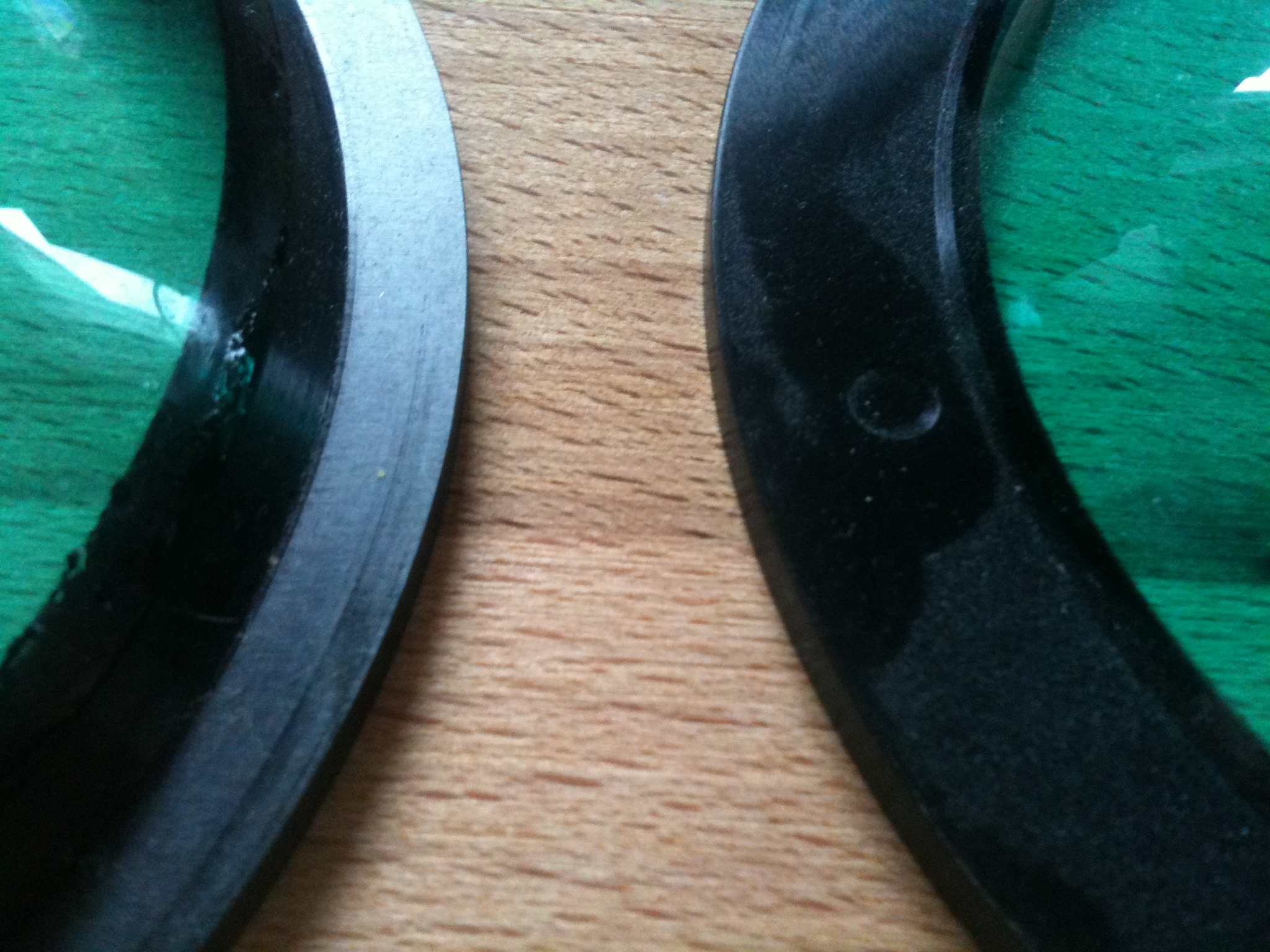

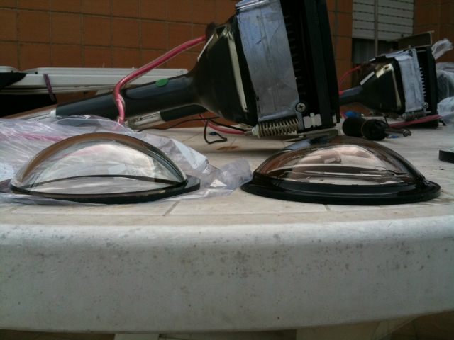

Difference between Barco clear and G70 clear (Barco on the left)
 Filesize:  207.72 KB
 Viewed:  8317 Time(s)

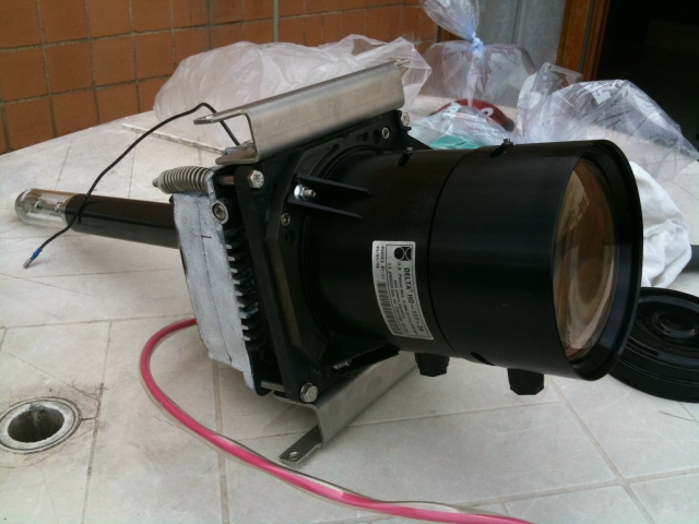

Posted: Sun Oct 10, 2010 2:52 pm    Post subject:
Tube+Barco orginal front plate+HD117-24 Thumbs Up
 Filesize:  207.61 KB
 Viewed:  8315 Time(s)
