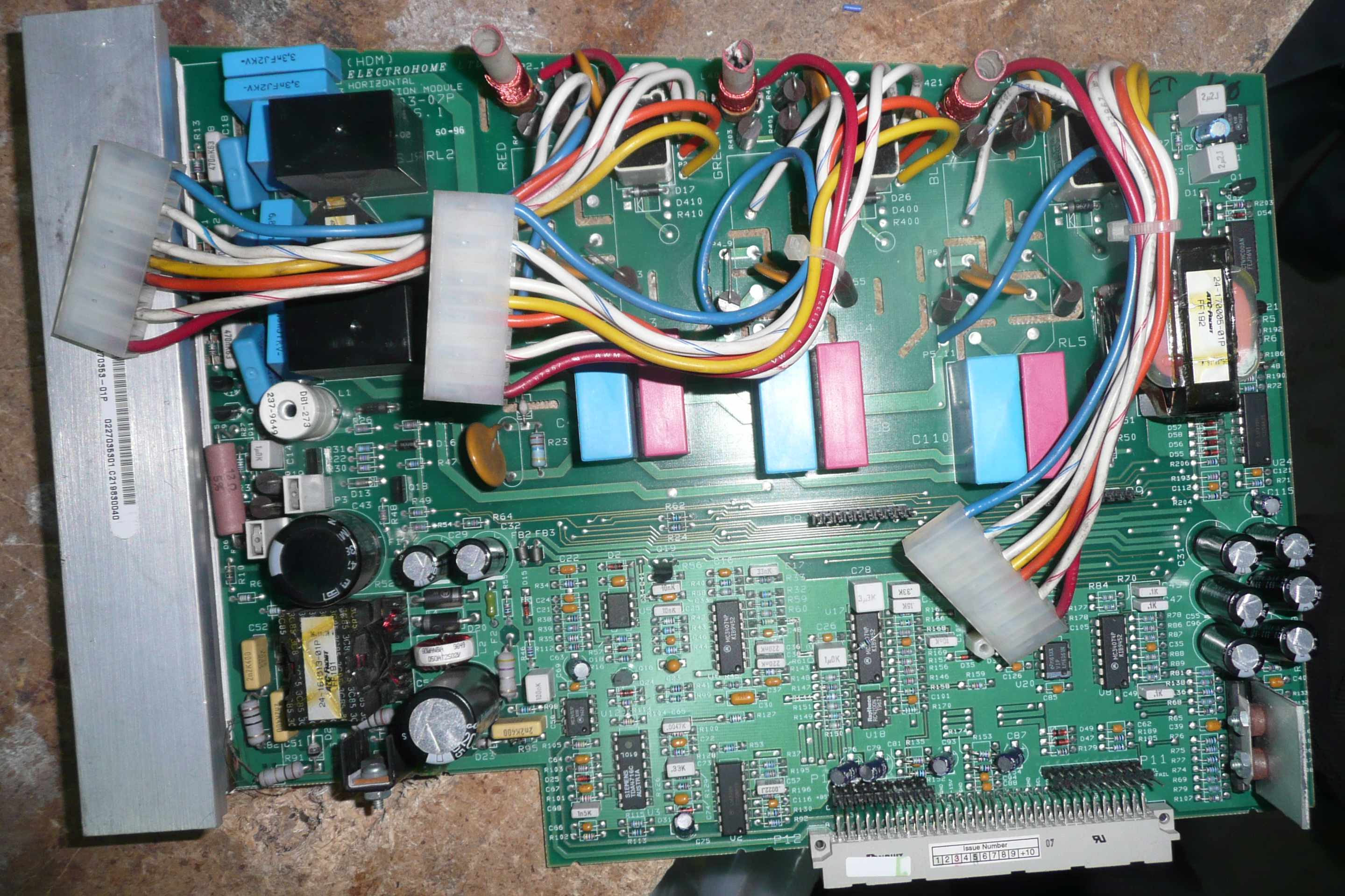

Hi Everybody,
I just got a few parts from Ebay (IR sensor, HV splitter, LVPS, CONV amp, V amp, FOCUS and HDM) and on the HDM I saw that some width coils were taken off but also the relays that switch them. The guy where i bought them from seems to be reliable (he had an ultra that he sold and this where his spare parts that he never needed)
I've read this thread off course but before blowing up my projector I would like to know if I could try this with confidence in my own projector. It was not clear to me if I could use this board without the relays.
Could anybody shine a light on this?

Posted: Wed May 23, 2012 7:33 pm    Post subject:
If relays and width coils have been removed, this HDM might only work with specific resolutions (= specific Horizontal deflection frequency) or not at all. For each color there are two adjustable coils. One is for low resolutions (H-frequency below ~35kHz) and the other set is for any resolution above. Three relays switch the coils and two other ones switch parts of the deflection circuit (especially the three MOSFETs on the heat sink) in order to compensate for the deflection yoke's frequency dependent current draw.
I wouldn't use such an HDM without knowing exactly what this modification was intended for and which restrictions I'd had to follow when using it.
Post a picture of it here if possible. We might be able to find out which remaining frequency range has been left usable...

Posted: Wed May 23, 2012 8:24 pm    Post subject:

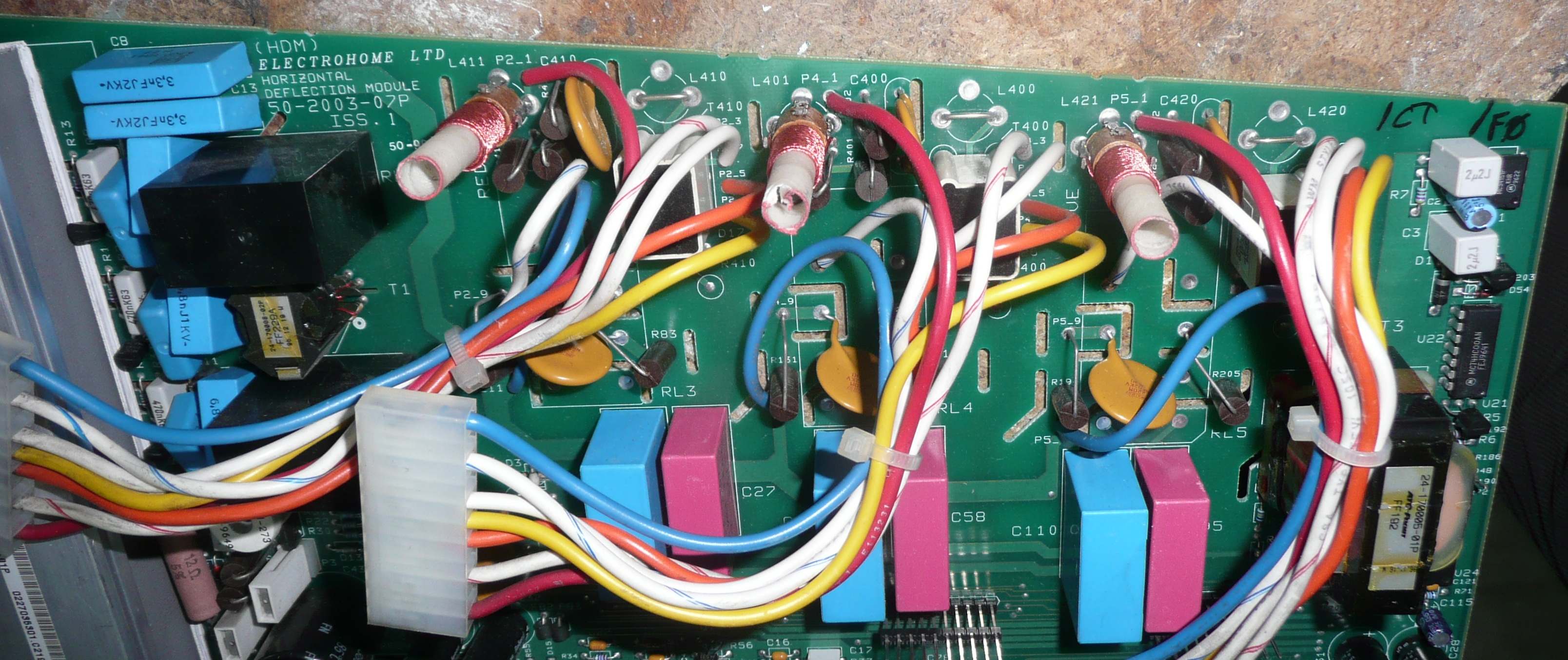

Hi again,
I'll try to post a picture when I'm home from work. It's only the 3 relays for the width coils that are taken out as far as i could see.
I've attached a screenshot of the picture from Ebay but it's not very clear but i think you can see which coils have been removed.
I think myself that it has been modified for High scan rate (1080P etc)
two better pics added
regards,
Ron.

barclay66
Joined: 27 Jun 2011
Posts: 1304
Posted: Wed May 23, 2012 11:03 pm    Post subject:
The coils have been taken out and have been replaced with jumpers. That's the same as adjusting them to maximum width. Seems as if the previous owner tried to get maximum width at high scan rates (which mysteriously alignes to this thread's title!). Take a look at this pic: http://www.etechvideo.com/images/Tip9/Tip9_19.jpg
It still has to be verified which relay setting has been left. Are there any jumpers where the relays used to be?
BTW: The Horizontal Daughter Board is missing. Without it You won't be able to use the HDM anyway!

Posted: Thu May 24, 2012 10:02 am    Post subject:
Thanks barclay
I'll take the daughterboard from my other HDM when i'll try this one.
by the way there are no jumpers where the relays should be. There are just the resistor and capacitor that are normally there when the relays are in.
My other HDM has the problem that it can not give max width when working at 50 Hz refresh rate. (at an H size of 35% it stops increasing in width) This should not happen and should not be related to porch settings
regards,
Ron.
