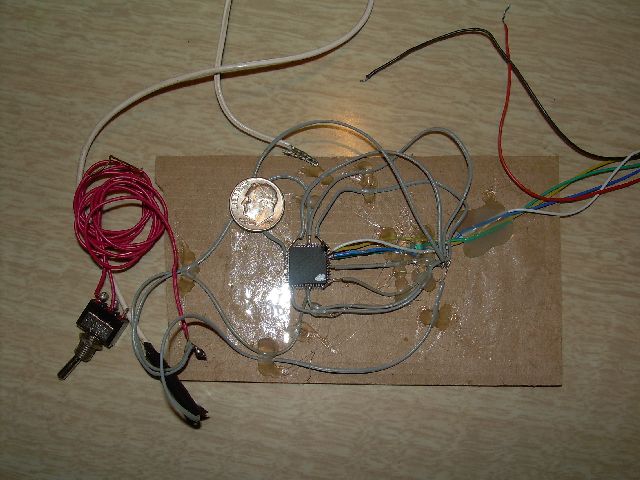

Craig, this is where I left off with the ic you sent me. I haven't attempted a read yet which is where I will be picking back up. Still dont know if it will read or not. I have almost always been able to get a read on the 100's of various other chips I've tried on but I must admit I'm not real confident on this one. Hopefully in a couple more weeks I can get back to it.
 Filesize:  95.86 KB
 Viewed:  5959 Time(s)
Trouble still remains even if you get a read of that defective chip... cause it will be hard to convince someone with a good IC421 to let us take it off the board just to do a read on it and then put it back. Lots can go wrong with all those tiny little pins during removal and installation.
But then again, the software might not be what's bad on the IC, it could be the hardware. But my guess is a software issue in the write once memory. And that beings said calling the software software is a little strange when it is hard written.

The chip would not have to be removed from the board to do a read or write if a either is possible. I did this one like this because the chip was already off.
I'm also not convinced this chip is a OTP (one time programmable). JTAG chips usually are not.
