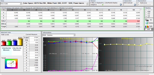

Yesterday at night I played with my new EyeOne Display 2 and projector.
Setup - projector is placed 4.5 meters from the wall and projects image ~ 3.6 meters diagonal (pretty big).
Room is dark (at night) but with bright walls and ceiling.
Projection is done on white-painted wall.
I used CalMAN free generator as image source.
I calibrated several projector modes, but the problem is the same and the curves look pretty similar, so let's focus on the one mode - Color1 (apparently calibrated by Panasonic to THX standard), and only on greyscale calibration (I'll try its CMS tonight).
Even before calibration things were pretty good (deltaE was around 10), using configuration suggested by some reviewers gave slightly better results (deltaE ~ 9).
After calibration I got the following (first line X, second y, third Y, fourth deltaE):
0.305043 0.308653 0.313421 0.312700 0.312530 0.313309 0.314053 0.313791 0.313028 0.311424 0.312632
0.332846 0.328357 0.331183 0.330146 0.328860 0.329495 0.331203 0.330294 0.329226 0.329594 0.332641
0.807606 1.586590 2.714053 4.089776 5.777388 7.796586 10.337400 12.739144 15.485907 18.626299 21.956169
8.8 3.6 1.7 1.0 0.2 0.5 1.8 1.2 0.3 1.5 3.1
Subjectively image looks slightly better if I compare old and new settings side by side.
So far so good.
But gamma is completely off - average 1.56 - it was so before calibration and almost didn't change after that.
Luminosity is around 6.4 ftL (Y=~22), pretty low, I know - but movies look alright and overall it doesn't give "too dark image" feeling. Also remember - I watch movies (and did calibration) in total darkness.
Luminance curve looks strange - it is over the reference, like I get too much output.
I tried to play with gamma controls but before going blind I'd like to get some advice:
I have simple gamma control and complex one.
Simple are just 3 sliders - allowing to tweak gamma low/mid/high channels. Complex method is 4 curves (R/G/B/Y) with 10 points each, that can be modified from their initial "straight line" position.
So - should I try to low everything (according to luminance curve) or raise everything (according to gamma curve) ?
Or I should give up and those low gamma values are due to wall (versus screen) and reflections - and to improve that I should redo my room ?
And - which parts of the image I miss by watching it on such low gamma - details on bright, mid, dark, overall contrast ?
Any help will be very appreciated.

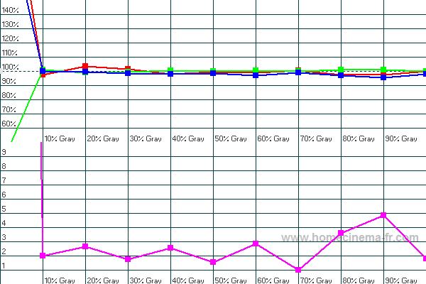

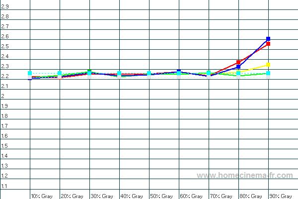

Posted: Wed Sep 29, 2010 12:29 pm    Post subject: Results
I repeated the whole calibration process using my player program and calibration disk from http://www.avsforum.com/avs-vb/showthread.php?t=948496 - "Patched" version. Can't understand the difference between all variations they have there ... I didn't burn it to DVD, just mounted .iso file on the file server and played it over the network - shouldn't matter for calibration purposes, I think.
Can't get menus to work, probably player problem, so I just played stream files (stream #11, if I remember correctly).
I proceeded as follows - first, set everything to "default", then made first measurement just to know where I am. deltaE was around 7-8, Gamma - 1.84.
Then I repeatedly played with Advanced Gamma curves (Y), to make gamma curve on HCFR as close as possible to 2.2
After several passes I got it pretty straight over all IREs. Then I took a look on RGB levels, and they were way off (just like they were before the calibration, may be even worse). Using the iterative technique from the guide I adjusted colors to give small (< 3) deltaE.
Obviously it messed up gamma again. So now I left gamma Y curve as is, and started to fix individual colors using color gamma curves. Stopped when I realized it is 2:30 am here, and I have better things to do - so 80/90 IRE are in rare (as opposite to "well done" conditions). Before they were "steak tartar".
Results - gamma 2.26, deltaE < 3 except 80/90 IRE where it is 3.6 and 4.9 respectively.
I watched several scenes in recently viewed movies and played with settings on the projector - comparing new and old versions. Difference is very subtle but clearly seen. Interesting theoretical question is why gamma has to be tweaked at all - due to projection surface imperfections, projector design / manufacturing defects, or something else.
I'll fix 80/90 IRE next time I have time, for now it looks good enough.

Hello
Old thread but needs some advice.
owning an AE4000 1000h on lamp, diplomat reAct 2.2 screen
calibrating using HFCR an i1diplay pro, and patterns from AVSHD on BR-player
Started with a fresh cinema 1, Lamp ECO
did basic brightness and contrast from disc, ended upp contrast +10, Brightness -2
The after initial greyscale, gamma average low about 1.6
blue high and red low
Started doing several runs back an fourth on 9point gamma ,coreccting only Y
Then after that several rauns finetuning RGB in the same 9point gamma changing B and R
Ended upp like this in HFCR, knowing it is hard above 80% it seem fairly good
Text Number Font Screenshot Software
But looking at a greyscale pattern after that, from AVSHD is clearly blowing some areas
Shadow
 Filesize:  56.62 KB
 Viewed:  50 Time(s)
Hcfr calibrated gamma and rgb using 9point gamma in pt
 Filesize:  148 KB
 Viewed:  50 Time(s)
Posted: Mon Mar 10, 2025 1:20 pm    Post subject:
Where do you see that? Your last screen show shows gamma tracking around 2.2 across the board, though to be honest it's been more than 15 years since I've used HCFR so maybe I'm not reading it correctly (?)
