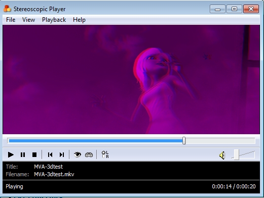

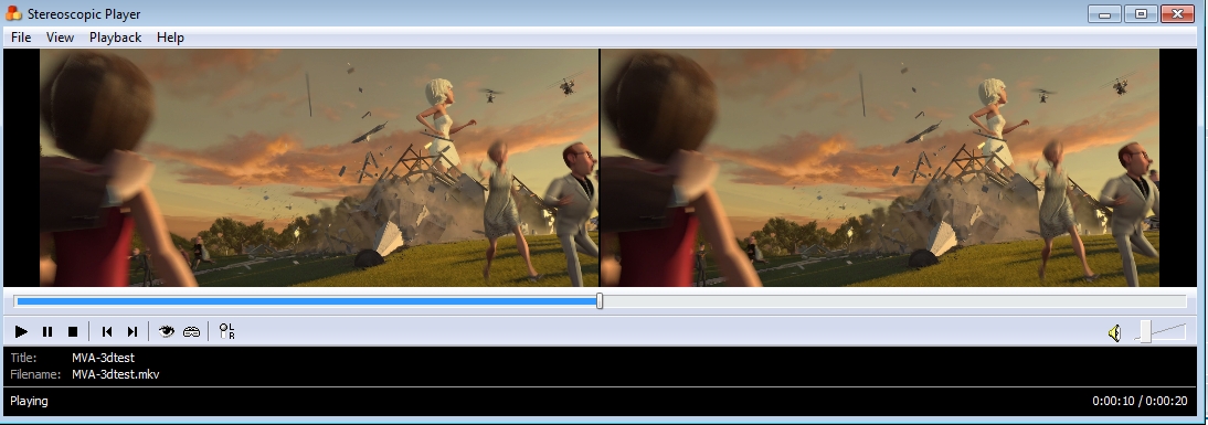

The format is already known.
The disc has Left image data, and Right-difference data.
It can be converted to side by side data (one huge frame), which Stereoscopic Player can play back in a multitude of different formats (dual screens, Nvidia...even coloured glasses).
I don't see the big mystery.
But I'm very skeptical the result will be something we want to watch.

I'm not concerned with the "format" or how it's stored on the disc, Mark. Unless you're a developer writing software, who cares? For those of us with zero interest in in an HTPC and all that entails, some of us want to know what the signal looks like AFTER it's in the video stream coming out of the HDMI port of a set-top BD player. What can you do with it? What will those players do when connected to a display that isn't a new HDMI 1.4-based HDMI display? THAT's the big mystery. Until we know that, we have no idea how - or if - 3D will work on a CRT (or what will be require to make it work) without going the HTPC route.
Yep. That was also my point.
