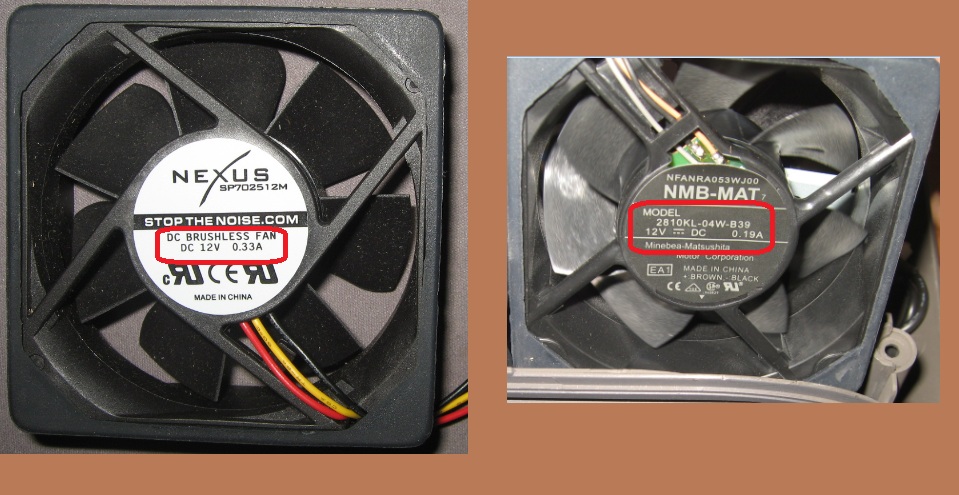

This Marantz VP4001 has three fans. They all look the same and all three are 12V .19A. Though the 3rd is rated for
slightly higher CFM than the others.
The goal was to replace two with NEXUS fans rated for the same CFM, but lower db. I did install swap out those two fans
and the projector started up fine. But after just a minute, it shuts down.
So far, I have managed to have just one fan swapped out for over a year now without any problems. But I'd like to
revisit this issue.
What would make the projector shut down, with just a simple fan swap? Maybe it doesn't like the higher amp rating of the
new fans? If so, what value resistor would I need to lower it from .33 to .19?
New fan on the left, original on the right.

You put the resistor in series with one of the leads of the fan. Keep in mind though that some fans have internal circuitry so as you lower the voltage, the fan will either work or come to a dead stop, and won't change speeds as you lower the voltage on the fan. Also make sure that the fan starts at the lower voltage if it does work for you.
I'd put say a 500 ohm or 1K 2 watt wirewound pot in series with the lead so you can tweak the fan's voltage. Once you know what setting works, measure it and buy the closet fixed resistor value.

If you have the RS pack of resistors, I'd first try something around 10 ohms on the + side of the fan in series. If that works, you could try a 15 ohm or even a 20 ohm resistor.
Be sure to take temperature readings before and after you slow down the fans.

CZ, it might be something else besides the fans causing it to shut down. I know you say its only with a fan swap but maybe something else?
However the resistance of each motor you show is About 36 ohms for one and about 63 ohms for the other if using ohms law where Ohms=Voltage/Amperes .

Alright, here's the deal. The original fan is marked 12v, .19 amp. That means that the fan needs at least .19 amps to run. You can send it .2, .3, .5, 1.0, 5.0, 10 or whatever amps, but it needs at least .19 amps. Now the fan you want to replace it with needs at least .33 amps, almost double the original. Now if when you install this fan the projector shuts down then that means its drawing more amps then the power supply has left after that circuit supplies everything else in the projector on that line.
So, the power supply of that circuit does not have enough power to run the higher drawing fans. And no resistors or pots or what ever is going to make that power supply put out more amps.
And adding resistors to reduce the voltage is going to cause the fan to draw even more amps then at the rated voltage.
This is also why when you try running 2 fans it shuts off even faster.
The only way to run those fans in there is to maybe pull power from a different circuit but you may run into the same problem again. The supply must not have much reserve left over and that is by design.

Adding resistors doesn't reduce the voltage. The supply is still putting out 12V. It will, however, reduce the voltage across the fan, due to the resistive divider. In this case, to 6.8V, with a 27 ohm, 1W resistor. Which it may or may not be able to start at. That's a separate issue, and a separate spec on a specific fan.
The key point though is that inserting a resistor in series with the motor windings INCREASES the series resistance of the circuit, and REDUCES the current draw (from 330 mA to 190 mA), which is what the OP asked about. It's not going to "draw even more amps". Resistance and current are in an inverse relationship.

Oh, and the most important point of all is if when replacing a 2.4W fan with a 4W fan (greater load), by reducing its voltage from 12V to less than 7V (and thus dropping its RPM output), will the CFM of air it then moves still be adequate to cool that part of your PJ effectively?
