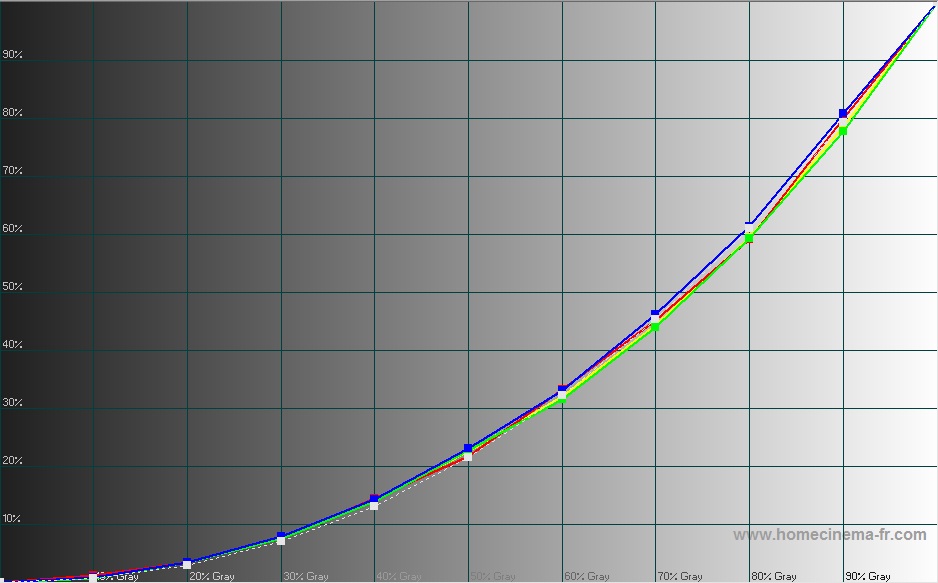

It works now with HCFR. I've tested it with my plasma display on which i'm using calibrated settings from someone with an I1Display2. The greyscale it captures looks not very bad i think:
But i have the chance to get the I1DISPLAY2 instead of the Spyder3, so you think it's better to use the I1?

Posted: Sun Aug 15, 2010 6:19 pm    Post subject:
They are both Tri Stimulus meters that have filters. the filters degrade and change color or tint over time . its be best to find someone with an i1 Pro spectrometer to profile the Spyder to. save that file and every so often make another profile when you can get a hold of the i1 Pro again.
